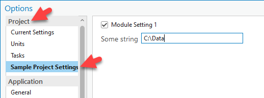

In the first part of this guide, we will add a property page to the Pro Options, Project settings "property sheet". On our property page we will provide two custom settings:
  1. A true/false flag value which can be toggled via a checkbox
  2. A custom string which can be edited via a textbox.
These settings will be saved with each project and restored whenever a project that contains them is opened.

The caption of our page is "Sample Project Settings". This is the caption that will appear in the list of Project property pages.
ProjectSettings2

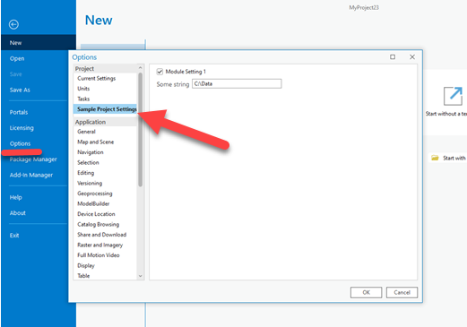

Step 8: Build The Add-in and Test the Settings
Build the add-in project and launch the debugger. ArcGIS Pro will launch. Open any project and test the new Project settings. Go to the backstage. Click on the Options button. You should see your custom property page in the list of Project pages.
  • Click on the "Sample Project Settings" entry in the Project options. Change the values on the page
  • Click ok. Reopen the page. They should be persisted.
  • Close the project. You should be prompted to save.
If you save the project, check that when you re-open it, your persisted values are shown in the "Sample Project Settings" page.

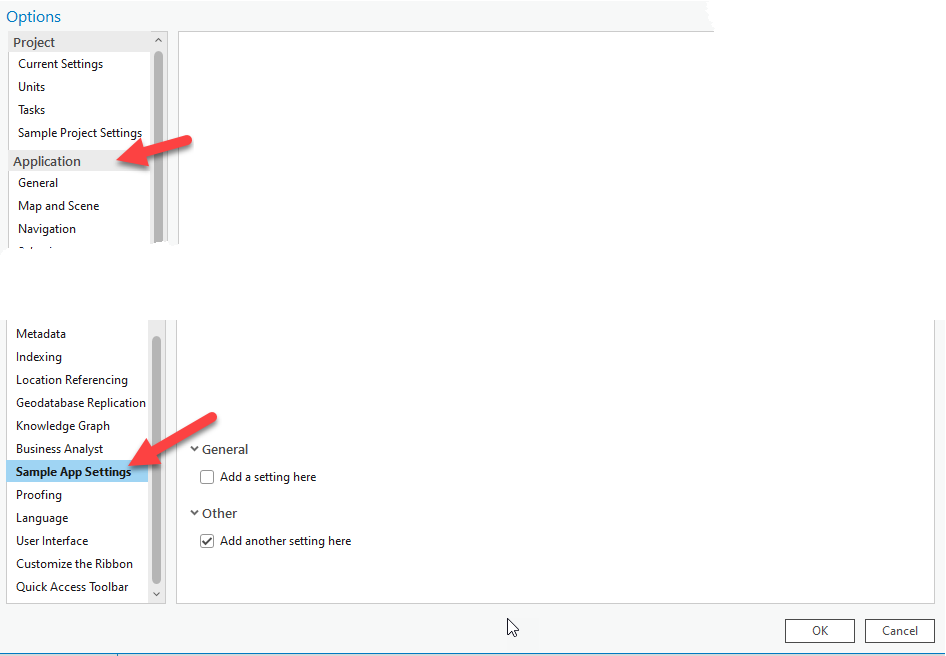

Step 3: Define and declare the new property sheet in the addin’s Config.daml
We want the new property page to appear in Pro’s Options dialog under the “Application” section. Repeat the process you followed in Step 5: Add the Property Page to the Project Options in the Config.daml above.
Set the group attribute of the page element to group="Application"
  <propertySheets>
    <updateSheet refID="esri_core_optionsPropertySheet">
      <insertPage id="esri_sdk_PropertyPageAppSettings" caption="Sample App Settings" className="ApplicationSettingsViewModel" group="Application">
        <content className="ApplicationSettingsView" />
      </insertPage>
</updateSheet>
  </propertySheets>
ApplicationSettings
(You may have to scroll the Application options to see your custom entry)

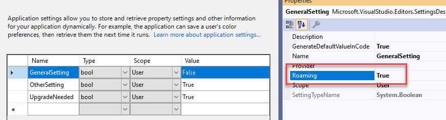

Step 4: Add a Settings.settings file (or "Settings1.settings" which is the default) to define the user preferences to ArcGIS Pro's user.config file
The settings defined in the the ApplicationSettings and ApplicationSettingsViewModel will be configured in the add-in project's Settings1.settings file. The .NET Framework allows you to store Application settings dynamically via a user.config file in the current user's "AppData" location (Managing Application Settings (.NET))
Any Application settings user.config file stored in the AppData location for ArcGISPro.exe will be read, at startup, by Application .NET property settings classes. For Pro, this location would be similar to C:\Users\[UserName]\AppData\Roaming\ESRI\ArcGISPro_StrongName_yhpsrysqpn4fvmb0spwbakt5o5e50din\[Version]. Your add-in's Settings.Settings class (or Settings1.Settings if you used the default name) will be initialized when the Add-in is initialized.
  • Add a new item to the project of type "Settings".
  • Enter the new custom application settings defined in the ApplicationSettings and ApplicationSettingViewModel into the Settings files as follows:
Settings
  • ArcGIS Pro stores all settings in the user.config file located in the "Roaming" folder in AppData (In earlier versions - pre 2.6 - the user.config file was located in the "Local" folder in the AppData). To use the Roaming folder to store your custom application settings, make sure the "Roaming" attribute of each of your settings properties is set to true (the "Scope" remains as 'User'): Roaming
Visual studio will automatically generate a Settings class for you, with those properties, that derives from System.Configuration.ApplicationSettingsBase.

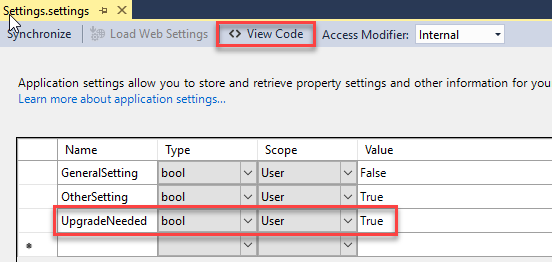

  • In Visual Studio, open the Settings file in Designer mode.
  • Add an additional property of type "bool" called UpgradeNeeded. Set its default value to True. Be sure to set its Roaming property to True also.
  • Click the "View Code" button. ViewCode
  • A Settings.cs class file (or Settings1.cs depending on the name of your settings) is created. In the class constructor, add this code snippet:
if (UpgradeNeeded)
       UpgradeNeeded = false;
       Save();
       Upgrade();
The completed constructor should look similar to:
