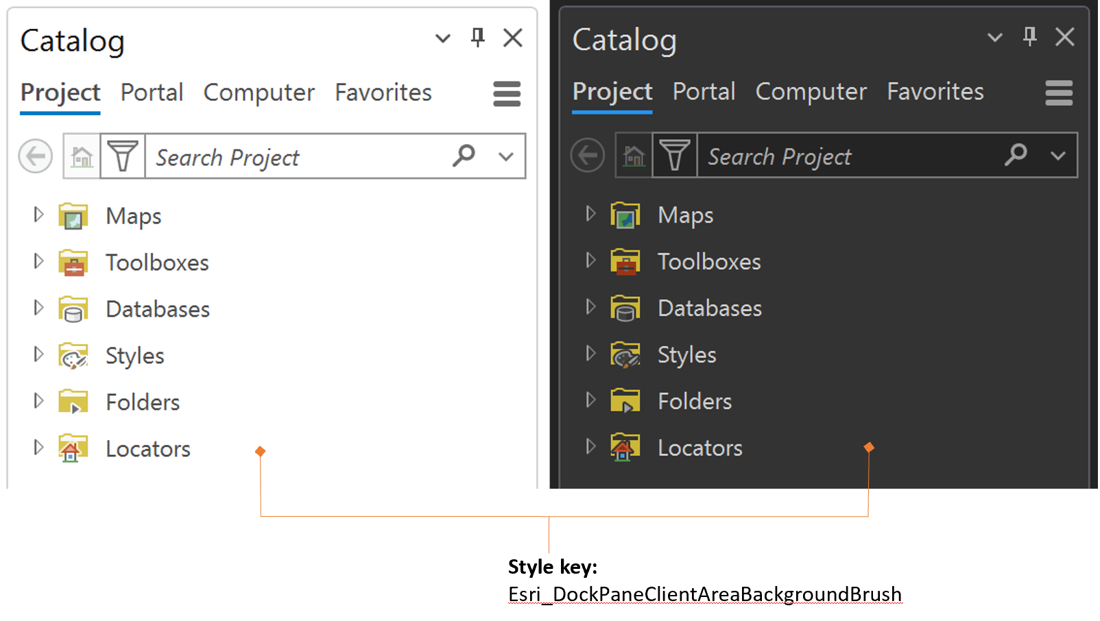

Avoid setting a background brush for a User Control. User controls will automatically inherit the correct background brush for Light and Dark themes. If you do have to set the background, use one of these Esri brushes.
To style UI elements within the user control, refer to the TextBlocks, Brushes, buttons, etc., sections in this wiki.

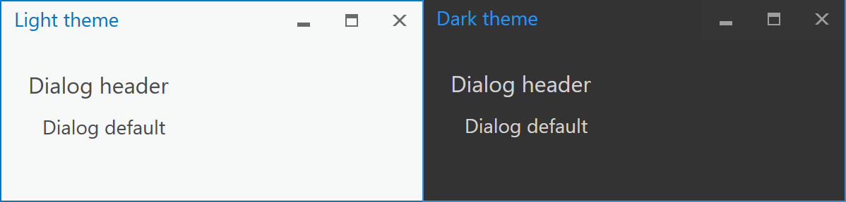

Windows
Default Style: Yes
Custom windows within add-ins should derive from ArcGIS.Desktop.Framework.Controls.ProWindow to inherit a correctly styled Title Bar and background (by default, in Visual Studio a custom window will be derived from System.Windows.Window). If you do have to set the window background, use one of these Esri brushes.
Note that in the example code below the System.Windows.Window has been changed to a ArcGIS.Desktop.Framework.Controls.ProWindow:
<controls:ProWindow x:Class="Geocode.GeocodeWindow"
xmlns:controls="clr-namespace:ArcGIS.Desktop.Framework.Controls;assembly=ArcGIS.Desktop.Framework"
Height="150" Width="420" Title="Geocode">

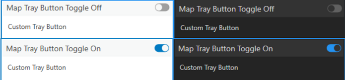

Toggle button
Default Style: No
Available Styles:
| Style name | Toggle Button |
| Esri_ButtonToggle | Simple toggle button |
| Esri_ToggleButtonTrayButton | Map and Layout tray toggle button |
Toggle buttons have no default style. You have to apply one of the available Esri styles listed above to a toggle buton element.
Do not specify attributes such as Foreground, Background, unless you want to override the Esri styles.
- Simple toggle button
<Button Style="{DynamicResource Esri_ButtonToggle}">
Button
</Button>
- Map and Layout tray toggle button
<Button Style="{DynamicResource Esri_ToggleButtonTrayButton}">
Button
</Button>

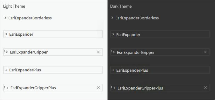

Expanders
Default Style: No
Available Styles:
| Style name | Expander |
| Esri_ExpanderBorderless | Expander without a border |
| Esri_Expander | Expander with a border |
| Esri_ExpanderGripper | Expander with a gripper |
| Esri_ExpanderPlus | Expander with a plus button |
| Esri_ExpanderGripperPlus | Expander with plus button and gripper |
Expanders
- Expander without a border
<Expander Style="{DynamicResource Esri_ExpanderBorderless}">
</Expander>
- Expander with a border
<Expander Style="{DynamicResource Esri_Expander}">
</Expander>
- Expander with a gripper
<Expander Style="{DynamicResource Esri_ExpanderGripper}">
</Expander>
- Expander with a plus button
<Expander Style="{DynamicResource Esri_ExpanderPlus}">
</Expander>
- Expander with plus button and gripper
<Expander Style="{DynamicResource Esri_ExpanderGripperPlus}">
</Expander>

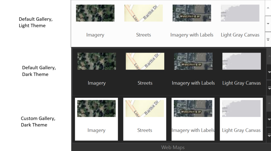

Galleries
Default Style: Yes
Available styles: Esri_GalleryItemBackgroundBrush, Esri_TextGalleryItemBrush
| Style name | Gallery |
| Esri_GalleryItemBackgroundBrush | Background brush of the gallery item |
| Esri_TextGalleryItemBrush | Foreground brush of the gallery item text |
Default background and text styling for gallery items
By default, each item in a gallery has a transparent background in the light theme and a dark background in the dark theme in Pro.
Custom background and text styling for gallery items
In some cases, your gallery items will not display clearly in the Dark theme because the items are also dark. You can use the custom Esri Gallery styling in these cases. For example, in ArcGIS Pro the North Arrow gallery for Layouts displays all the items with a white background. If you need a white background for each item in a gallery in dark theme, you can style these items using the following Esri styles:
Changes the background brush of the gallery item to 'Esri_ControlBackgroundBrush' (white) in Dark and High Contrast Mode. In the light theme it is transparent.
Changes the foreground brush of the text to a dark gray in light and Dark theme. System color is used in High Contrast mode.
<DataTemplate x:Key="InlineGalleryItemTemplate">
<Grid Background="{DynamicResource Esri_GalleryItemBackgroundBrush}" ..>
<Grid.RowDefinitions>
</Grid.RowDefinitions>
<TextBlock Foreground="{DynamicResource Esri_TextGalleryItemBrush}" .../>
</Grid>
</DataTemplate>

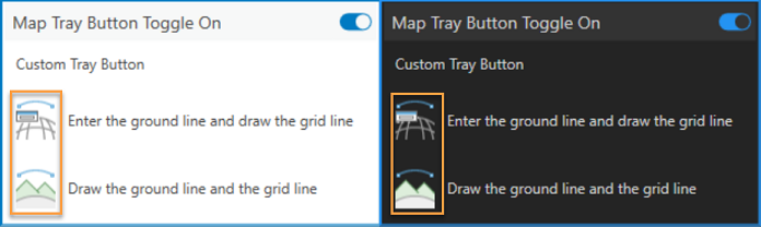

Default Style: No
Use this Image style for images displayed on a Tray button UI.
<Image Source="pack://application:,,,/AddInName;component/Images/TrayButtonImage32.png"
Style="{DynamicResource Esri_ImageTrayButton}" Height="32" Width="32"></Image>

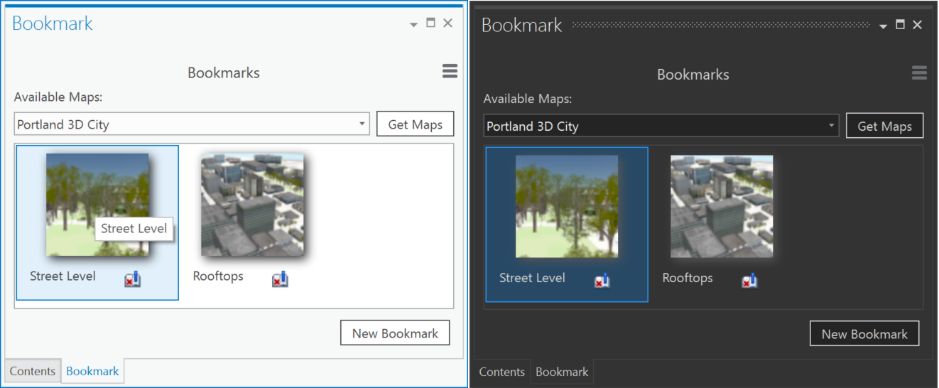

<DataTemplate x:Key="BookmarkListItem" DataType="{x:Type mapping:Bookmark}">
<StackPanel Orientation="Vertical" Background="Transparent">
<Image Source="{Binding Thumbnail}"
Width="96" Height="96" Stretch="Fill" Margin="5"
DockPanel.Dock="Left" ToolTip="{Binding Name}">
<Image.Effect>
<DropShadowEffect Color="{DynamicResource Esri_Color_Gray145}" BlurRadius="14" ShadowDepth="4.5">
</DropShadowEffect>
</Image.Effect>
</Image>
<StackPanel Orientation="Horizontal" Margin="5" >
<TextBlock Text="{Binding Name}" Margin="5,0,0,0" Style="{DynamicResource RegularText}" />

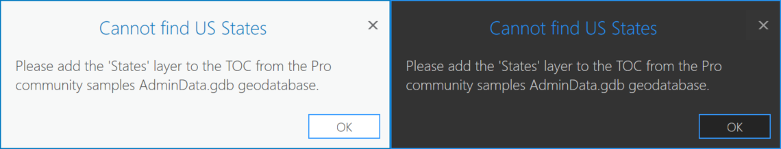

Message Boxes
Default Style: Yes
Message boxes cannot be styled. Use ArcGIS.Desktop.Framework.Dialogs.MessageBox to get the Pro look and feel for Message box functionality.
ArcGIS.Desktop.Framework.Dialogs.MessageBox.Show(
"Please add the 'States' layer to the TOC from the Pro community samples AdminData.gdb geodatabase.",
"Cannot find US States");

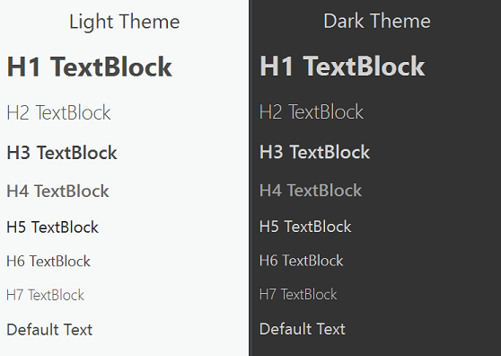

TextBlocks
*Brush, Weight and Size are for reference only. Font Styles have the correct color applied and should not be modified.
- Default text
| Attribute | Value |
| Font Family | Segoe UI |
| Font size | 12pt |
| Font weight | Normal |
| Foreground brush | Esri_TextStyleDefaultBrush |
<TextBlock Style="{DynamicResource Esri_TextBlockRegular}">Default text</TextBlock>
- H1 Content Header
| Attribute | Value |
| Font size | 20pt |
| Font weight | Bold |
| Foreground brush | Esri_Gray155 |
<TextBlock Style="{DynamicResource Esri_TextBlockH1}">H1 TextBlock</TextBlock>
- H2 Content Header
| Attribute | Value |
| Font size | 15pt |
| Font weight | Light |
<TextBlock Style="{DynamicResource Esri_TextBlockH2}">H2 TextBlock</TextBlock>
- H3 Content Header
| Attribute | Value |
| Font size | 14pt |
| Font weight | SemiBold |
<TextBlock Style="{DynamicResource Esri_TextBlockH3}">H3 TextBlock</TextBlock>
- H4 Content Header
| Attribute | Value |
| Font size | 13pt |
| Foreground brush | Esri_Gray145 |
<TextBlock Style="{DynamicResource Esri_TextBlockH4}">H4 TextBlock</TextBlock>
- H5 Content Header
| Attribute | Value |
| Font size | 12pt |
| Foreground brush | Esri_Gray160 |
<TextBlock Style="{DynamicResource Esri_TextBlockH5}">H5 TextBlock</TextBlock>
- H6 Content Header
| Attribute | Value |
| Font size | 11pt |
<TextBlock Style="{DynamicResource Esri_TextBlockH6}">H6 TextBlock</TextBlock>
- H7 Content Header
| Attribute | Value |
| Font size | 11pt |
<TextBlock Style="{DynamicResource Esri_TextBlockH7}">H7 TextBlock</TextBlock>

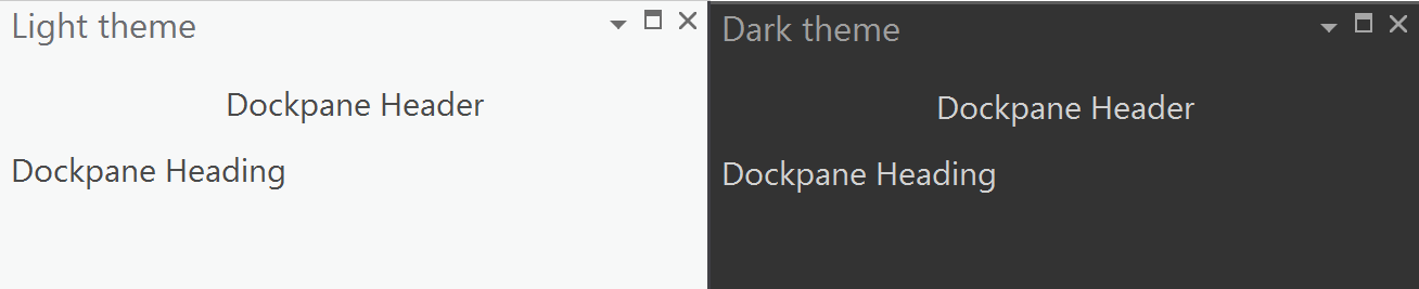

Dockpane TextBlocks
- Dockpane heading
| Attribute | Value |
| Font size | 15pt |
| Font weight | Regular |
<TextBlock Style="{DynamicResource Esri_TextBlockDockPaneHeading}">Dockpane heading</TextBlock>
- Dockpane header
| Attribute | Value |
| Font size | 15pt |
<TextBlock Style="{DynamicResource Esri_TextBlockDockPaneHeader}">Dockpane header</TextBlock>
Dialog TextBlocks
- Dialog header
| Attribute | Value |
| Font size | 16pt |
<TextBlock Style="{DynamicResource Esri_TextBlockDialogHeader}">Dialog header</TextBlock>
- Dialog text
| Attribute | Value |
| Font size | 14pt |
<TextBlock Style="{DynamicResource Esri_TextBlockDialog}">Dialog text</TextBlock>
