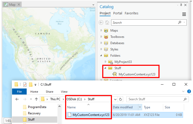

In the Pro Catalog panes, all content is an "Item". Content that is browsed on disk or online that is external to the project are considered items. Content that is persisted into a project (aprx) are considered project items. Custom items are a special type of item that allows 3rd parties to add (or "include") their proprietary file types into Pro and to define the custom behavior, context menu items, etc. for "that" particular content type. Without the custom item, Pro would "skip" the corresponding file content item when browsing or searching on disk and it otherwise would not be shown (in catalog panes or browse dialogs).
Custom items, however, are not a mechanism for extending or overriding existing item types already recognized by Pro (not all of which are shown in catalog or browse). If Pro already has an Item implementation for a particular file type then attempting to replace it or override it with a custom item will be ignored. The complete list of content types already supported by Pro can be found in the supported data types and items document in the Pro help. None of these data types can be implemented with a custom item.

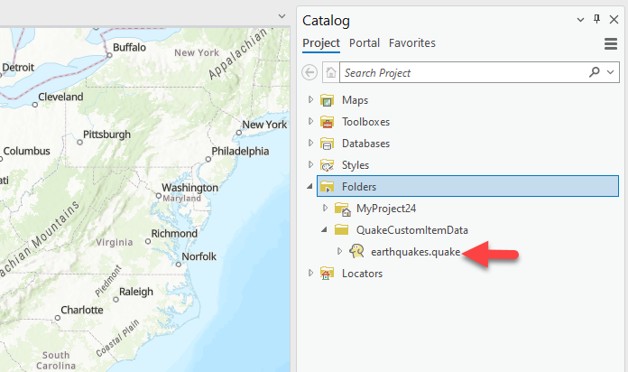

In the screenshot below, a custom item has been defined for a file content type of ".quake" and as a result, "quake content" is shown in the catalog pane whenever a ".quake" file is browsed on disk (".quake" is a made-up xml file format used in the ProjectCustomItemEarthQuake sample to illustrate use of custom items)
Sample Custom Item

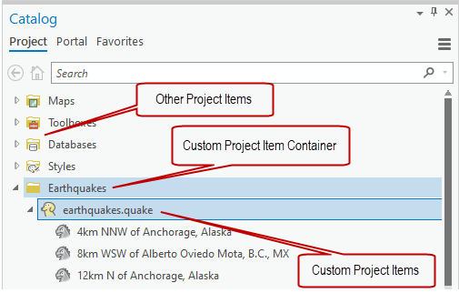

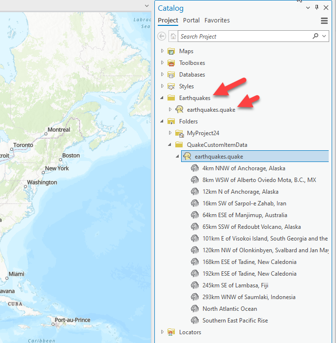

In the second screen shot, the same ".quake" file has also been added as content to the project. Notice that earthquakes.quake appears under a custom project container "Earthquakes". Adding ".quake" content to the project (to include the "Earthquakes" container) requires implementation of a custom project item (which derives from the custom item base class). Custom project items (or references to their underlying file content) are persisted in the project whenever the project is saved.
Sample Project Custom Item

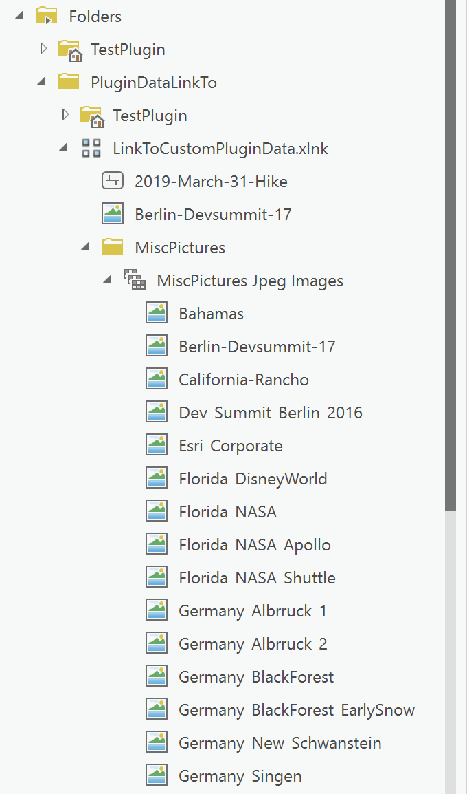

One of the primary use cases for custom items is their use in-conjunction with a plugin datasource. Plugin datasources are custom datasources that can be used by Pro to read proprietary GIS data as a PluginDataStore with (read only) access to its content as tables and feature classes (same as a plugin workspace provides via 10.x Arcobjects in Arcmap).
In addition to being able to add the custom datasource content (via the plugin) to maps and scenes, it is also typically desirable to add search and browse support for the custom datasource content as well. This is where the custom item comes in. Pairing a custom item with a plugin datasource allows your custom content to be integrated both into the Pro catalog and browse experience and as a consumable datasource for content in the map as well.
The combination of a Plugin datasource and Custom Item is illustrated in the ProDataReader sample. The ProDataReader uses a plugin to consume a variety of different data types including photos with GIS metadata (.jpg), and GPX tracking data (.gpx) files. ProDataReader uses custom items to integrate the browsing and consumption of the different data types seamlessly into the Pro catalog.
ProDataReader sample:
Sample Custom Item and Plugin Datasource

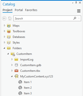

Custom Item Containers
Custom Item file content may contain data elements that need to be displayed as children of the file in the ArcGIS Pro Catalog TreeView. For example, a file that contains "records" where each record "is an" item or a proprietary database accessed via a connection file where the database contents are shown:
Custom Item with Children

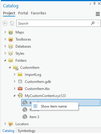

Context Menus
Actions for Custom Items are usually initiated through a context menu. You can define a context menu in the DAML by specifying a contextMenuID in the content tag of the component definition of the Custom Item as shown here:
<updateCategory refID="esri_customItems">
  <insertComponent id="CustomItem_ProCustomItem1" className="ProCustomItem1">
    <content displayName="ProCustomItem 1" fileExtension="xyz123" isContainer="false"
			 keywords="ProCustomItem 1"
			 contextMenuID="CustomItem_ProCustomItem1_ContextMenu" />
  </insertComponent>
</updateCategory>
You can also specify the context menu programmatically via the ContextMenuID property. In this example, ChildCustomItem sets its context menu id within its constructor:
  internal class ChildCustomItem : CustomItemBase {
     public ChildCustomItem(string name, string catalogPath, string type)
						: base(name, catalogPath, type) {
	this.ContextMenuID = "CustomItem_ProCustomItem1_ContextMenu";
It is assumed that the menu "CustomItem_ProCustomItem1_ContextMenu" is defined within the add-in config.daml.
Custom Item Context Menu
Within your context menu items (typically buttons), use the catalog pane's SelectedItems property to retrieve the current (catalog) context. The selected item(s) can then be used for the desired custom action:

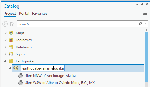

Renaming
To implement renaming support:
  1. Override CanRename to return true.
  2. Override OnRename(string newName) to implement your renaming logic*.
*If a file is being renamed then the item Path must also be updated (see the example below).
Note: the associated file name for a custom item is assumed to be it's "item" name. Therefore, if you are renaming an item and it is associated with a file on disk (the most common scenario) then the custom item is responsible for renaming the underlying file on the file system and updating this.Path. Said another way, you cannot rename an item without renaming its underlying file (if it has one).
For example:
  internal class MyCustomItem : CustomItemBase {
     //return true
     protected override bool CanRename => true;
     //implement renaming logic in OnRename
     protected override bool OnRename(string newName) {
        //In this case we have to rename a file on disk
        var new_ext = System.IO.Path.GetExtension(newName);
        if (string.IsNullOrEmpty(new_ext)) {
	   // add the file extension if need be
	   new_ext = System.IO.Path.GetExtension(this.Path);
	   newName = System.IO.Path.ChangeExtension(newName, new_ext);
         var new_file_path = System.IO.Path.Combine(
		System.IO.Path.GetDirectoryName(this.Path), newName);
         //move the physical file to the "new" name
         System.IO.File.Move(this.Path, new_file_path);
         this.Path = new_file_path; //we ~must~ update the item Path to keep
                                    //name and path in-sync
         return base.OnRename(newName);

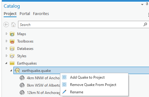

To add rename to an item context menu, we can simply use the existing out-of-box renaming button esri_core_rename button and add it to the Custom Item's context menu in the config.daml:
 <menu id="MyCustomItem_ContextMenu" caption="Custom Item Context Menu">
   <button refID="AddToProject" />
   <button refID="RemoveFromProject" />
   <button refID="esri_core_rename" /><!-- "out-of-box" rename -->
 </menu>
An item that overrides CanRename to return true also "picks up" built-in support for rename. The F2 key toggles the selected item node into rename mode (if CanRename = true ) same as if a rename context menu item had been selected.

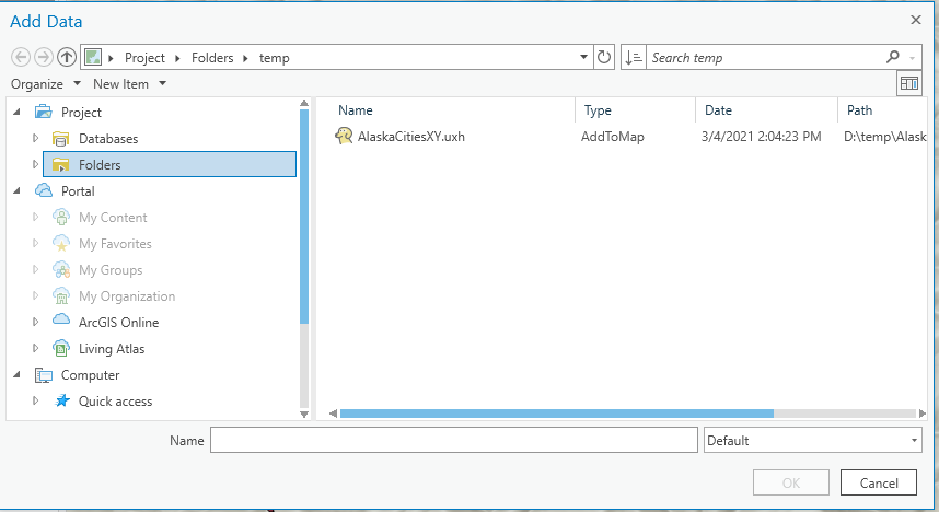

Item content can be added to ArcGIS Pro using the following application workflows
  • "Add Data" dialog
  • "Add Data from Path" dialog
  • drag/drop of your item from the catalog window to a map
  • drag/drop of your item from the catalog window to the TOC
  • drag/drop of your item from windows explorer to a map
  • drag/drop of your item from windows explorer to the TOC
In addition to the above you can add your own custom entry points. For example, adding an "Add to Map" menu item to the context menu associated with your custom item.
To support the above application workflows, your custom item must implement the IMappableItem interface.
internal class AddToMapCustomItem : CustomItemBase, IMappableItem, IMappableItemEx

Finally, to fully support the "Add Data" dialog workflow, your custom item needs to be available in the default filter in the Add Data browse dialog. Use the AddToMap filter flag in the daml definition of your item to achieve this.
    <insertComponent id="AddToMapCustomItem_AddToMap" className="AddToMapCustomItem">
      <!--You cannot use any file extensions known to Pro and Geoprocessing.-->
      <content displayName="AddToMap" fileExtension="uxh" isContainer="false" keywords="AddToMap" contextMenuID="AddToMapCustomItem_AddToMap_ContextMenu">
        <filterFlags>
          <!--Change this flag as needed. See FilterFlag enum. Example: AddToMap, DontBrowseFiles...-->
          <type id="AddToMap" />
        </filterFlags>
      </content>
    </insertComponent>
  </updateCategory>

Custom Project Item Container
Custom project item containers are shown in the catalog panes as top-level, or "Root", nodes. By default all project item containers are not visible in catalog unless they contain project item content. The exceptions to this rule are the default Pro project item containers for Maps, Toolboxes, Databases, Layouts, Styles, Folders, and Locators which are always visible whether they contain content or not.
To add custom project items to a project, the add-in can either explicitly retrieve the instance of the (respective) custom project item container and add the item to it directly or implicitly by adding the item to the project instance which will, in turn, trigger a call to the custom container to add the content. If the container was empty previously then it will become visible in the Catalog pane once it has at least one item of content. The container must not already contain the item when the call to add the content (explicitly or implicitly) is made:
 QuakeProjectItem item = ....;
 //either explicit...
 //get the associated container for the item
 var container = Project.Current.GetProjectItemContainer(
            item.Type) as QuakeProjectItemContainer;
 //add the item
 container.AddItem(item);
 //or implicit...
 //add the item to the project and the project will add it to the container
 QueuedTask.Run(() => Project.Current.AddItem(item));
Whenever content is to be added to a custom project item container implicitly, it's corresponding CreateItem method is always called. CreateItem will always be called whenever a custom project item associated with the container is added to the project (via GetItem) or a custom project item is being "re-hydrated" from persisted data (saved in the project) when the project is opened. Custom containers are responsible for instantiating the item whose details are passed in to CreateItem. The item should be added to the container's child project item collection if it is successfully created.
