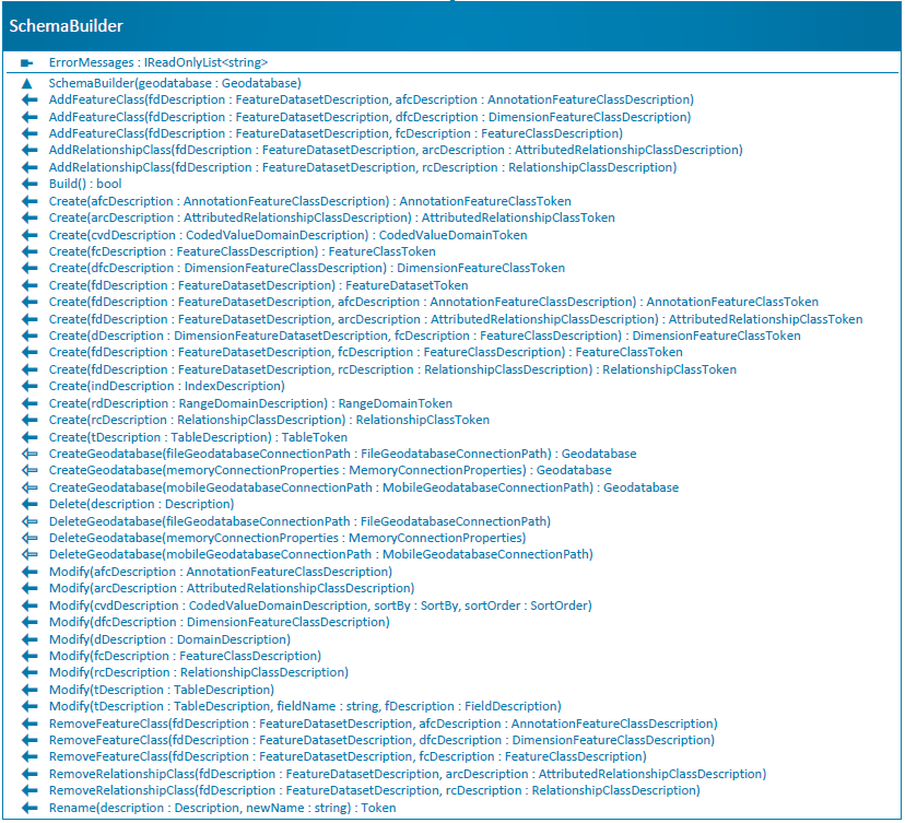

Schema modifications are made using a SchemaBuilder object, which is constructed with a Geodatabase. File, mobile, enterprise, and memory geodatabases support schema operations.
// Create a SchemaBuilder object
SchemaBuilder schemaBuilder = new SchemaBuilder(geodatabase);
DDL operations for creation are enqueued with the schema builder using a set of calls to Create methods.
// Add the creation of the table to our list of DDL tasks
schemaBuilder.Create(tableDescription);
The set of DDL operations is then executed with a call to Build. If the process fails, the ErrorMessages property can be queried to find out what went wrong.
// Execute the DDL
bool success = schemaBuilder.Build();
DDL routines can fail for the same reasons as the equivalent geoprocessing tool. For example, if a table has outstanding edits, you cannot delete it.
The Build operation is not guaranteed to be atomic. For example, consider a build operation that creates two tables. If the second table creation fails, the first table will still be created. It is the caller's responsibility to check the ErrorMessages property and perform any required cleanup in the event of a failure. In the example above, if the second table creation fails, the caller may wish to delete the first table in a subsequent DDL operation.
The same SchemaBuilder object can be used for multiple sets of DDL operations, each executed by a call to Build. If Build is called multiple times, only messages from the most recent call can be retrieved from the ErrorMessages property.

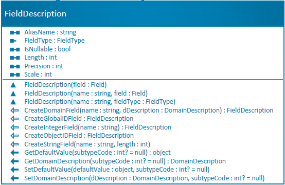

The Pro SDK can be used to create tables and feature classes. To begin, create a series of FieldDescription objects.
Each of these represents the definition of a field to be created in the new table. You can create a FieldDescription from an existing Field or by setting properties individually. Static helper routines are provided for creating common field types. Some examples are shown below:
// Create a FieldDescription for the InspectionDate field
FieldDescription inspectionDateFieldDescription = new FieldDescription("InspectionDate", FieldType.Date)
  AliasName = "Inspection Date"
// This static helper routine creates a FieldDescription for a Domain field (from a pre-existing domain)
FieldDescription inspectionResultsFieldDescription = FieldDescription.CreateDomainField("InspectionResults", new CodedValueDomainDescription(inspectionResultsDomain));
inspectionResultsFieldDescription.AliasName = "Inspection Results";

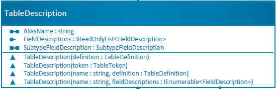

After creating the desired set of FieldDescription objects, the next step is to create a TableDescription object representing the definition of the table itself.
The TableDescription is passed to SchemaBuilder.Create and then SchemaBuilder.Build is used to actually create the table.

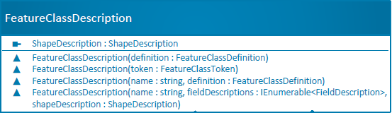

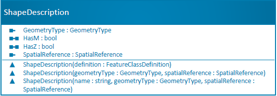

Creating a feature class follows many of the same principles as creating a table. One addition is that you must create a ShapeDescription object to represent the definition of the shape field.
ShapeDescription objects can be created from a set of properties or by using the FeatureClassDefinition of an existing feature class. Set HasM and HasZ to true if you want to use a vertical coordinate system with Z values for height or depth, or if you need M values (measure) along a line.
// Create a ShapeDescription object
ShapeDescription shapeDescription = new ShapeDescription(GeometryType.Point, spatialReference);
// Alternatively, ShapeDescriptions can be created from another feature class.  In this case, the new feature class will inherit the same shape properties of the existing class
ShapeDescription alternativeShapeDescription = new ShapeDescription(existingFeatureClass.GetDefinition());
The final step is to create a FeatureClassDescription and build the feature class using the same pattern described above.
// Create a FeatureClassDescription object to describe the feature class to create
FeatureClassDescription featureClassDescription = new FeatureClassDescription("Cities", fieldDescriptions, shapeDescription);
// Add the creation of the Cities feature class to our list of DDL tasks
schemaBuilder.Create(featureClassDescription);
// Execute the DDL

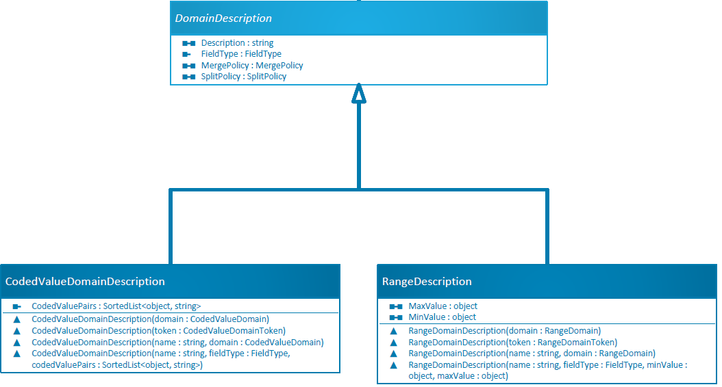

Domains
Both coded value domains and range domains can be created with the DDL APIs in the Pro SDK.
Creating Domains
The same pattern used for other DDL operations applies here: create a Description object and pass it to the SchemaBuilder.Create method. This example shows how to create a coded value domain for water pipe types.
CodedValueDomainDescription codedValueDomainDescription = new CodedValueDomainDescription("WaterPipeTypes", FieldType.String,
  new SortedList<object, string> { { "Copper", "C_1" }, { "Steel", "S_2" } })
  SplitPolicy = SplitPolicy.Duplicate,
  MergePolicy = MergePolicy.DefaultValue
// Create a coded value domain
CodedValueDomainToken codedValueDomainToken = schemaBuilder.Create(codedValueDomainDescription);
Modifying and Renaming Domains
The SchemaBuilder class can modify both coded value and range domains. First, create a modified description object and then pass it to the SchemaBuilder.Modify method to update the domain description and add or remove domain values, as described below.
// Updating description and value of a coded value domain
CodedValueDomain codedValueDomain = geodatabase.GetDomains().First(f => f.GetName().Equals("WaterPipeTypes")) as CodedValueDomain;
CodedValueDomainDescription codedValueDomainDescription = new CodedValueDomainDescription(codedValueDomain);
// Update the domain description
codedValueDomainDescription.Description = "Water Pipe Distribution Types";
// Add a new code/value pair
codedValueDomainDescription.CodedValuePairs.Add("A", "Aluminum");
schemaBuilder.Modify(codedValueDomainDescription);
To rename domains, use SchemaBuilder.Rename:
// Renaming range domain from 'WaterMainPipe' to 'WaterDistributionPipe'
RangeDomain rangeDomain = geodatabase.GetDomains().First(f => f.GetName().Equals("WaterMainPipe")) as RangeDomain;
// Assign the new name
schemaBuilder.Rename(new RangeDomainDescription(rangeDomain), "WaterDistributionPipe");
Likewise, domains can be deleted by using SchemaBuilder.Delete, passing in a CodedValueDomainDescription or RangeDomainDescription. Domains cannot be deleted if they are in use by fields in the geodatabase.
// Deleting 'WaterPipeTypes' domain
schemaBuilder.Delete(codedValueDomainDescription);

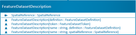

Feature Datasets
Feature datasets can be created and deleted by using the same pattern as other DDL operations.
// Create a feature dataset named 'Parcel_Information'
// Create a FeatureDataset named 'Parcel Information'
FeatureDatasetDescription featureDatasetDescription = new FeatureDatasetDescription("Parcel_Information", SpatialReferences.WGS84);
schemaBuilder.Create(featureDatasetDescription);
// Build status
bool buildStatus = schemaBuilder.Build();
// Build errors
if (!buildStatus)
  IReadOnlyList<string> errors = schemaBuilder.ErrorMessages;
You can also create a feature class directly inside a feature dataset. This example shows how to create a feature dataset and then create a feature class within that feature dataset by using a Token, as described above.
// Create a FeatureDataset named 'Parcel_Information' and a FeatureClass named 'Parcels' in one operation
string featureDatasetName = "Parcel_Information";
string featureClassName = "Parcels";
// Create a FeatureDataset token
FeatureDatasetDescription featureDatasetDescription = new FeatureDatasetDescription(featureDatasetName, SpatialReferences.WGS84);
FeatureDatasetToken featureDatasetToken = schemaBuilder.Create(featureDatasetDescription);
// Create a FeatureClass description
FeatureClassDescription featureClassDescription = new FeatureClassDescription(featureClassName,
  new List<FieldDescription>()
    new FieldDescription("Id", FieldType.Integer),
    new FieldDescription("Address", FieldType.String)
  new ShapeDescription(GeometryType.Point, SpatialReferences.WGS84));
// Create a FeatureClass inside a FeatureDataset
FeatureClassToken featureClassToken = schemaBuilder.Create(new FeatureDatasetDescription(featureDatasetToken), featureClassDescription);
// Build status
// Build errors
if (!buildStatus)

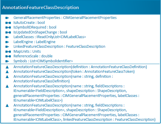

Annotation
Creating Annotation Feature Classes
The DDL API also supports creating annotation feature classes. Similar to creating tables and feature classes, creating an annotation feature class begins with a list of FieldDescription objects and a ShapeDescription object.
// Create fields
FieldDescription pipeGlobalID = FieldDescription.CreateGlobalIDField();
FieldDescription name = FieldDescription.CreateStringField("PipeName", 255);
// Create a list of all field descriptions
List<FieldDescription> fieldDescriptions = new List<FieldDescription> { pipeGlobalID, name };
ShapeDescription shapeDescription = new ShapeDescription(GeometryType.Polygon, spatialReference);
After that, create a general placement properties object for the appropriate label engine.
This example shows how a CIMMaplexGeneralPlacementProperties object can be used:
CIMMaplexGeneralPlacementProperties maplexGeneralPlacementProperties =  new CIMMaplexGeneralPlacementProperties
    AllowBorderOverlap = true,
    PlacementQuality = MaplexQualityType.High,
    DrawUnplacedLabels = true,
    InvertedLabelTolerance = 1.0,
    RotateLabelWithDisplay = true,
    UnplacedLabelColor = new CIMRGBColor { R = 0, G = 255, B = 0, Alpha = 0.5f }
This example shows how a CIMStandardGeneralPlacementProperties object can be used:
CIMStandardGeneralPlacementProperties standardGeneralPlacementProperties =  new CIMStandardGeneralPlacementProperties
    InvertedLabelTolerance = 3.0,
    UnplacedLabelColor = new CIMRGBColor { R = 255, G = 0, B = 0, Alpha = 0.5f }
Next, create a set of annotation label classes that describe how text labels should be created. This example shows how to create a label object that uses green Tahoma text:
CIMLabelClass greenLabelClass = new CIMLabelClass
Name = "Green",
ExpressionTitle = "Expression-Green",
ExpressionEngine = LabelExpressionEngine.Arcade,
Expression = "$feature.OBJECTID",
ID = 1,
Priority = 0,
Visibility = true,
TextSymbol = new CIMSymbolReference
  Symbol = new CIMTextSymbol()
	Angle = 45,
	FontType = FontType.Type1,
	FontFamilyName = "Tahoma",
	FontEffects = FontEffects.Normal,
	HaloSize = 2.0,
	Symbol = new CIMPolygonSymbol
	  SymbolLayers = new CIMSymbolLayer[]
		new CIMSolidFill
		  Color = CIMColor.CreateRGBColor(0, 255, 0)
	  UseRealWorldSymbolSizes = true
  MaxScale = 0,
  MinScale = 0,
  SymbolName = "TextSymbol-Green"
StandardLabelPlacementProperties = new CIMStandardLabelPlacementProperties
  AllowOverlappingLabels = true,
  LineOffset = 1.0
MaplexLabelPlacementProperties = new CIMMaplexLabelPlacementProperties
  AlignLabelToLineDirection = true,
  AvoidPolygonHoles = true
Create additional CIMLabelClass objects as needed, and add them to a list (This snippet shows a longer example).
// Create a list of CIM label classes
List<CIMLabelClass> labelClasses = new List<CIMLabelClass> { greenLabelClass, blueLabelClass };
Finally, create an AnnotationFeatureClassDescription and build the annotation feature class by using the same DDL create operation pattern described above:
// Create an annotation feature class description object to describe the annotation feature class to create
AnnotationFeatureClassDescription annotationFeatureClassDescription = new AnnotationFeatureClassDescription("WaterPipeAnnotation", fieldDescriptions, shapeDescription, maplexGeneralPlacementProperties, labelClasses)
  IsAutoCreate = true,
  IsSymbolIDRequired = false,
  IsUpdatedOnShapeChange = true
// Add the creation of the Cities annotation feature class to the list of DDL tasks
schemaBuilder.Create(annotationFeatureClassDescription);
// Execute the DDL
To create a feature-linked annotation feature class, the FeatureClassDescription of the linked feature class should be passed during AnnotationFeatureClassDescription creation.
// Create fields for linked feature class
FieldDescription waterPipeGlobalID = FieldDescription.CreateGlobalIDField();
FieldDescription pipeName = FieldDescription.CreateStringField("PipeName", 255);
// Create a list of water pipe field descriptions
List<FieldDescription> pipeFieldDescriptions = new List<FieldDescription> { waterPipeGlobalID, pipeName };
// Create a linked feature class description
FeatureClassDescription linkedFeatureClassDescription = new FeatureClassDescription("WaterPipe", pipeFieldDescriptions,
new ShapeDescription(GeometryType.Polygon, spatialReference));
// Add the creation of the linked feature class to the list of DDL tasks
FeatureClassToken linkedFeatureClassToken = schemaBuilder.Create(linkedFeatureClassDescription);
// Create a feature-linked annotation feature class description object
AnnotationFeatureClassDescription annotationFeatureClassDescription =new AnnotationFeatureClassDescription(annotationFeatureClassName,
fieldDescriptions, shapeDescription,  maplexGeneralPlacementProperties, labelClasses, new FeatureClassDescription(linkedFeatureClassToken))

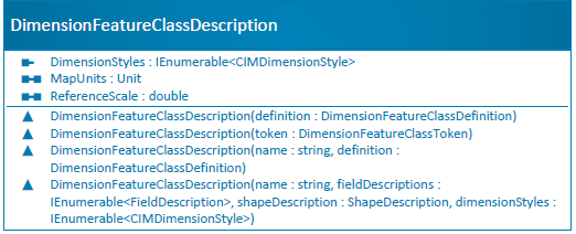

Dimension
Creating Dimension Feature Classes
The DDL API also supports creating dimension feature classes. To create a dimension feature class, start with a list of FieldDescription objects and a ShapeDescription object, just as you would when creating tables and feature classes.
// Create attribute fields for the dimension feature class
FieldDescription nameFieldDescription = new FieldDescription("Name", FieldType.String);
FieldDescription distanceFieldDescription = new FieldDescription("DistanceMeasure", FieldType.Double);
FieldDescription measurementDateFieldDescription = new FieldDescription("MeasurementDate", FieldType.Date);
// Create a list of field descriptions
List<FieldDescription> fieldDescriptions = new List<FieldDescription> { nameFieldDescription, distanceFieldDescription, measurementDateFieldDescription };
Create a polygon shape description.
ShapeDescription shapeDescription = new ShapeDescription(GeometryType.Polygon, SpatialReferences.WGS84);
Next, you need to create a list of CIMDimensionStyle objects, which define the appearance of the dimensions.

Finally, create a DimensionFeatureClassDescription and use the same DDL create operation pattern described earlier to build the dimension feature class.
DimensionFeatureClassDescription dimensionFeatureClassDescription = new DimensionFeatureClassDescription("LinesInfo", fieldDescriptions,
shapeDescription, cimDimensionStyles);
DimensionFeatureClassToken dimensionFeatureClassToken = schemaBuilder.Create(dimensionFeatureClassDescription);
bool status = schemaBuilder.Build();

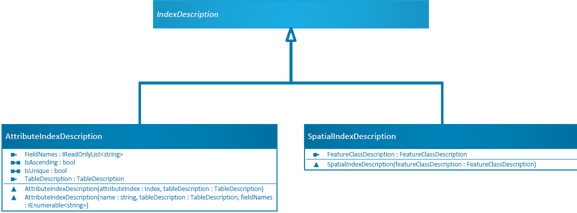

The DDL APIs also support creating and removing both spatial and attribute indexes. The AttributeIndexDescription and SpatialIndexDescription classes define attribute and spatial indexes, respectively. The index creation and deletion process follows patterns similar to other DDL operations.
Creating Attribute Indexes
To create an attribute index description object, the AttributeIndexDescription constructor takes the index name, the table dataset on which the index is to be built, and a set of table fields that participate in the index. The AttributeIndexDescription object is then passed to the SchemaBuilder.Create method, as illustrated below.
// Creating a table with index from scratch
// Table fields
FieldDescription nameFieldDescription = FieldDescription.CreateStringField("Name", 50);

Creating Spatial Indexes
The SpatialIndexDescription constructor takes a feature class description to create a spatial index description object. Then you can call SchemaBuilder.Create and SchemaBuilder.Build to build the spatial index, as shown below.
// Creating the spatial index description object
SpatialIndexDescription spatialIndexDescription = new SpatialIndexDescription(new FeatureClassDescription(featureClassDefinition));
// Enqueue DDL operation for spatial index creation
schemaBuilder.Create(spatialIndexDescription);
// Execute build index DDL operation
bool isBuildSuccess = schemaBuilder.Build();
This operation will recalculate the spatial index if a dataset already has the spatial index.
Deleting Indexes
Following the DDL delete pattern, you can use SchemaBuilder.Delete to delete indexes.
#region Removing attribute index
// Find attribute index to be removed
Index indexToRemove = featureClassDefinition.GetIndexes().First(f => f.GetName().Equals("IndexNameToBeRemoved"));
// Index description of the index to be removed
AttributeIndexDescription indexDescriptionToRemove = new AttributeIndexDescription(indexToRemove, new TableDescription(featureClassDefinition));
// Enqueue DDL operation to remove attribute index
schemaBuilder.Delete(indexDescriptionToRemove);
#endregion
# region Removing spatial index
// Create spatial description
// Enqueue DDL operation to remove the spatial index
schemaBuilder.Delete(spatialIndexDescription);
# endregion
// Execute delete indexes operation
bool isDeleteIndexSuccess = schemaBuilder.Build();
