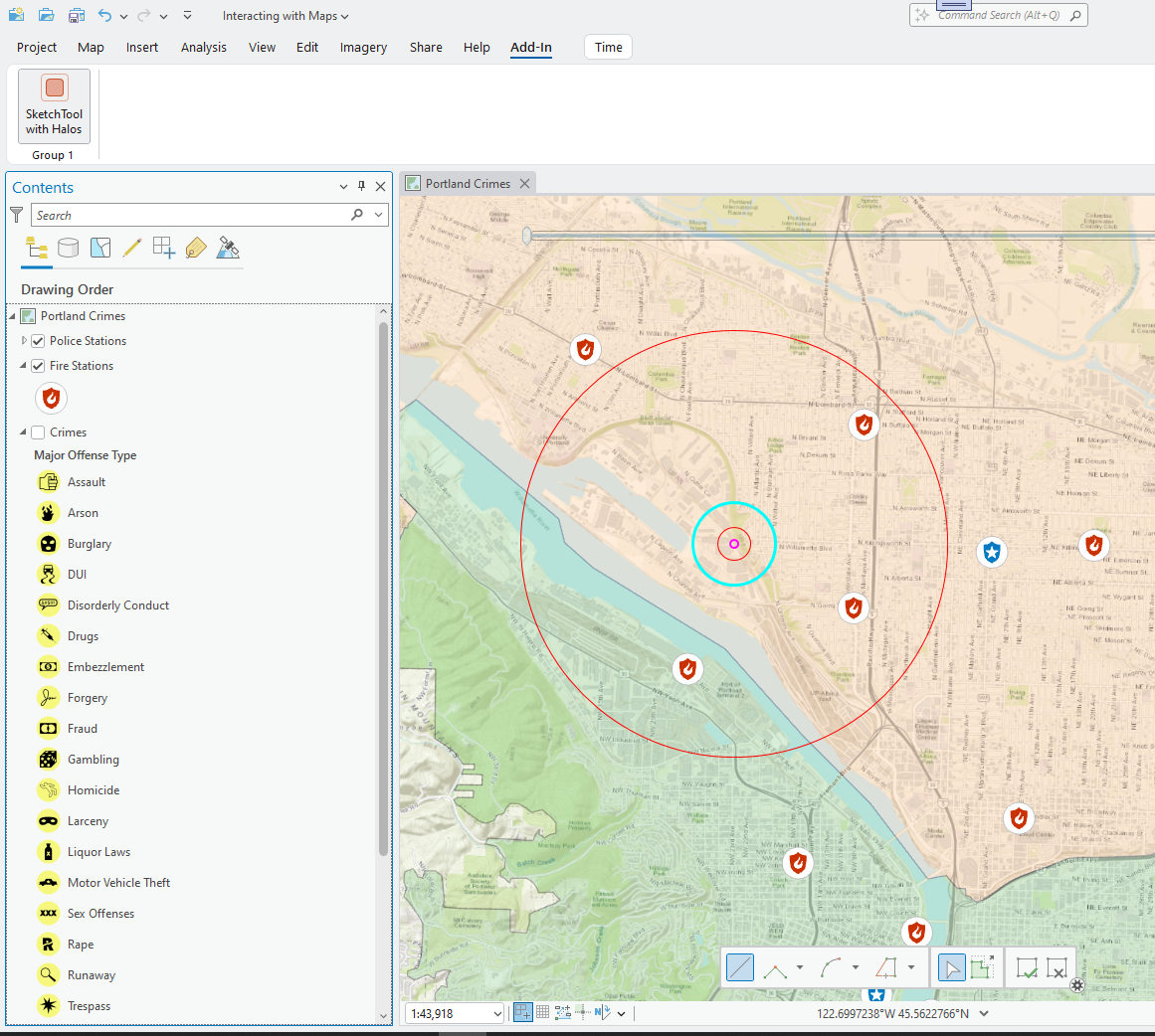

This guide demonstrates how to create a sketch tool with halos centered around the cursor. The halos are implemented using an embeddable control assigned to the SketchTipID of the tool. See ProConcepts Map Exploration, MapTool for more information on the MapTool pattern. The code used in this ProGuide can be found at Sketch Tool Halo Sample.

In the constructor, change the SketchType of the map tool to a line geometry type. This is the geometry of the map tool feedback used to symbolize the user interaction. For this example, you're using a single solid line that adds a linear segment on each mouse click. Set the SketchTipID variable to the ID of the embeddable control added. If you followed the naming conventions in the Prerequisite section then the ID should be "SketchToolWithHalos_HaloEmbeddableControl".
The default properties of a sketch tip on a MapTool are to be located to the lower right of the cursor and to have a grey background. Two properties were added to the MapTool class at the 3.4 release to allow you to customize the sketch tip location and transparency. The properties are SketchTipControlPosition and IsSketchTipControlTransparent.
The halos will be centered around the cursor so set the SketchTipControlPosition to SketchTipControlPosition.Center. We also want the embeddable control to be transparent so set IsSketchTipControlTransparent to true.
  public SketchToolHalo()
    IsSketchTool = true;
    SketchType = SketchGeometryType.Line;
    SketchOutputMode = SketchOutputMode.Map;
    SketchTipID = "SketchToolWithHalos_HaloEmbeddableControl";
    SketchTipControlPosition = SketchTipControlPosition.Center;
    IsSketchTipControlTransparent = true;
Build the sample and verify that there are no compile errors.
Run ArcGIS Pro. Open the C:\Data\Interacting with Maps\Interacting with Maps.aprx project that contains 2D and 3D maps with feature data. Open the 2D map. Activate the Sketch Tool with Halos on the Add-in tab.
Move your mouse around and notice how the halos follow the cursor. Zoom in and out and notice how the halos adjust to the different map scale. The more you zoom out the smaller the halos become. Eventually you reach a scale where the halo display is not particularly useful as they become too small to be displayed. In the final step, a minimum scale property will be added. This value will be compared against the screen radius of each halo to determine whether it should be displayed or not.
Run ArcGIS Pro. Open the C:\Data\Interacting with Maps\Interacting with Maps.aprx project Activate the Sketch Tool with Halos on the Add-in tab and explore how the halos disappear and reappear when you zoom in and out.
