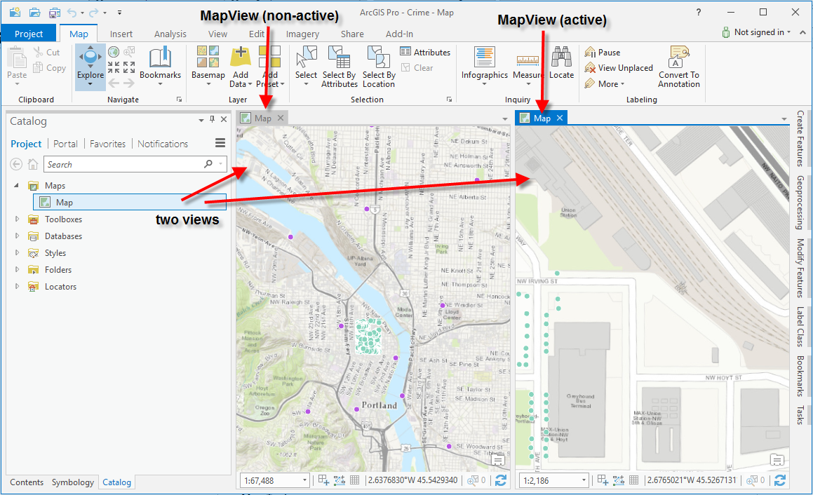

A project can contain multiple maps, either 2D or 3D, and each defines the collection of layers that make up that map. A map view is simply a view of a map. Map views are the primary interface used to display, navigate, select, identify, and edit data in a 2D or 3D map. The MapView class provides properties and methods to navigate and interact with layers in the map. The map being visualized in the view can be accessed via the Map property.
There can be multiple map views open at a given time, but there can only be one active map view. The active map view will set the context for the ribbon and many of the dock panes in the application. For example, the map Contents pane will reflect the layers of the active map view's map. The instance of the active map view can be accessed via the static Active property on MapView. The active property will return null if there is no active map view. This is useful when writing commands designed to interact with the active map.

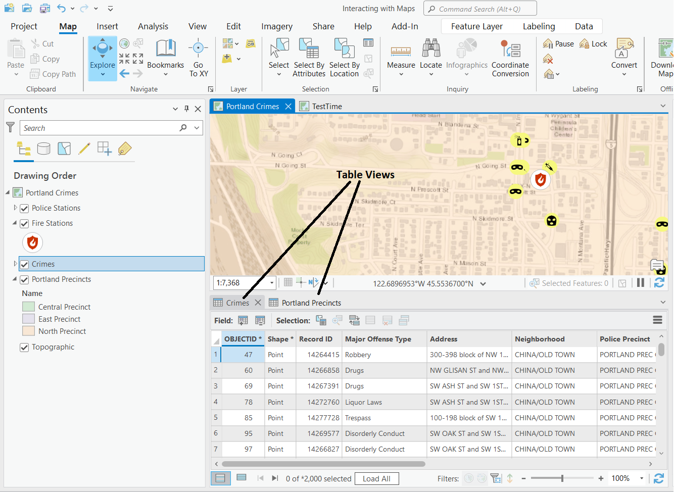

TableView
A table view is a view of a table or feature class. Table views are the primary interface for displaying, selecting and editing data in a tabular fashion. The TableView class provides properties and methods to navigate and interact with the table.
There can be multiple table views open at a given time, but there can only be one active table view. The active table view will set the context for the ribbon and the Table of Contents. The instance of the active table view can be accessed via the static Active property on TableView. The active property will return null if there is no active table view.
Table View
Typically a table view is linked to a layer or standalone table that is in a map. When visualized in this way use the MapMember property to obtain the underlying object. However, a table view can also be linked to a table or featureclass directly from an external geodatabase (ie, the table or featureclass are not in the map). In this case, the underlying object can be accessed with the Item property. Use ArcGIS.Desktop.Core.ItemFactory.CanGetDataset and ArcGIS.Desktop.Core.ItemFactory.GetDataset to retrieve the data.

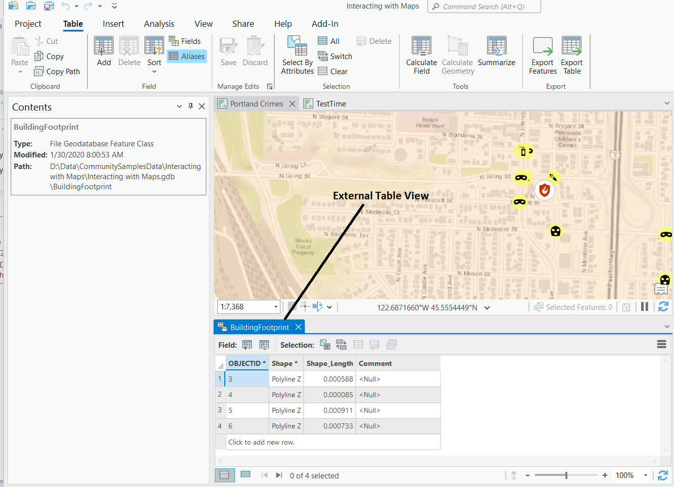

Here's an example of a table view displaying data from an external source. See how the context of the Table of Contents and ribbon are different from the above picture showing table views containing map data.
External Table Views

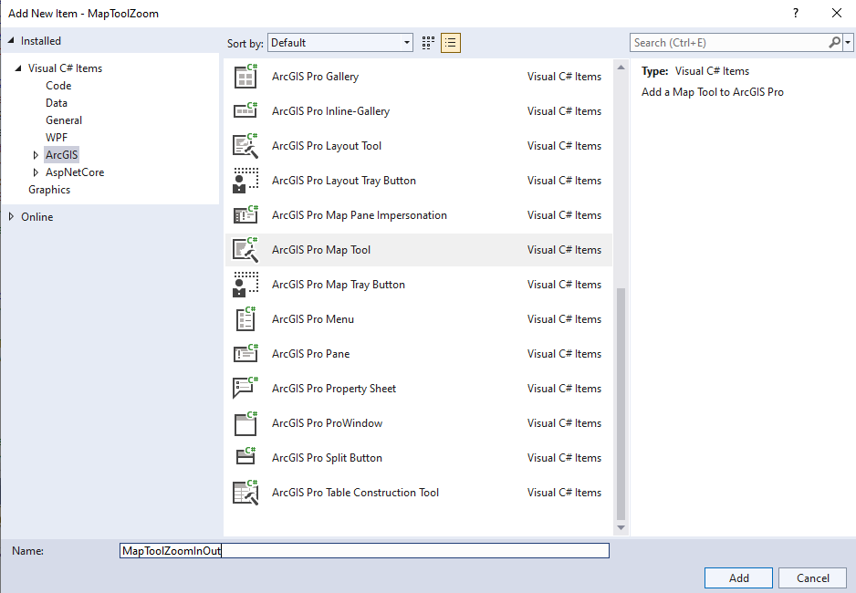

The Pro SDK includes the ArcGIS Pro Map Tool template which automates much of the daml and code class file definition required to create a basic map tool. Simply run the Pro SDK map tool template to auto-generate the tool daml and class file definition.

By setting the IsSketchTool property to true, the tool will create a sketch in the map view with left mouse clicks. The geometry type of the sketch can be set using the SketchType property, and the SketchOutputMode property can be used to specify whether the sketch geometry will be created in screen or map coordinates. If you want the tool to snap while sketching set the UseSnapping property to true. If the IsSketchTool property is set to false then activating your map tool leaves the viewer in its default mode and clicks on the map will not create a sketch. If you have coded a map tool and are trying to figure out why it doesn't start sketching on the left mouse click then you may have forgotten to set the IsSketchTool property to true.
internal class MapTool1 : MapTool
  public MapTool1()
    IsSketchTool = true;//Activate sketching when we are activated
The "in progress" sketch is passed to the map tool via the protected OnSketchModifiedAsync() method. When the sketch is finished, the virtual method OnSketchCompleteAsync will be called, and it will pass in the geometry that was created by the sketch. Both of these methods can be overridden in your map tool to implement any required custom behavior.

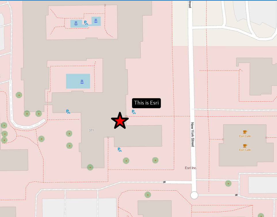

Temporary graphics can be added to your map view or scene view using a "graphic overlay" associated with the map or scene views. The overlays are for showing temporary data that's not persisted when the view is closed. Overlay graphics are defined using a geometry to specify its location and a corresponding CIM symbol (technically a CIM symbol symbol reference). A CIMGraphic can also be used (which combines the geometry and symbol into a single entity). Graphics can be points, lines, polygon, or text (to include callouts).
In the image below, a point geometry symbolized with a star has been added to the overlay. Additionally, a second text graphic has been added, using a callout, to "add" a label to the star.
graphicOverlay
To create a Graphic overlay, use one of the MapView AddOverlay methods. There are multiple overloads for this method that use a geometry and a Symbol reference; a CIMGraphic; or a feature oid (for the location) and Symbol Reference.
public static IDisposable AddOverlay(MapView mapView, Geometry geometry, CIMSymbolReference symbol,
                                     double referenceScale = -1)
                                     double referenceScale, double showThrough)
public static IDisposable AddOverlay(MapView mapView, CIMGraphic graphic,
public static IDisposable AddOverlay(MapView mapView, Layer layer, long oid,
                                     CIMSymbolReference symbol = null, double referenceScale = -1)
In the methods above, the referenceScale is an optional parameter. The showThrough parameter is used in 3D only and is a visibility factor for showing the overlay through other objects when obscured.
The AddOverlay method returns an IDisposable which can be used to clear the graphic. To remove the graphic, call "Dispose" on the returned IDisposable (eg _graphic.Dispose()). Save the IDisposable in a member variable if you need to maintain a reference to it. If you do not remove the graphic, it will automatically be removed when the mapview is closed.
The following code snippet illustrates how to create a graphic using a geometry and CIM symbol (reference).
  private IDisposable _graphic = null; //defined elsewhere
  // Add point graphic to the overlay at the center of the mapView
  // Note: Run within QueuedTask.Run
  _graphic = mapView.AddOverlay(mapView.Extent.Center,
               SymbolFactory.Instance.ConstructPointSymbol(
                 ColorFactory.Instance.RedRGB, 40.0, SimpleMarkerStyle.Star).MakeSymbolReference());
  // Note: Update graphic using UpdateOverlay
  // mapView.UpdateOverlay(_graphic,...);
  _graphic.Dispose(); //Removes the graphic

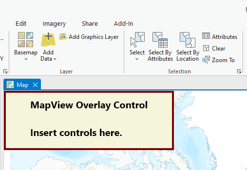

WPF User Controls can also be added "on top of" the mapview or scene using a MapViewOverlayControl wrapper passed as the parameter to mapView.AddOverlayControl(...).
To add a user control on top of Pro's mapview, first create a MapViewOverlayControl. The first parameter in the MapViewOverlayControl constructor is the WPF user control that you want to display on top of the map view. The MapViewOverlayControl constructor has parameters to configure various aspects of your user control's display and behavior such as its initial position, and whether it can be moved or resized, etc.
public MapViewOverlayControl(
   FrameworkElement control,
   bool canMove,
   bool canResizeHorizontally,
   bool canResizeVertically,
   OverlayControlRelativePosition relativePosition,
   double initialXRatio,
   double initialYRatio
You can create a simple WPF User Control xaml (in this case two text blocks surrounded with a maroon border):
<UserControl x:Class="OverlayControlExample.OverlayTestingControl"
             xmlns="http://schemas.microsoft.com/winfx/2006/xaml/presentation"
    <Grid>
      <Border Background="Beige" BorderBrush="Maroon" BorderThickness="4">
        <StackPanel Orientation="Vertical" >
          <TextBlock FontSize="20" FontWeight="Bold" Margin="50, 10"> MapView Overlay Control</TextBlock>
          <TextBlock FontSize="20" FontWeight="Bold" Margin="50, 20"><Run Text="Insert controls here."/>
          </TextBlock>
        </StackPanel>
      </Border>
    </Grid>
</UserControl>
To add our custom user control to the mapview overlay, we pass an instance of our user control to the MapViewOverlayControl constructor along with the desired placement settings. We then invoke MapView.AddOverlayControl to add our user control to the mapview overlay:
//instantiates the control
var exampleControl = new OverlayTestingControl();
//allow it to be moved and resized
var MapViewOverlayControl = new MapViewOverlayControl(exampleControl, true, true, true,
                                    OverlayControlRelativePosition.TopLeft);
//add the wrapper to the overlay
mapView.AddOverlayControl(MapViewOverlayControl);

This daml identifer can be passed to the EmbeddableControl.Create method to create the view and view model pair. The code for adding the embeddable control to the overlay is as follows
//instantiates the embeddable control and sets datacontext
var tuple = EmbeddableControl.Create("OverlayControlExample_EmbeddableControl1");
//Get the user control (view)
var exampleControl = tuple.Item2 as EmbeddableControl1View;
           exampleControl, true, true, true, OverlayControlRelativePosition.TopLeft);
The MapViewOverlayControl object should be held in a member variable if access is required later, or to send to RemoveOverlayControl when it is no longer needed (and should be removed from the overlay). If RemoveOverlayControl is not called, the overlay control is removed automatically when the mapview is closed.
Sample: ScribbleControl_ArcGISPro
ProSnippet: MapView Overlay Control
