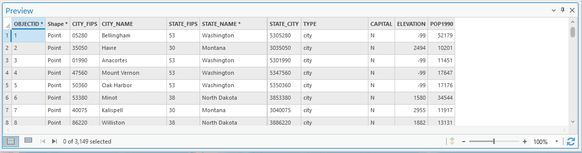

Build the sample and fix any compile errors. Debug the add-in and start ArcGIS Pro. Open a new Map project. Validate the UI by activating the Add-In tab.
showPreview
Click the Show Preview button and see the Preview dockpane appear at the bottom of the ArcGIS Pro window. Navigate to the Catalog pane. Add a new folder connection to the Community Samples Data you previously downloaded by right clicking on Folders and choose Add Folder Connection. Save your project after the connection is made. Navigate to one of the geodatabases in the folder and highlight one of the feature classes. You should see the data populated in the TableControl.
tableControl
Explore the default capabilities of the TableControl including the Row and Column context menus. Explore other datasets in the Community Samples Data by loading them into the TableControl. Stop debugging and return to Visual Studio when you are ready to continue.

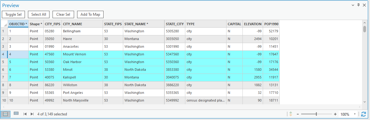

Return to the TableControlDockpane.xaml file. We will add some buttons to the DockPanel to provide additional functionality. Copy the following so that the DockPanel tag looks like the following:
<DockPanel LastChildFill="False" Grid.Row="0">
  <Button Content="Toggle Sel" Command="editing:TableControlCommands.SwitchSelection"
          CommandTarget="{Binding ElementName=tableControl}"
          Style="{DynamicResource Esri_Button}"/>
  <Button Content="Select All" Command="editing:TableControlCommands.SelectAll"
  <Button Content="Clear Sel" Command="editing:TableControlCommands.ClearSelection"
  <Button Content="Add To Map" Command="{Binding AddToMapCommand}"
</DockPanel>
There are a predefined set of TableControlCommands which are available for use with the TableControl. They can be referenced in xaml. In the above code snippet you can see we are referencing the SwitchSelection, SelectAll and ClearSelection commands. Take particular note of the CommandTarget property. When referencing these TableControlCommands in xaml it is important to also use the CommandTarget property to reference the TableControl's Name property, otherwise the command does not have the correct context and will not execute.

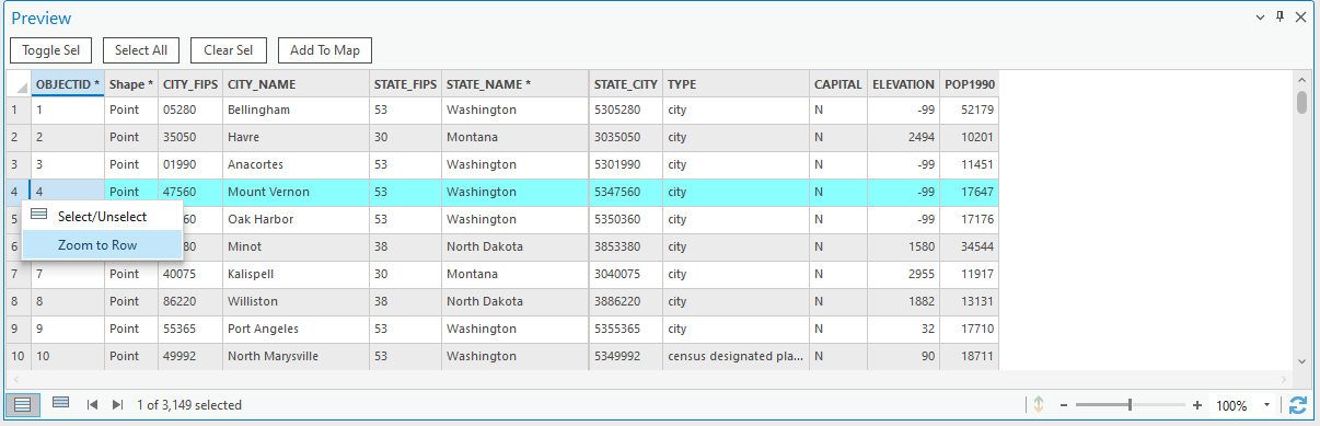

The next step is to customize the row context menu. The default row context menu for the TableControl provides one menu item to toggle the selection of the active row. We will also add the ability to zoom to the active row in the map.
First, define a resource for the context menu in the xaml file. Open TableControlDockpane.xaml and add the following so the entire UserControl.Resources at the top of the file looks like this:
<UserControl.Resources>
  <ResourceDictionary>
    <ResourceDictionary.MergedDictionaries>
        <extensions:DesignOnlyResourceDictionary Source="pack://application:,,,/ArcGIS.Desktop.Framework;component\Themes\Default.xaml"/>
    </ResourceDictionary.MergedDictionaries>
    <ContextMenu x:Key="MyRowContextMenu">
      <MenuItem Header="Select/Unselect"
                Command="editing:TableControlCommands.ToggleRowSelection">
        <MenuItem.Icon>
          <Image Source="{StaticResource TableSelectUnselect16}" Width="16" Height="16" RenderOptions.BitmapScalingMode="HighQuality"/>
        </MenuItem.Icon>
      </MenuItem>
    </ContextMenu>
  </ResourceDictionary>
</UserControl.Resources>
A new ContextMenu resource called MyRowContextMenu now exists. It contains a single menu item that executes the ToggleRowSelection TableControl command. The second command, ZoomToRow will be added in code to illustrate an alternative approach.
Bind the RowContextMenu and SelectedRowContextMenu properties in the TableControl declaration to the MyRowContextMenu resource as follows:
<editing:TableControl AutomationProperties.AutomationId="_tableControl" x:Name="tableControl"
                   Grid.Row="1" VerticalAlignment="Stretch" HorizontalAlignment="Stretch"
                   TableContent="{Binding Path=TableContent}"
                   RowContextMenu="{StaticResource MyRowContextMenu}"
                   SelectedRowContextMenu="{StaticResource MyRowContextMenu}">
</editing:TableControl>
The RowContextMenu property is the context menu for rows when in All Record view mode. The SelectedRowContextMenu is the context menu for rows when in Selected Record view mode.

          var oid = _tableControl.GetObjectIdAsync(_tableControl.ActiveRowIndex).Result;
          // load into an inspector to obtain the Shape
          var insp = new Inspector();
          insp.LoadAsync(Module1.SelectedMapMember, oid).ContinueWith((t) =>
            // zoom
            MapView.Active.ZoomToAsync(insp.Shape.Extent, new TimeSpan(0, 0, 0, 1));
    return _zoomToRowCommand;
This block of code uses the GetObjectIdAsync method passing the ActiveRowIndex to retrieve the objectID of the active row. Load an Inspector object with this objectID and the stored MapMember to obtain the Shape. Use the ZoomToAsync method on the active mapView to zoom to that extent.
Build the sample and fix any compile errors. Debug the add-in and start ArcGIS Pro. Open the previous project. Load data from the Community Samples Data. Click the 'Add to Map' button for your data to be added to the active map. When you right click on a row in the TableControl you should see the custom context menu. Choose the 'Zoom to Row' option and the map will zoom to that record.

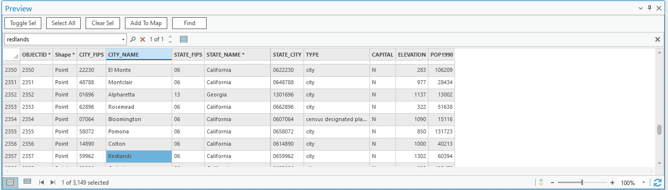

Return to the TableControlDockpane.xaml file. We will add one more button to the DockPanel to illustrate the Find functionality. Add the following Button to the end of the DockPanel tag.
<Button Content="Find" Command="editing:TableControlCommands.Find"
The entire DockPanel tag should look like the following.
    </DockPanel>
Compile and debug the add-in. Open the previous project and load data from the Community Samples Data. Click the Find button and see the Find UI display. Highlight a field header, type in the Find text field and click Enter to execute the Find functionality.
