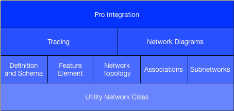

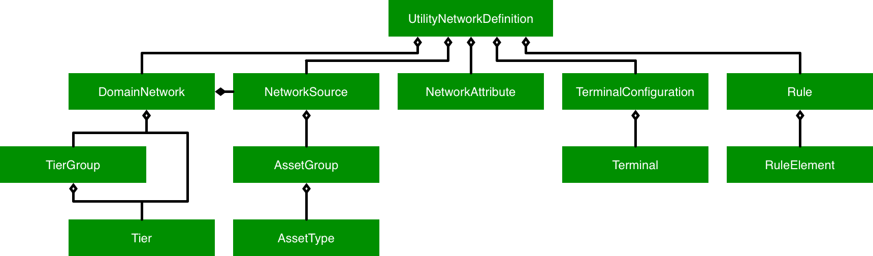

This topic logically divides the API into nine sections. The following diagram provides a functional organization of the API. The API itself is a collection of classes and is not technically a layered architecture.
  • The UtilityNetwork class is the root object that provides access to the utility network API.
  • The Definition and schema section describes the classes and methods that provide information about the utility network schema.
  • The Element class covers the basic encapsulation of a row in the utility network API.
  • Network topology covers routines that query the topological index.
  • Associations covers routines that query and edit associations between utility network rows.
  • Subnetworks provides classes and routines to query and edit utility network subnetworks.
  • Tracing provides tracing functionality.
  • Network diagrams allow you to query and edit network diagrams.
  • Finally, Pro integration describes how the utility network API integrates with other parts of the Pro SDK.
An object model diagram of the utility network API is provided on the website.
The UtilityNetworkDefinition class provides metadata information about the utility network. This class is the entryway to a collection of additional classes that provide metadata about elements in the utility network, such as domain networks and rules. The classes described in this section are all lightweight, value-based objects that are derived from information cached with the feature service.
For more information on the concepts implemented by these objects, see the Utility Network Concepts section of the online help.
  • The utility network is described by the UtilityNetworkDefinition class. This class also serves as the central hub for the definition and schema classes.
  • Every utility network consists of one or more domain networks.
  • Domain networks contain tiers.
  • Every utility network also contains a set of NetworkSource classes. These classes describe the sources of data for the utility network (usually feature classes).
  • Every table that serves as a network source contains asset groups, which contain asset types.
  • Utility networks also contain a set of network attributes.
  • Terminal configurations of a utility network are described by the TerminalConfiguration and Terminal classes.

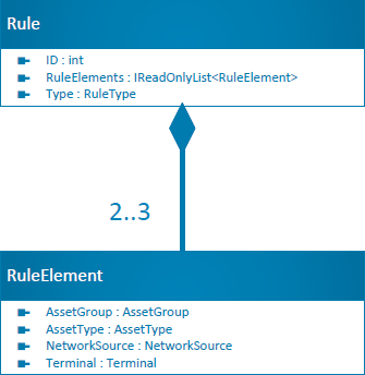

  • Finally, the rules of a utility network are described by the Rule and RuleElement classes.

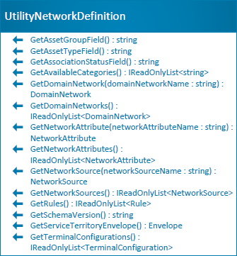

The UtilityNetworkDefinition class follows the same access pattern used by other definition classes in the geodatabase API.
As with other definition classes, there are two options for accessing UtilityNetworkDefinition:
  • Open the UtilityNetworkDefinition from a geodatabase. Typically, this is used when it is not anticipated that the utility network will be opened.
UtilityNetworkDefinition definition = geodatabase.GetDefinition<UtilityNetworkDefinition>("UtilityNetworkName");
  • Open the UtilityNetworkDefinition directly from the UtilityNetwork. This is used when the dataset is already open and the reference is accessible.
UtilityNetworkDefinition definition = utilityNetwork.GetDefinition();
Most of the methods on this class are described in the sections that follow. Additional methods are detailed below:
  • GetAssetGroupField() returns the field name that stores the asset group of a row.
  • GetAssetTypeField() returns the field name that stores the asset type of a row.
  • GetAssociationStatusField() returns the field name of the association status field.
  • GetAvailableCategories() returns a list of the categories that have been set on the utility network using the Add Category geoprocessing tool. Categories are strings that serve as tags to identify asset types in a data model-independent fashion.
  • GetSchemaVersion() returns a string representation of the version of the utility network schema.
  • GetServiceTerritoryEnvelope() returns the extent of the utility network (that is, the extent of the service territory polygon, plus 10 percent).

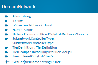

Domain networks
A domain network represents a type of utility service that an organization provides. Domain networks can represent different levels of the same utility resource, such as distribution and transmission levels for gas, water, or electricity. Domain networks can also represent multiple types of commodities, such as natural gas and electricity. In addition, every utility network contains a domain network for the structure network.
Calling UtilityNetworkDefinition.GetDomainNetworks returns a read-only list of DomainNetwork objects. Calling UtilityNetworkDefinition.GetDomainNetwork returns the DomainNetwork object with a specific name.
Domain networks can return lists of network sources (DomainNetwork.NetworkSources) and tiers (DomainNetwork.Tiers). Additional properties on the DomainNetwork class are as follows:
Property Description
IsStructureNetwork Returns whether this domain network represents the structure network.
SubnetworkControllerCategory Returns the type of subnetwork controllers supported in this domain network. Valid values in the SubnetworkControllerCategory enum are Source, Sink, and None (for structure networks).
TierDefinition Returns the type of subnetworks supported in this domain network. Valid values in the TierDefinition enum are Hierarchical (typically used with pressure networks) and Partitioned (typically used with electrical networks).

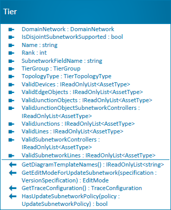

Tiers and Tier Groups
Tiers model the hierarchy of how the network delivers a resource such as natural gas, electricity, or water. A tier typically represents a pressure or voltage level. For example, an electric distribution system can be subdivided into subtransmission, medium-voltage, and low-voltage levels and some types of analysis should be performed only within one of these levels. A tier can also represent parts of the network that can be isolated from one another such as a valve isolation zone in a pressure-based system. Tiers are useful because they allow you to constrain the valid row types for each tier, and they can also define the extent of network tracing analysis.
Tier objects can be obtained with the DomainNetwork.Tiers property, which returns a list of all of the tiers on the DomainNetwork, or with the DomainNetwork.GetTier method, which returns a single tier by name.
The following code demonstrates how to find a "Medium Voltage" tier from an "Electric Distribution" domain network:
using (UtilityNetworkDefinition utilityNetworkDefinition = utilityNetwork.GetDefinition())
  DomainNetwork domainNetwork = utilityNetworkDefinition.GetDomainNetwork(domainNetworkName);
  Tier tier = domainNetwork.GetTier(tierName);
When tiers are created using the Add Tier geoprocessing tool, several collections of asset types must be provided. These asset types can be retrieved by the following sets of properties:
ValidDevices The device asset types that can be included within subnetworks in this tier
ValidEdgeObjects The edge object asset types that can be included within subnetworks in this tier
ValidJunctionObjects The junction object asset types that can be included within subnetworks in this tier
ValidJunctionObjectSubnetworkControllers The junction object asset types that can serve as subnetwork controllers within this tier
ValidJunctions The junction asset types that can be included within subnetworks in this tier
ValidLines The line asset types that can be included within subnetworks in this tier
ValidSubnetworkControllers The asset types that can serve as subnetwork controllers within this tier
ValidSubnetworkLines The asset types that are used to build features in the SubnetLine feature class when updating the subnetwork
Other subnetwork properties and methods on the Tier class are as follows:
Property or Method Description
DomainNetwork Returns the DomainNetwork that contains this tier.
GetDiagramTemplateNames() Returns the names of the subnetwork diagram templates for this tier.
GetEditModeForSubnetwork Whether events are fired when updating subnetworks for this tier for a particular version type. Events control whether attribute rules fire.
HasUpdateSubnetworkPolicy Whether containers and structures are updated when updating subnetworks.
IsDisjointSubnetworkSupported A disjoint subnetwork contains at least one subnetwork controller that cannot be traversed from its other subnetwork controllers. If this property is false, and the subnetwork is disjointed, calling Subnetwork.Update() will result in an error.
SubnetworkFieldName The name of the field that stores the subnetwork name.
TopologyType The type of subnetworks that are supported. Valid values are Radial, and Mesh.
TraceConfiguration The trace configuration that was set by the Set Subnetwork Definition geoprocessing tool.

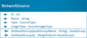

Network source objects can be obtained with the GetNetworkSource() and GetNetworkSources() methods on the UtilityNetworkDefinition class, as well as from the NetworkSources property on the DomainNetwork class. GetNetworkSource() is used to return a single NetworkSource by name, while GetNetworkSources() returns a list of all the network sources on the UtilityNetworkDefinition or DomainNetwork.
The UsageType property describes how the table is used in the network. Possible values are Device, Junction, Line, Assembly, SubnetLine, StructureJunction, StructureLine, StructureBoundary, SystemJunction, Association, JunctionObject, EdgeObject, StructureJunctionObject, and StructureEdgeObject.
Finally, the GetAssetGroup and GetAssetGroups methods return the asset groups for this particular network source. GetAssetGroup returns a single asset group by name, while GetAssetGroups returns a list of asset groups.

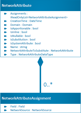

Network attributes
Network attributes are values that are stored for each row in the underlying network topology. The values are read from database attributes and are stored in the topology when it is validated. They can then be accessed directly from the topology without requiring an additional fetch of the corresponding database row, resulting in significant performance benefits when used with tracing. The same network attribute can be assigned to different tables. Some example network attributes are life cycle status, phase, and valve position.
Network attribute objects can be obtained with the GetNetworkAttribute and GetNetworkAttributes methods on the UtilityNetworkDefinition class. GetNetworkAttribute returns a single network attribute by name, while GetNetworkAttributes returns a list of all the network attributes. They provide a number of properties that describe the network attribute. The Assignments property returns a list of NetworkAttributeAssignment objects. The NetworkAttributeAssignment class provides a mapping between network attributes and database fields. The Type property specifies the data type of the network attribute, NetworkAttributeDataType, which has Date, Double, Long, and Short types.

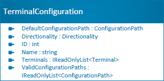

A terminal configuration can be assigned to one or more asset types. The TerminalConfiguration objects in a system can be obtained using the GetTerminalConfigurations() method on the UtilityNetworkDefinition class. The GetTerminalConfiguration() method on an AssetType object returns the terminal configuration assigned to that specific asset type.
The TerminalConfiguration class includes a Terminals property that returns a list of terminals.
Each terminal is defined by an ID, a name, and an IsUpstreamTerminal property. This property returns whether this terminal is on the upstream side of a device. As you might expect, in source-based networks, upstream is toward the subnetwork controller. In sink-based networks, upstream is away from the subnetwork controller.

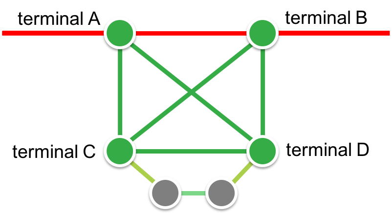

Configuration Paths

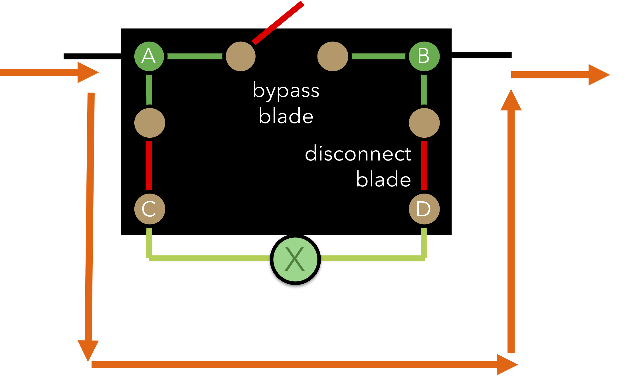

Terminal configurations can contain one or more configuration paths, which specify a flow path through terminals. Configuration paths can only be specified for devices with fewer than five terminals. Configuration paths can specify whether flow through them is one-way or bidirectional.
Each configuration path contains a set of TerminalPath objects, which designate a flow path between a pair of terminals. If the Description field is set to the hard-coded value "All", the TerminalPaths parameter will be empty, but there is an implied set of flow paths linking each terminal to every other terminal in the device.

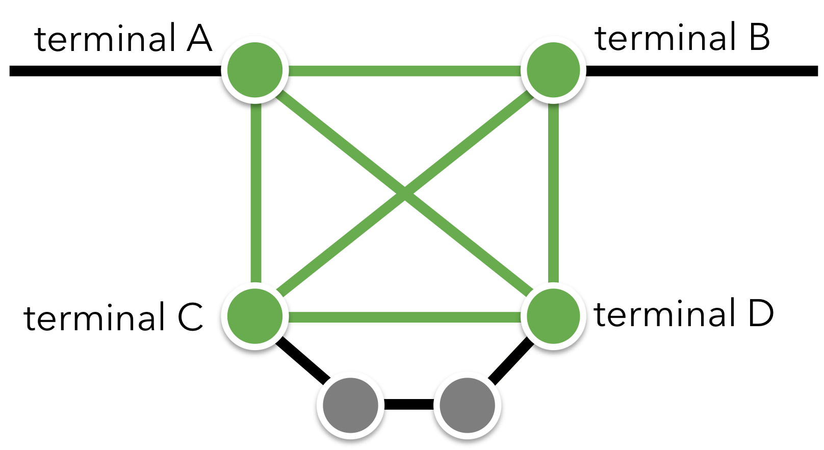

Consider the example of a bypass switch, which is used in conjunction with an electrical device such as a voltage regulator. In normal operation, the blades inside of a bypass switch are configured to allow power to flow through the voltage regulator (represented below as a circle with an 'x').
When the voltage regulator is taken out of service, the disconnect blades are opened and the bypass blade is closed, isolating the voltage regulator from electrical current.
Drawn graphically, the terminal configuration looks like the following, where the green circles are the terminals on the bypass switch and the gray circles represent the voltage regulator.
Using pseudo-code, the TerminalConfiguration object looks like the following:
Name = “Bypass Switch”
Terminals = { terminalA, terminalB, terminalC, terminalD }
ValidConfigurationPaths = { NormalOperation, Bypass }
DefaultConfigationPath = NormalOperation
The NormalOperation configuration path looks like the following:
Name = NormalOperation
TerminalPaths =
  { terminalA, terminalC },
  { terminalD, terminalB }
When in this configuration, terminalA is connected to terminalC and terminalB is connected to terminalD.

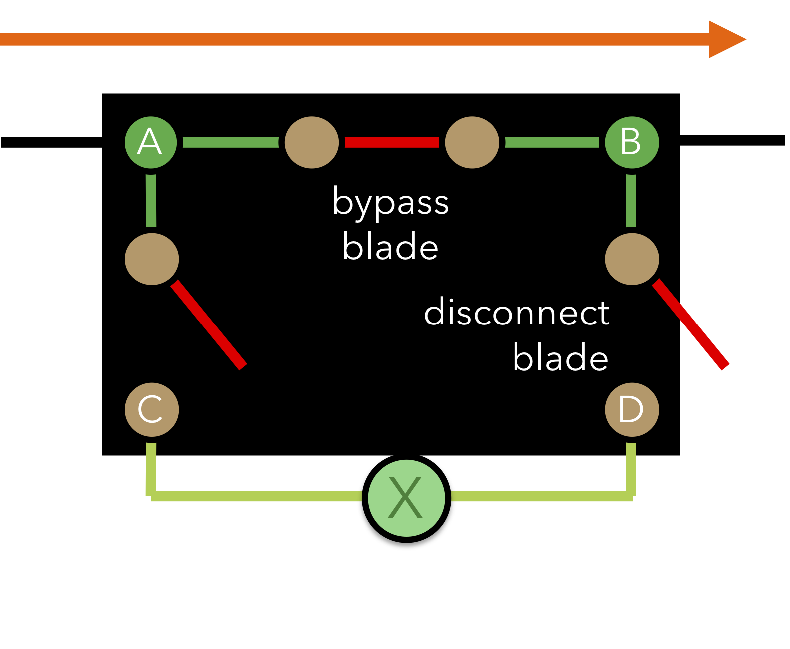

For Bypass, the configuration path looks like the following:
Name = ”Bypass”
TerminalPaths =
  { terminalA, terminalB }
When in this configuration, terminalA is connected to terminalB.

Rules define the associations that can be created from the different asset types in a utility network. There are three broad types of association rules:
  • Connectivity rules enforce the types of rows that can be connected.
  • Structural attachment rules enforce the types of rows that can be attached to a structure.
  • Containment rules enforce the types of network rows that can be contained in container rows.
The UtilityNetworkDefinition.GetRules() method returns a list of rules.
Rules are composed of two or three rule element objects, which are accessed through the RuleElements property. The meanings of the rule elements vary depending on the type of rule:
Type of Rule Meaning of Rule Elements
Junction-Junction Connectivity The first rule element represents the from junction. The second rule element represents the to junction. For both of them, the Terminal property is optional.
Junction-Edge Connectivity The first rule element represents the junction, with an optional Terminal property. The second rule element represents the edge (Terminal property is undefined).
Edge-Junction-Edge Connectivity The first rule element represents the first edge. If the Terminal property is present, it indicates the terminal on the junction that the first edge can connect to. The second rule element represents the second edge. If the Terminal property is present, it indicates the terminal on the junction that the second edge can connect to. The third rule element represents the junction (Terminal property is undefined).
Containment The first rule element represents the container, and the second rule element represents the content. The Terminal property on both objects is undefined.
Structural Attachment The first rule element represents the structure, and the second rule element represents the attachment. The Terminal property on both objects is undefined.

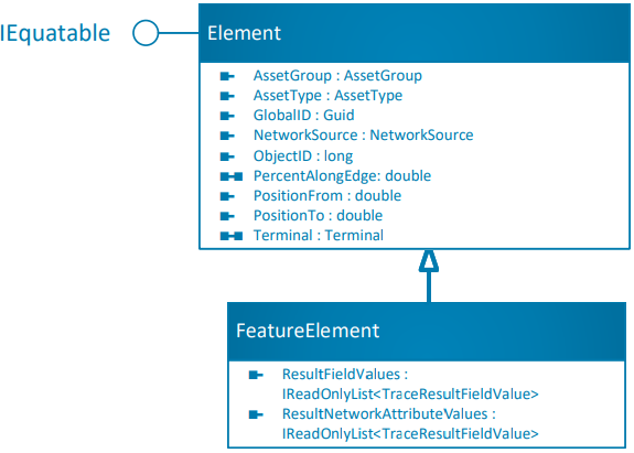

Element class
The Element class represents a row in a utility network, plus a terminal (if applicable). These value objects are used across the utility network SDK. Places where Element is used are as follows:
  • Elements are used to create and delete associations.
  • Elements specify starting points and barriers for use with tracing.
  • Elements are returned as results from traces.
Elements are created using the CreateElement() factory methods on the UtilityNetwork class.
If an Element object represents an edge and is being used as input for a trace, the PercentAlongEdge property can be used to specify the exact starting point along the edge (0.5 represents a starting point 50% along the edge, starting at the to junction).
When creating a utility network feature, you should always specify which subtype to use when creating the row buffer. This will ensure the row is initialized with all the expected default values for that subtype. Failure to do so may result in unexpected behavior with attribute rules, contingent values, or other configurations that expect default values for specific subtypes.
using(RowBuffer lineRowBuffer = table.CreateRowBuffer(mediumVoltageSubtype))
  lineRowBuffer["Name"] = "Overhead Line";
  using(Row lineRow = table.CreateRow(lineRowBuffer))
    Element lineElement = utilityNetwork.CreateElement(lineRow);
The ObjectID property is only set if the Element is created from a Row or is returned from a trace. Otherwise the property returns -1. Likewise, calling the CreateElement overrides that do not specify a terminal will create an Element object without a terminal (no default is set).
The FeatureElement represents a row inside a utility network returned from a trace operation with the Features result type. It is not only comprised of Element properties but also includes network and field attributes.

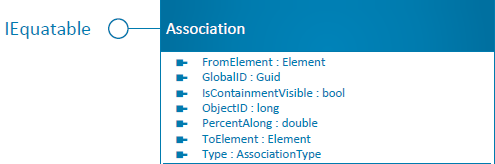

The UtilityNetwork class contains methods that query and edit associations. For editing, the UtilityNetwork class provides methods to create and delete associations. These methods should be wrapped in a transaction like other low-level editing methods.
Associations are edited by using the AddAssociation() and DeleteAssociation() methods on the UtilityNetwork class. These methods take an Association object as a parameter.
The meaning of the FromElement and ToElement properties is described in the table below.
Association Type FromElement semantics ToElement semantics
Containment Represents the container Represents the content
Structural Attachment Represents the structure Represents the attached item
Non-spatial Connectivity Represents the junction or non-spatial junction object Represents the non-spatial edge object
The IsContainmentVisible property is only used with containment associations, and the PercentAlong property is only used with junction-edge object midspan connectivity associations.
Although ideal for stand-alone applications, using these low-level methods are not recommended in an ArcGIS Pro Add-in. The map is not refreshed by these methods, and the undo/redo stack is not modified. See the Editor integration section for higher-level editing methods designed to integrate with the Pro editor.
The GetAssociations() method on the UtilityNetwork class allows associations to be returned, given a particular element.
If you wish to retrieve a set of geometries that represent the associations within a given map extent, the GetAssociationFeatures() method on the UtilityNetwork class can be used. This routine only returns geometries from connectivity associations and structural attachment associations.

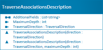

The TraverseAssociations() method on the UtilityNetwork class provides information about associations and the field values of elements involved in a traverse associations operation. It takes a set of starting elements and a TraverseAssociationsDescription object as parameters to initiate the operation.
The TraverseAssociationsDescription describes a direction (ascending or descending) and the depth for a traverse associations operation. The depth value determines the maximum number of hops through the association graph to traverse in a specified direction. By default, the depth is set to maximum for full traversal.
// Upward traversal with maximum depth
TraverseAssociationsDescription traverseAssociationsDescription = new TraverseAssociationsDescription(TraversalDirection.Ascending)
// Downward traversal with maximum depth level of 3
TraverseAssociationsDescription traverseAssociationsDescription = new TraverseAssociationsDescription(TraversalDirection.Descending, 3)
Descending in this context includes going from a container to content, going from a structure to a structural attachment, or from the From side of a connectivity association to the To side. Ascending can be used to traverse from content to containers, structural attachments to structures, or from the To side of a connectivity association to the From side. In a junction-edge association, descending is defined as traversing from the junction to the edge.
The TraverseAssociationsDescription has an AdditionalFields property that represents a list of additional field names whose values are returned in the result as field name-value pairs of elements. This allows additional data about the objects to be returned without the need for additional queries.
// List of fields whose values will be returned as name-values pairs during association traversal operation
List<string> additionalFieldsToFetch = new List<string> {“OID", "DeviceName", "AssetType", "AssetName", "AssetGroup”}
TraverseAssociationsDescription traverseAssociationsDescription = new TraverseAssociationsDescription(TraversalDirection.Ascending, 2)
AdditionalFields = additionalFieldsToFetch

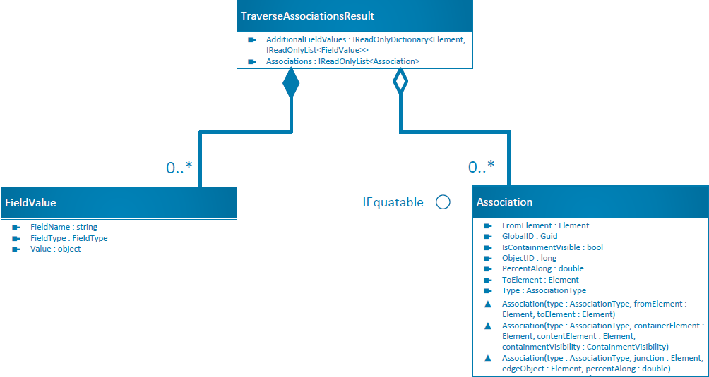

The TraverseAssociationsResult class represents a collection of associations and the mapping between involved elements and their field name-values.
// Get the traverse associations result from the starting element up to the depth defined in traverseAssociationsDescription
TraverseAssociationsResult traverseAssociationsResult = utilityNetwork.TraverseAssociations(startElements, traverseAssociationsDescription);
// List of associations participated in traversal
IReadOnlyList<Association> associations = traverseAssociationsResult.Associations;
// KeyValue mapping between involved elements and their field name-values
IReadOnlyDictionary<Element, IReadOnlyList<FieldValue>> associationElementValuePairs = traverseAssociationsResult.AdditionalFieldValues;
The FieldValue class has FieldName, FieldType, and Value properties to represent an element’s field name-value pair involved in an association.

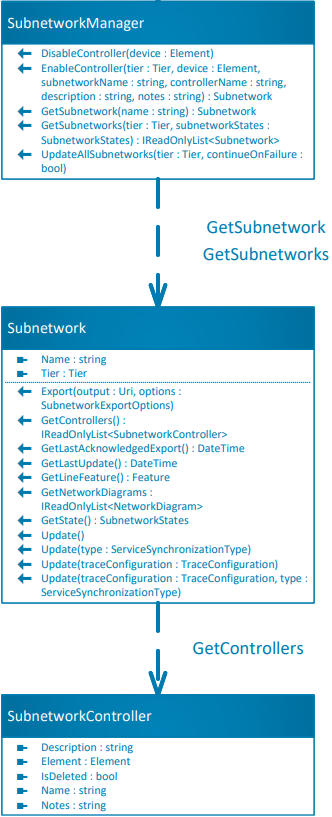

The SubnetworkManager class contains a collection of subnetwork management methods. This object is obtained by calling the GetSubnetworkManager() method on the UtilityNetwork class.

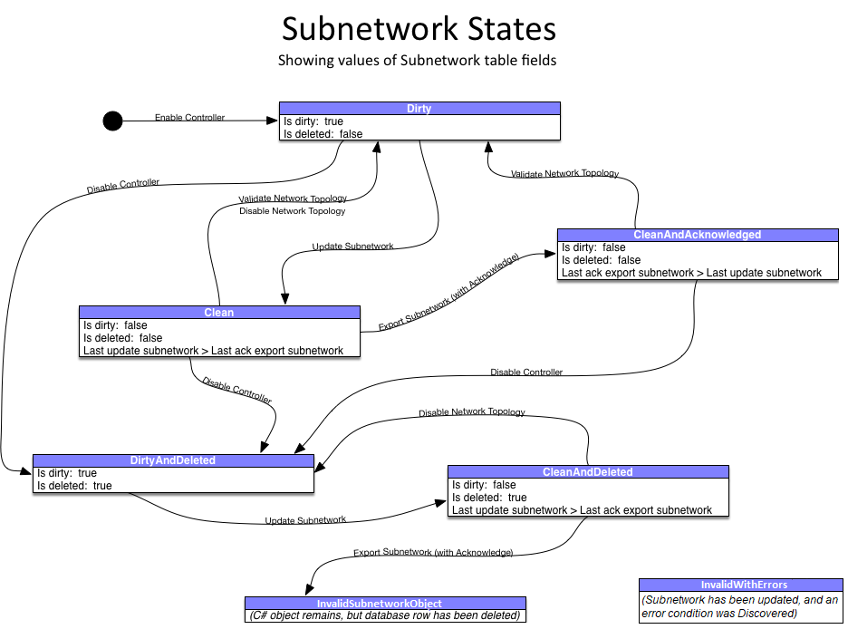

Life cycle of subnetworks and subnetwork controllers
As subnetworks are created, edited, and deleted, they transition between a complex series of states. It's worth looking at the life cycle of a subnetwork to see how this works.
The examples in this section show how to use the EnableControllerInEditOperation and DisableControllerInEditOperation, two extension methods on the SubnetworkManager class. These routines will refresh map views and create operations on the Pro operation stack. If writing a CoreHost application, the base routines EnableController and DisableController should be used instead.

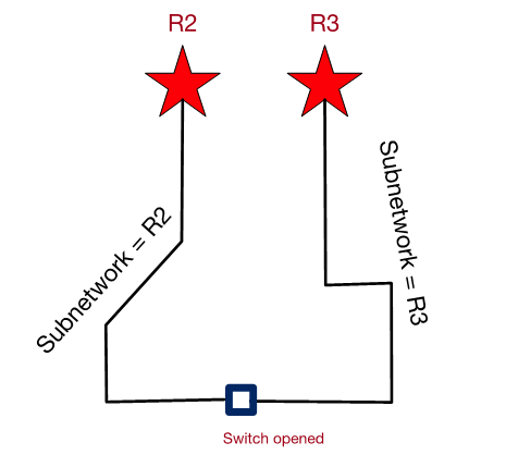

Subnetworks with only one subnetwork controller
A subnetwork is created by enabling a device as a subnetwork controller. This is accomplished through the EnableControllerInEditOperation() extension method on the SubnetworkManager class. This method returns a Subnetwork object with a state of Dirty. EnableControllerInEditOperation takes an Element as input. The Element must specify a terminal. For source-based domain networks, the terminal must not be an upstream terminal (as determined by Terminal.IsUpstreamTerminal()). For sink-based domain networks, the terminal must be an upstream terminal.
The following code sample shows how to create a simple radial subnetwork. Note that you need to give both the controller and the subnetwork a name ("R1"). Most utilities will use the same name for both.
Subnetwork R1 = subnetworkManager.EnableControllerinEditOperation(mediumVoltageTier, elementR1, "R1", "R1", "my description", "my notes");
Updating the subnetwork with the Subnetwork.Update() method changes the state of the subnetwork to Clean. It also creates a corresponding SubnetLine feature (assuming that the subnetwork contains features with one of the asset types defined in the tier definition) and updates subnetwork IDs and other propagated attributes on each network row.
R1.Update();
mapView.Redraw(true);
Editing rows in a subnetwork has no impact on the subnetwork state. However, once the topology is validated, the appropriate subnetworks are moved to the Dirty state. Again, the Subnetwork.Update() method is used to return the subnetwork to the Clean state.
At some point, a subnetwork will need to be deleted. This is accomplished through a multistep process that starts by calling the DisableControllerInEditOperation() extension method on the SubnetworkManager class. This moves the subnetwork to the DirtyAndDeleted state and marks the subnetwork controller as deleted.
subnetworkManager.DisableControllerInEditOperation(elementR1);
At this point, the subnetwork is deleted, but all of the rows that have been labeled with the subnetwork ID need to be updated. Once again, Subnetwork.Update() is called. This moves the subnetwork to the CleanAndDeleted state.
subnetworkR1.Update();
At certain points in a utility's business processes, they will want to export their subnetworks to a third-party system such as an outage management system (OMS) or a distribution management system (DMS). The Subnetwork.Export method is used to export a subnetwork. The export operation generates a JSON file based on the options described in the SubnetworkExportOptions class, and saves the resulting JSON at the provided path URI.
Finally, external systems must be updated, and this is accomplished by setting SetAcknowledged to true in the SubnetworkExportOptions. This physically deletes the subnetwork rows from the database and leaves the subnetwork in a Deleted state. At this point, calling further methods and properties on the Subnetwork object will throw an exception.
Set SetAcknowledged to true during a subnetwork export to delete the record of any subnetwork controllers from the subnetworks table that have been removed as a subnetwork controller. The SetAcknowledged is not necessary if there are no controllers that need to be deleted from the subnetworks table.

Advanced case: Multifeed radial networks
Many utilities prefer to name their multifeed subnetworks by concatenating the names of the control devices that feed it. This must be done manually by passing in “R2, R3” as an input argument as shown below.
subnetworkManager.EnableControllerInEditOperation(mediumVoltageMultifeedTier, elementR2, "R2, R3", "R2", "my description", "my notes");
subnetworkManager.EnableControllerInEditOperation(mediumVoltageMultifeedTier, elementR3, "R2, R3", "R3", "my description", "my notes");
If a multifeed network is split into two, the original subnetwork controllers must be disabled and re-enabled with different names.
subnetworkManager.DisableControllerInEditOperation(elementR2);
subnetworkManager.DisableControllerInEditOperation(elementR3);
Subnetwork subnetworkR2 = subnetworkManager.EnableControllerInEditOperation(mediumVoltageTier, elementR2, "R2", "R2", "my description", "mynotes");
Subnetwork subnetworkR3 = subnetworkManager.EnableControllerInEditOperation(mediumVoltageTier, elementR3, "R3", "R3", "my description", "mynotes");
subnetworkR2.Update();
subnetworkR3.Update();
Summary of subnetwork states
Value Description
Dirty Changes have been made to rows in the subnetwork.
Clean Update() has been run subsequent to any edits made to the subnetwork.
CleanAndAcknowledged Export with the SetAcknowledged flag has been run after Update() and before additional edits.
DirtyAndDeleted All subnetwork controllers have been dropped from the subnetwork, but Update() has not yet been run.
CleanAndDeleted All subnetwork controllers have been dropped from the subnetwork, Update() has been run, but Export() has not been run with the SetAcknowledged flag. Once a subnetwork is in this state, running Export() with the SetAcknowledged flag will delete the subnetwork.
InvalidSubnetworkObject The subnetwork has been completely deleted (no database rows exist), but the subnetwork object remains. Once a subnetwork is in this state, most properties and methods will throw an exception.
InvalidWithErrors The subnetwork has been updated, and an error condition was discovered. Once the subnetwork is in this state, it cannot be updated until edits have been made to correct the error condition and validation has been run successfully.
All A combination of the values in this list; provides an easy way to fetch all of the subnetworks in a tier.

The SubnetworkManager.EnableControllerInEditOperation() and SubnetworkManager.DisableControllerInEditOperation() extension methods perform their own transaction management. Because of this, they cannot be called from within another edit operation. In a CoreHost application, the base EnableController() and DisableController() methods also perform their own transaction management. If they are called inside Geodatabase.ApplyEdits(), an exception will be thrown.
The Subnetwork.Update() method has the same restrictions, and one more. Because the edits produced by this method cannot be undone, it cannot be called from within an edit transaction. All edits must be saved or reverted prior to calling this method.
A similar transaction restriction applies to subnetwork export. When calling Subnetwork.Export with SubnetworkOptions.SetAcknowledged set to True inside Geodatabase.ApplyEdits(), an exception will be thrown.
Enabling and disabling controllers create dirty areas; updating a subnetwork does not.
As shown in the examples above, after updating a subnetwork, ArcGIS.Desktop.Mapping.MapView.Redraw(true) should be called to refresh the display cache and redraw the map.
Updating All Dirty Subnetworks
In addition to updating subnetworks individually with Subnetwork.Update(), the API also allows all dirty subnetworks to be updated at once using the SubnetworkManager.UpdateAllSubnetworks() method. This routine takes a tier and a boolean that specifies whether processing should continue on subsequent subnetworks if a failure is encountered.
The following code example shows how to update all of the dirty subnetworks in a tier:
using (SubnetworkManager subnetworkManager = utilityNetwork.GetSubnetworkManager())
  subnetworkManager.UpdateAllSubnetworks(tier, true);
Retrieving subnetworks
Existing subnetworks can be retrieved by calling the GetSubnetworks() method on the SubnetworkManager object. The method takes a tier parameter, as well as a SubnetworkStates value, which can include multiple values or'd together. This method returns a list of subnetwork objects. Alternatively, the GetSubnetwork() method can be called. This method takes a string, which represents a subnetwork name.
In addition to a number of properties, the Subnetwork class also contains the Update() method described above. Other methods include GetControllers(), which returns a list of subnetwork controller objects, and GetLineFeature(), which returns the SubnetLine feature that corresponds to this subnetwork.

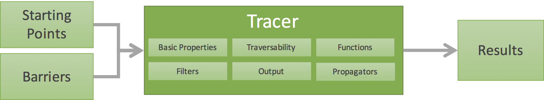

Architecture of a trace
Many different classes work together to define and execute a trace:

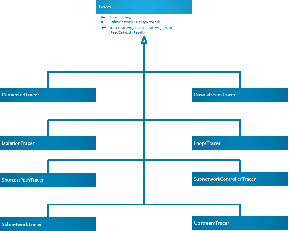

Tracers
Tracers define the tracing algorithm to be used. Tracer is an abstract base class with distinct subclasses implementing specific tracing algorithms.

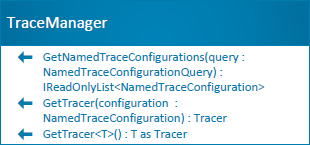

Tracer objects are created using TraceManager. The TraceManager class is a central hub to the tracing portions of the API. TraceManager objects are obtained through a call to UtilityNetwork.GetTraceManager().
The GetTracer<T>() method on the TraceManager class returns a tracer of a specific type as shown in the following code:
using (TraceManager traceManager = utilityNetwork.GetTraceManager())
  DownstreamTracer downstreamTracer = traceManager.GetTracer<DownstreamTracer>();
Likewise, the GetTracer(NamedTraceConfiguration) method on the TraceManager class returns a tracer based on the NamedTraceConfiguration as shown below.
	NamedTraceConfigurationQuery namedTraceConfigurationQuery = new NamedTraceConfigurationQuery { Names = new List<string> { "Upstream"} };
	IReadOnlyList<NamedTraceConfiguration> namedTraceConfigurations = traceManager.GetNamedTraceConfigurations(namedTraceConfigurationQuery);
	NamedTraceConfiguration upstreamTraceConfiguration = namedTraceConfigurations.FirstOrDefault();
	Tracer upstreamTracer = traceManager.GetTracer(upstreamTraceConfiguration);

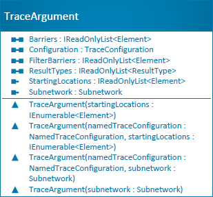

The TraceArgument class consolidates trace parameters. Different tracers, including custom tracers, may subclass TraceArgument. The base TraceArgument class contains properties for starting locations, barriers, filter barriers, result types, and a trace configuration.
Starting locations are Elements that specify the starting point of a trace, while barriers and filter barriers (both also Elements) prevent a trace from continuing.
Barriers work by preventing traversability, which is done during the initial phase of a trace. With subnetwork-based traces, they can prevent traversability to the subnetwork controller. One use case for a barrier from the electric distribution domain would be placing a barrier on a switch to indicate that the switch is open. This would prevent electricity from reaching areas downstream of that switch.
Filter barriers are evaluated in a later pass of the tracing algorithm and can be used to restrict the returned result set without impacting the ability to find the subnetwork controller from a starting point. One use case for a filter barrier in the gas distribution domain would be to simulate the location of a squeeze-off when executing a valve isolation trace. The user could place a filter barrier at the proposed location of the squeeze-off and then verify its impact.
In the absence of barrier and filter barrier elements, users would have to switch to a version, edit features, and then validate network topology in order to perform this kind of what-if analysis.
The trace configuration is explained later in this topic.
The ResultTypes property allows you to specify one or more result formats to return. Currently implemented values are Element, which returns a set of elements, and FunctionValue, which returns a set of function calculation results.
Future software versions may implement additional result types. Possible result types that may be supported in the future include propagator values per row, connectivity information, network diagrams, geometry, and additional network attributes.

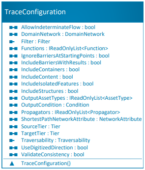

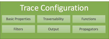

Trace configuration
The TraceConfiguration object contains all of the other inputs to a trace.
The properties in the TraceConfiguration object can be categorized as follows:
Basic properties
The following table lists the basic properties in the TraceConfiguration object and their descriptions:
AllowIndeterminateFlow Determines whether elements inside a loop are returned with subnetwork trace results. The default is true.
IncludeContainers Includes containers of trace results in the result set. IncludeContainers is recursive. If set to true, if a result element is inside a nested container, both containers are returned. The default is false.
IncludeContent Includes content of trace results in the result set. IncludeContent is recursive. If set to true, if a result element contains other elements that are themselves containers, the contents of the nested containers are also returned. The default is false.
IncludeStructures Includes structures with attachments that are trace results in the result set. The default is false.
IncludeBarriersWithResults Determines whether the row that met one of the barrier criterion (described in the Traversability and Filter sections below) is included in the trace results. For example, it is typical to include an open switch when performing an electric circuit trace, so in these cases, the property should be set to True.
IncludeIsolatedFeatures Determines whether or not the isolated features are returned with trace results. The default is false, which only returns those features that stop the trace (e.g., valves).
IgnoreBarriersAtStartingPoint Determines whether or not barriers at starting points are ignored. One typical use case is performing an upstream trace, stopping at each protective device. Each subsequent trace would use as a starting point the end point of the previous trace. Without this setting, subsequent traces would stop at the starting point, and not return any results. The default is false.
ShortestPathNetworkAttribute This property is only used by ShortestPathTracer and is used by that tracer to determine the shortest path. Typically, shape length is used. However, other network attributes can be used to calculate cost. For example, if you are looking for the shortest path through an underground system, you might prefer a longer path via duct banks versus a shorter path through a trench that requires excavation.
DomainNetwork The DomainNetwork property is required and only used with subnetwork-based tracers.
SourceTier This property is only used with subnetwork-based traces. If DomainNetwork represents a partitioned network, the SourceTier property is optional. If DomainNetwork represents a hierarchical network, the SourceTier property is required. Since rows in hierarchical networks can belong to multiple tiers, this property notifies the tracer which tier to use for tracing. If this property is included, the trace code will perform an additional check to validate that the starting points and barriers belong to this tier.
TargetTier If this optional property is included, upstream and downstream traces will continue into the specified tier. If the property is null, upstream and downstream traces will stop in the current tier (that is, at subnetwork controllers).
UseDigitizedDirection Indicates whether a trace will use the flow direction. The default is False.
ValidateConsistency If set to true, the trace code will perform additional checks. If the trace encounters a dirty area, an exception is thrown from Trace(). The default is True.
IncludeContainers and IncludeStructures are transitive. In other words, if they are both true, if a container contains a result element and that container is attached to a structure, the structure is returned even if the result element is not directly attached to the structure.

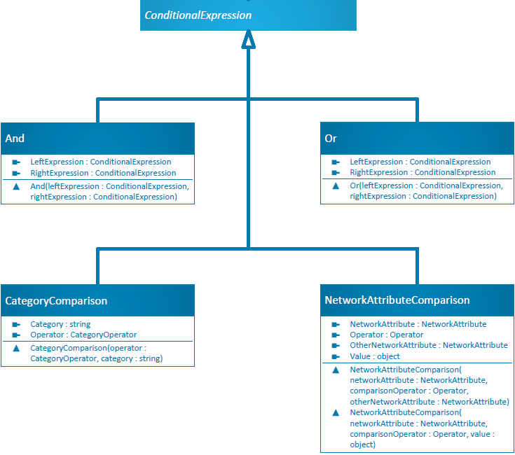

Conditions
The Condition class is an object that evaluates to true or false. Currently there is a single subclass of Condition called ConditionalExpression.
If the visited row meets the criteria of the comparison, traversal is stopped. If the visited row does not meet the criteria, that row is not included in the results. A null condition always permits traversal.
There are two basic comparisons as follows:
  • The NetworkAttributeComparison class is based on comparison with a network attribute. This network attribute can be compared to a specific non-null value or a second network attribute.
  • The CategoryComparison class checks the asset type of the row to establish if it implements a specific category.
These filters can be combined using the And and Or classes to form more complex filters.
The following code shows how to build a condition that stops when traversal encounters a row with a Lifecycle network attribute that contains a value other than InDesign or InService.
const int InDesign = 4;
const int InService = 8;
using (NetworkAttribute lifecycleNetworkAttribute = utilityNetworkDefinition.GetNetworkAttribute("Lifecycle"))
  // Create a NetworkAttributeComparison that stops traversal if Lifecycle <> "In Design" (represented by the constant InDesign)
  NetworkAttributeComparison inDesignNetworkAttributeComparison = new NetworkAttributeComparison(lifecycleNetworkAttribute, Operator.NotEqual, InDesign);
  // Create a NetworkAttributeComparison to stop traversal if Lifecycle <> "In Service" (represented by the constant InService)
  NetworkAttributeComparison inServiceNetworkAttributeComparison = new NetworkAttributeComparison(lifecycleNetworkAttribute, Operator.NotEqual, InService);
  // Combine these two comparisons together with "And"
  And lifecycleFilter = new And(inDesignNetworkAttributeComparison, inServiceNetworkAttributeComparison);
  // Final condition stops traversal if Lifecycle <> "In Design" and Lifecycle <> "In Service"
  traceConfiguration.Traversability.Barriers = lifecycleFilter;

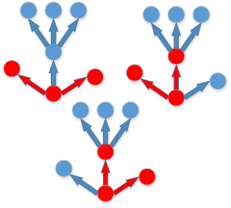

Here is another example. In the following diagram, the red junction is the starting point. Assume that all lines have a traversal value of 1, and the function barrier specifies that traversal stops when the value equals 2.
Using global values, any of these could be returned depending on how the edges are ordered in the network topology.
Using local values, the following result is returned:
Most applications will use local values. Note that the global value is the single value returned when specifying functions as return values as described in the next section.

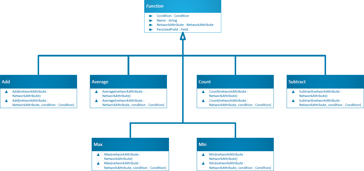

Individual functions are implemented as subclasses of the Function abstract class.
Function Description
Add Sums the value of the network attribute for each applicable row
Subtract Takes the network attribute value from the starting point as the base number and subtracts the value of the network attribute for each applicable row
Average Averages the value of the network attribute for each applicable row
Count Counts the number of applicable rows
Min Minimum value of the network attribute for each applicable row
Max Maximum value of the network attribute for each applicable row

Bitset filter
There are cases where traces need to be aware that a network attribute is a bit set that controls traversability. Consider the following network, where phase is represented as a bit set network attribute (one bit per phase), and overhead electrical devices are represented with one device per phase.
If you do an upstream trace from a starting point on the B-phase device with no special filter in place, the following results make sense from a graph-theory perspective. Electrically, of course, this is not the result you are looking for.
Setting the Filter.BitsetNetworkAttribute property allows the trace to return the correct results for upstream, downstream, and loop traces.

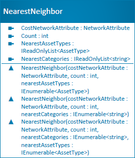

Nearest neighbor filter
The nearest neighbor filter allows you to return the next N features from the starting point. A network attribute is used to define the distance. Typically, shape length is used, but a different network attribute representing cost can be used instead. For example, if you are searching for the nearest vault in an underground structure network, you may prefer a geographically distant vault that is connected via a duct bank over a shorter route through a direct-buried trench (since excavating the trench is more costly).
The type of features to be returned can be specified by a set of Category strings, asset types, or both.
The nearest neighbor filter is defined by the NearestNeighbor class, which is assigned to the Filter.NearestNeighbor property.

Named trace configurations can also be obtained from a TraceManager, as shown in the following code:
  // Query to find named trace configurations whose name is 'UpstreamTrace'
  NamedTraceConfigurationQuery namedTraceConfigurationQuery = new NamedTraceConfigurationQuery {Names = new List<string> { “UpstreamTrace” } };
  // A set of named trace configurations specified by the named trace configuration query
The NamedTraceConfigurationQuery class defines a filter to find named trace configurations based on creators, GlobalIDs, names, or tags.

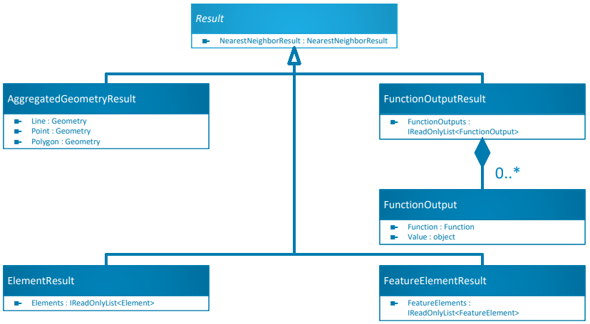

Trace results
The Trace() method on Tracer classes returns a set of Result objects. One Result object is returned for each ResultType specified in TraceArgument.ResultTypes.
Result is an abstract class. One distinct subclass exists for each member of the ResultTypes enum.
The Result base class has a single property. If the TraceConfiguration.Filter object contained a NearestNeighbor object, the NearestNeighborResult property returns whether or not the correct number of rows were returned.
The current release supports the following subclasses of Result:
  • ElementResult contains a list of Element objects that meet the tracing criteria.
  • FeatureElementResult contains a list of FeatureElement objects that meet the tracing criteria. These objects are used to include network attribute and other field values with the trace result.
  • FunctionOutputResult contains a list of FunctionOutput objects. One FunctionObject is returned for each function assigned to TraceConfiguration.Functions. The FunctionOutput class is a set of function-value pairs.
  • AggregatedGeometryResult contains a list of geometries. The Line property contains the union of all of the linear features included in the result set. Likewise, the Point property contains the union of all of the point features, and the Polygon property contains the union of all of the polygonal features included in the result set. Returning geometries requires ArcGIS Enterprise 10.8.1 or later.
This code shows how to get the result of the function that was created earlier in this topic to sum the Load attribute.

    // Create comparison to stop traversal if the specified phase isn't found
    NetworkAttribute normalPhasesNetworkAttribute = definition.GetNetworkAttribute("PhasesNormal");
    NetworkAttributeComparison phaseComparison = new NetworkAttributeComparison(normalPhasesNetworkAttribute, Operator.DoesNotIncludeTheValues, phaseValue);
    // Create comparison to stop traversal at open devices
    NetworkAttribute deviceStatusAttribute = definition.GetNetworkAttribute("Device status");
    NetworkAttributeComparison deviceStatusComparison = new NetworkAttributeComparison(deviceStatusAttribute, Operator.Equal, DeviceStatusOpen);
    // Combine these two comparisons and assign it
    Condition terminationCondition = new Or(phaseComparison, deviceStatusComparison);

TraceConfiguration class in other contexts
In addition to its use with tracing, the TraceConfiguration class is used in other places in the API. This section describes how its use differs from tracing.
TraceConfiguration on the Tier class
A TraceConfiguration is obtained from the GetTraceConfiguration method on the Tier class. It is assigned by the Set Subnetwork Definition geoprocessing tool where it defines the defaults used by subnetwork traces, updates, and exports.
Not all of the TraceConfiguration properties apply in this scenario. Nonapplicable properties are left empty as shown in the following table:
Property Applicable
DomainNetwork
Filter
Functions ✔
IncludeBarriersWithResults ✔
IncludeContainers
IncludeContent
IncludeStructures
OutputAssetTypes
OutputCondition
Propagators ✔
SourceTier
TargetTier
Traversability ✔
ValidateConsistency
Propagated values are stored on domain network feature classes during the Update Subnetwork process. The field used is designated by the Propagator.PersistedField property.
Similarly, the Function property is used to store subnetwork summaries. These are computed during Update Subnetwork and stored on the SubnetLine feature class. The field used is designated by the Function.PersistedField property.
TraceConfiguration with Subnetwork.Update()
Subnetwork.Update() typically uses the default tracing configuration represented by Tier.GetTraceConfiguration(). However, an override of Subnetwork.Update() allows this default trace configuration to be overridden.
Not all the TraceConfiguration properties apply in this scenario as shown in the following table below:
Property Applicable
DomainNetwork
Filter
Functions
IncludeContainers
IncludeContent
IncludeStructures
OutputAssetTypes
OutputCondition
Propagators ✔
SourceTier
TargetTier
Traversability ✔
ValidateConsistency

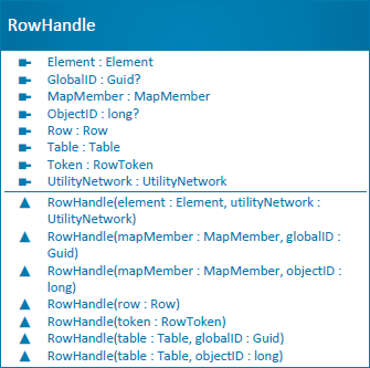

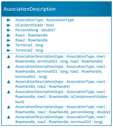

Editing associations with EditOperation
The EditOperation class has been extended with methods to create and delete associations. New overloads to EditOperation.Create() and EditOperation.Delete() take association description objects. These objects describe a connectivity, containment, or structure attachment association to create or delete.
As shown in the class diagram above, association description objects are created with RowHandle objects. The RowHandle class describes a row that is involved in creating or deleting an association. Row handles can be created using the following inputs:
  • UtilityNetwork and Element
  • MapMember and GlobalID
  • MapMember and ObjectID
  • Row
  • RowToken (described in the following section)
Creating an association description with RowHandle requires the global IDs of both features. Creating a RowHandle with only an ObjectID could cause an additional query to fetch this GlobalID. Therefore, using the other constructors is preferred.
The following code snippet demonstrates how to build a structural attachment association between a pole and a transformer bank:
// Create edit operation
EditOperation editOperation = new EditOperation();
editOperation.Name = "Create structural attachment association";
// Create a RowHandle for the pole
Element poleElement = utilityNetwork.CreateElement(poleAssetType, poleGlobalID);
RowHandle poleRowHandle = new RowHandle(poleElement, utilityNetwork);
// Create a RowHandle for the transformer bank
Element transformerBankElement = utilityNetwork.CreateElement(transformerBankAssetType, transformerBankGlobalID);
RowHandle transformerBankRowHandle = new RowHandle(transformerBankElement, utilityNetwork);
// Attach the transformer bank to the pole
AssociationDescription structuralAttachmentAssociationDescription = new AssociationDescription(AssociationType.Attachment, poleRowHandle, transformerBankRowHandle);
editOperation.Create(structuralAttachmentAssociationDescription);
editOperation.Execute();
There are many different constructors for the AssociationDescription class. The following table shows which constructors can be used with each association type.
Association Type Constructors
Containment AssociationDescription(AssociationType, RowHandle, RowHandle, isContainmentVisible: bool)
AssociationDescription(AssociationType, RowHandle, RowHandle)
Sets containment to be invisible
Structural Attachment AssociationDescription(AssociationType, RowHandle, RowHandle)
Junction-Junction AssociationDescription(AssociationType, RowHandle, RowHandle)
AssociationDescription(AssociationType, RowHandle, terminalID1: long, RowHandle)
The first junction uses terminals
AssociationDescription(AssociationType, RowHandle, RowHandle, terminalID2: long)
The second junction uses terminals
AssociationDescription(AssociationType, RowHandle, terminalID1: long, RowHandle, terminalID2: long)
Both junctions use terminals
Junction-Edge Object Connectivity From Side
Junction-Edge Object Connectivity To Side
The first junction uses terminals. Junction-edge object connectivity associations always specify the junction first
Junction-Edge Object Connectivity Midspan AssociationDescription(AssociationType, RowHandle, RowHandle, percentAlong: double)
Midspan junction-edge object connectivity associations do not support terminals. The percentAlong value should be between 0.0 and 1.0 (exclusive)
