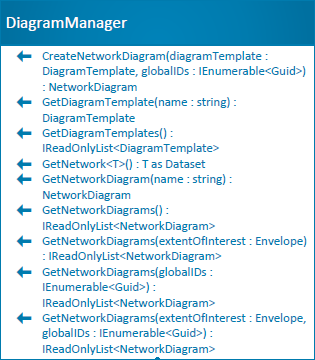

Diagram manager
The DiagramManager class serves as the core class in the network diagrams API. It can be obtained using the GetDiagramManager() method on the UtilityNetwork class.
The diagram manager can be used for the following:

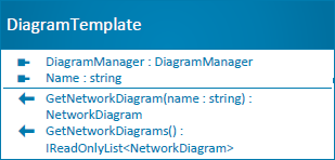

Diagram template
A DiagramTemplate contains the configuration properties that define the content (diagram rule and layout definitions) and presentation (diagram layer definitions) of a type of network diagram. If the name of a template is known, it can be obtained from the DiagramManager class using the GetDiagramTemplate() method. The GetDiagramTemplates() method on the same class returns a list of all diagram templates in the system.

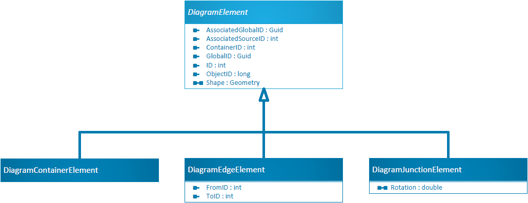

Diagram elements
A network diagram consists of a set of diagram elements that are either junctions, edges, or containers. The elements are represented by the DiagramElement class hierarchy.
The AssociatedGlobalID and AssociatedSourceID properties can be used to retrieve the corresponding utility network row. AssociatedSourceID corresponds to the ID property of the NetworkSource class.
The ID property returns the internal diagram ID of the element. The FromID and ToID properties of an edge diagram element refer to the ID of the two DiagramJunctionElements on either side. Likewise, the ContainerID property refers to the ID of the DiagramElement that is the container.

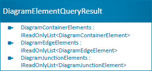

Results from diagram element queries
The DiagramElementQueryResult class returns the set of diagram elements that are returned from the query.

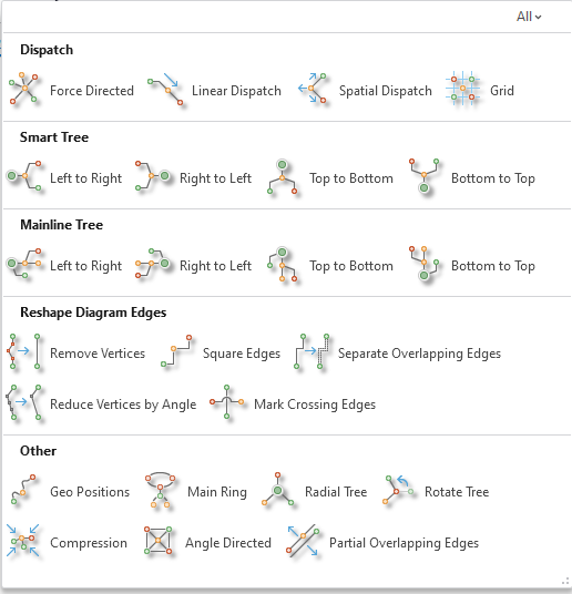

Apply a predefined diagram layout
The API provides a class hierarchy of DiagramLayoutParameters classes. The concrete subclasses each correspond to a geoprocessing tool and most correspond to a diagram layout that is available in the ArcGIS Pro user interface.
The properties in these classes are used to specify the desired layout. This parameter is then passed to NetworkDiagram.ApplyLayout() to change the layout of the diagram.
If you only want to change the layout of a subset of the diagram, you can create and use a DiagramElementObjectIDs object and also pass that to NetworkDiagram.ApplyLayout().
The collection of ObjectIDs passed to DiagramElementObjectIDs can come from a map selection or a diagram element query.
