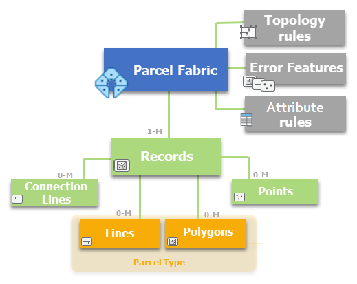

The parcel fabric is a controller dataset that handles a set of simple feature classes, a single geodatabase topology, and a set of attribute rules. Multiple parcel types can be added to a fabric. Each parcel type is represented by a polygon-polyline featureclass-pair. Each parcel type’s featureclass-pair has its own schema and can be extended with additional fields, domains and subtypes. Validating a parcel fabric’s topology rules and evaluating attribute rules may result in the creation of error features that report on rules that are outside their defined limits. To learn more see the help topic Parcel fabric data model.
ParcelFabric class
The ParcelFabric class provides an abstraction of the controller dataset. Methods on this class provide an entry point to the other areas of the parcel fabric API, including the topology, the system tables, the definition, and the parcel type information.
As with other datasets in the geodatabase, a ParcelFabric object can be obtained by calling Geodatabase.OpenDataset(). ParcelFabric objects can also be obtained from a table or feature class that are controlled by the parcel fabric by using Table.GetControllerDatasets(). Note that a particular parcel feature will belong to both controller datasets, the topology as well as the parcel fabric.

Parcel types
The fabric has user-defined parcel types. Each parcel type is represented by a polygon feature class and a polyline feature class. A parcel type is created with a given name such as 'Tax' or 'Lot', for example, and the parcel type is represented in the fabric as a polygon feature class and polyline feature class.
If polygons in a parcel type exist without corresponding lines around its perimeter, then you use a Build function to create the lines for the parcels. Similarly, if there are lines in a parcel type that form loops but that do not enclose a parcel, then you can build parcel polygons from the parcel lines. The fabric also has points. The points are shared between parcel types so a parcel’s points do not have a parcel type. Points are also assigned to the active record when they are created.
The list of parcel types controlled by a parcel fabric can be returned through the following code:
var myParcelFabricLayer =
     MapView.Active.Map.GetLayersAsFlattenedList().OfType<ParcelLayer>().FirstOrDefault();
IEnumerable<string> parcelTypeNames = await myParcelFabricLayer.GetParcelTypeNamesAsync();
In the map view a parcel type is represented by a line and polygon feature layer. By default these are presented in a group layer in the table of contents. There is also a sub-group layer called Historic that holds the historic lines and historic parcels for the same type. The historic layers are used to show the parcel features that have been retired by a later record in the parcel lineage.

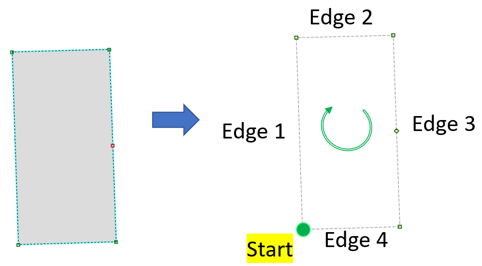

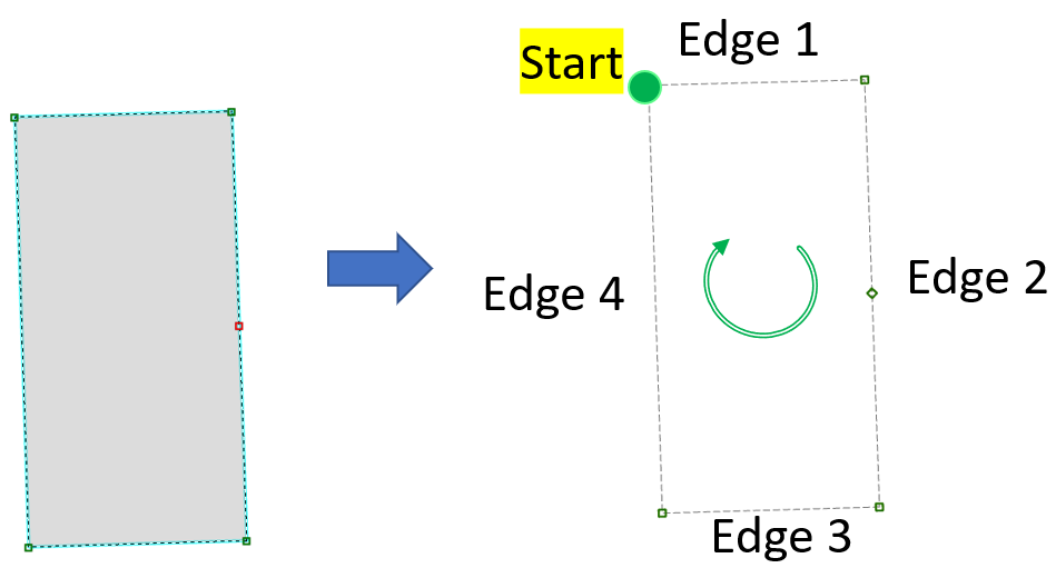

Get clockwise-sequenced parcel edge information
The preceding section shows how to return a parcel's line and point features for use in simple customizations that do not require any specific sequence or order for the returned features. However, custom tools that need functionality like calculating a misclosure, or reporting a parcel's information in a line table or boundary layout need to order the lines into a connected sequence, often starting and ending at a known point of beginning. This section describes the Parcel API and the concepts used for the geometric relationships between a parcel's polygon geometry and its parcel boundary lines. The terms used or defined in this section include: parcel edges, geometry segments, parcel line-to-edge relationships, clockwise sequence, next line connectivity, previous line connectivity, and closing line.

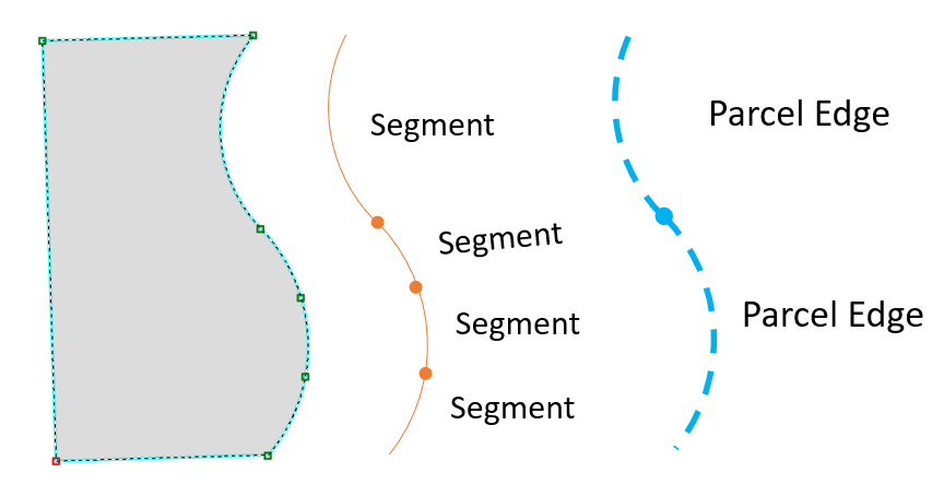

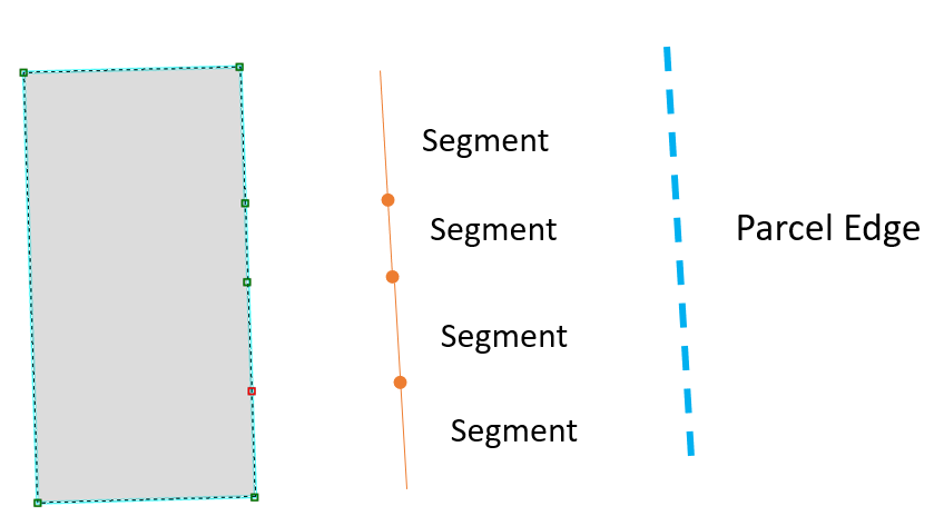

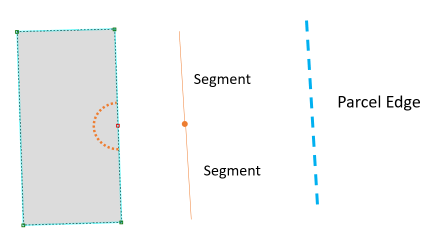

Parcel edges
Parcel edges are derived from the geometry of the polygon's segments and are established based on segment tangency. Each sequence of tangent segments defines a single parcel edge.
The illustration above shows a polygon geometry that has four edges. The east side of the polygon has two tangent segments that define one of the parcel edges. If this same polygon geometry were edited with additional vertices on the eastern side to result in multiple tangent segments there, then the parcel still has the same number of parcel edges, depicted as follows:
For circular arcs the segments that define a single parcel edge must be tangent and must also have the same radius and center point. In the following illustration the polygon geometry has four circular arc segments, and they are all tangent to one another. However there are two parcel edges here because the northern-most segment has a different radius and center point compared to the other segments.
The parcel edges returned via the function GetSequencedParcelEdgeInfoAsync in the snippet below will always follow a clockwise sequence. By using a hint-point to specify the nearest point-of-beginning you can dictate the first parcel edge in the clockwise sequence.
Note also that the line features returned by the function will always be in the same parcel type as the parcel polygon layer passed in for the first parameter.
ParcelEdgeCollection myEdgeCollection = await
   myParcelFabricLayer.GetSequencedParcelEdgeInfoAsync(MyPolygonLyr, myParceloid, pointOfBeginning);
If your implementation does not require a point of beginning; for example if you are only computing a parcel misclose, then the hint-point parameter can be set to null and the sequence will be returned with an arbitrary start point.
The hint-point is a point that’s close to your desired point of beginning and it could also be an exact match. When you use the hint-point the function will look for the closest line’s start or end vertex, and this dictates the starting parcel edge for the clockwise sequence.

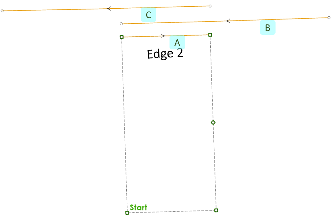

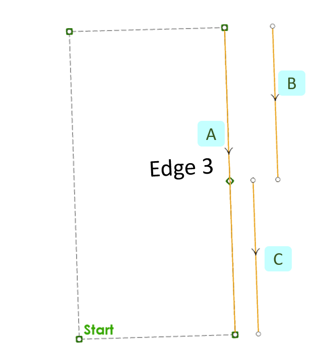

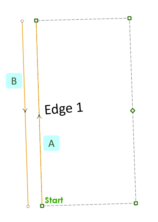

Parcel line-to-edge relationships
The parcel and boundary lines depicted in the following illustration are used to describe the relationships in this section:
The GetSequencedParcelEdgeInfoAsync function uses the clockwise parcel edges and queries each one to get the relationships between the edge and the set of boundary line features. The line features that are returned are any that have full or partial overlap with the parcel edge.
For example the following image depicts the two lines 'A' and 'B' returned for the western parcel edge:
These lines are shown graphically separated for visualization purposes. They are exactly coincident, and otherwise differ only in that their geometry is reversed from one another by 180°.
There are two overall forms of these relationships, they are qualitative and quantitive. The qualitative realtionships are defined using four boolean flags and an enumeration. The enumeration below is used to describe a boundary line's start and end points in relation to the parcel edge that it overlaps.
  public enum ParcelLineToEdgeRelationship
    StartVertexOnAnEdge = 1,
    EndVertexOnAnEdge = 2,
    StartVertexMatchesAnEdgeEnd = 4,
    EndVertexMatchesAnEdgeEnd = 8,
    BothVerticesMatchAnEdgeEnd = 16,
    NoEndVerticesTouchAnEdge = 32,
    All = -1
The four boolean flags that define the other qualitative line properties are as follows:
  1. IsReversed: if the flag is true then the line direction is oriented in the opposite direction to the edge that it's on.
  2. IsClosing: if the flag is true then the line is on the final parcel edge that connects back to the starting edge within the clockwise sequence.
  3. HasNextLineConnectivity : if the flag is true then there is a line feature on the same parcel edge, or on the next parcel edge within the clockwise sequence, that is connected to the current line's end vertex.
  4. HasPreviousLineConnectivity : if the flag is true then there is a line feature on the same parcel edge, or on the previous parcel edge within the clockwise sequence, that is connected to the current line's end vertex.

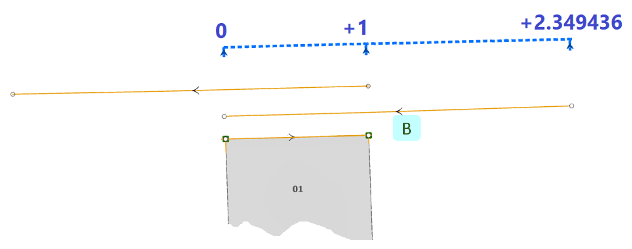

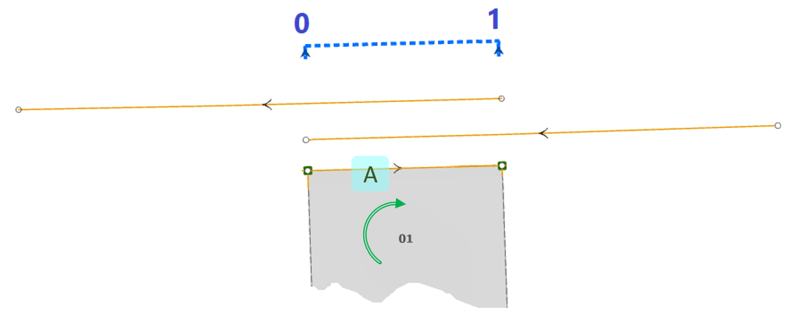

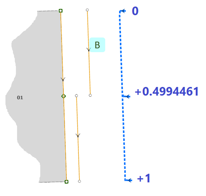

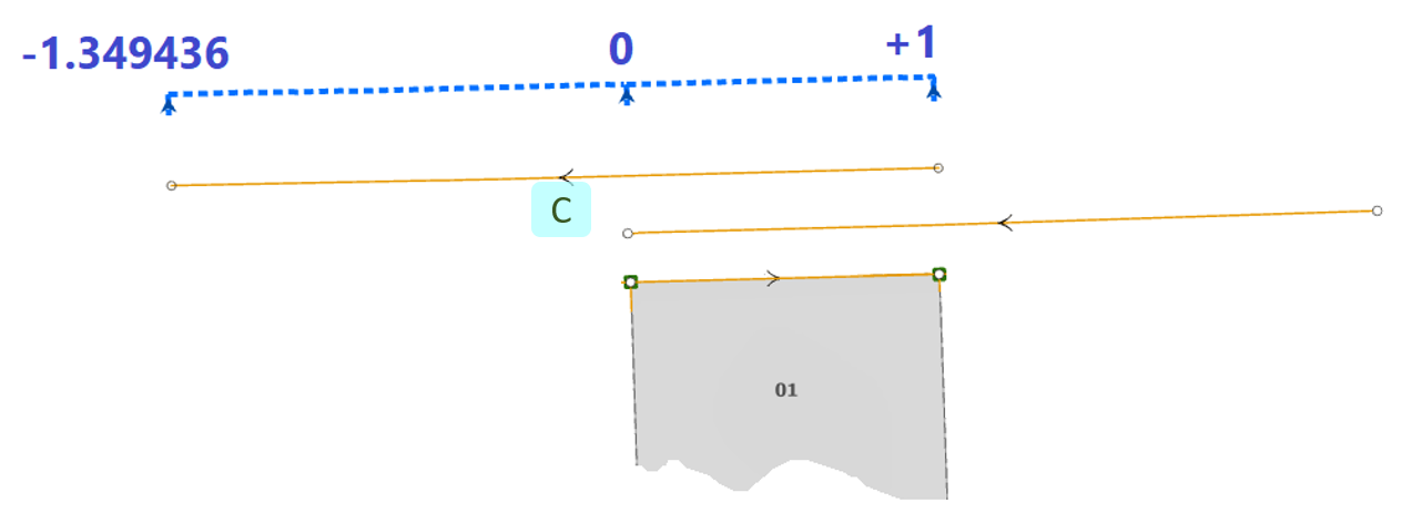

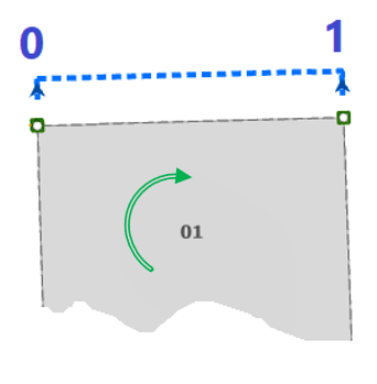

The function also returns quantitative properties based on the geometry of each parcel edge. It assigns a value of 0 at the parcel edges start and a value of 1 at its end. Then for each line feature that is on an edge, its start and end points' proportional positions are returned.
For example the following image depicts the 0 and 1 positions on the north parcel edge:
Introducing the three lines that are fully or partially coincident with this edge reveals that the line feature called 'A' has its start position at 0, and its end position at 1:
Since the other two lines in the image above partially overlap the parcel edge and extend beyond the 0 and 1 positions, they will have start and end positions that are greater than 1 or less than 0. A complete explanation of this is presented in the conceptual example topic below.
The following code generates a report with these line-to-edge relationships:

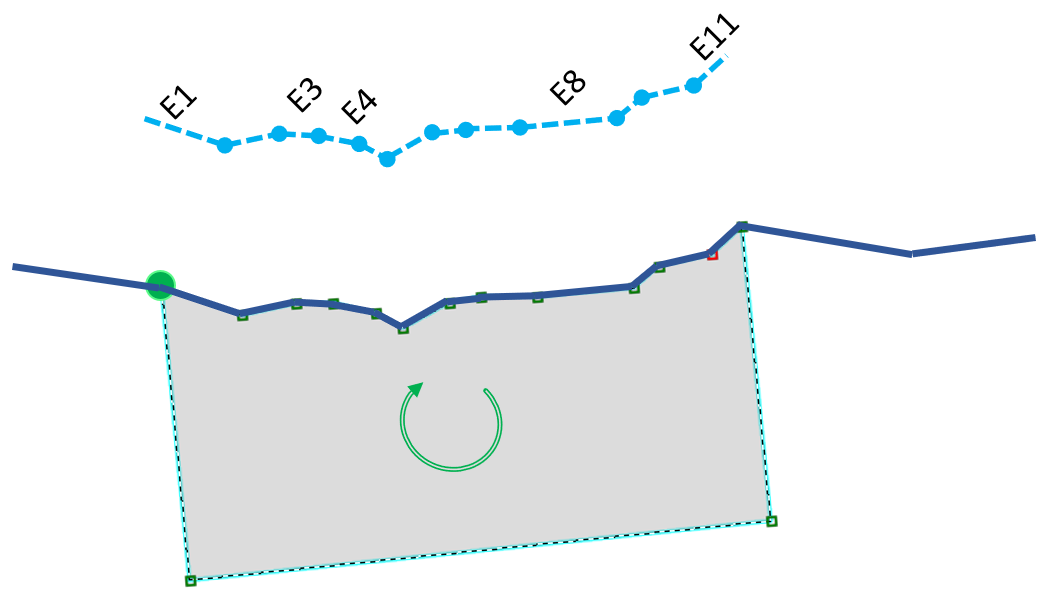

Natural boundary line edges
For natural boundaries and other types of line feature data, there may be multiple edges for a single line boundary as shown in this illustration:
In this scenario the EdgeID property in ParcelLineInfo returns a list of ids, and this list is repeated for each parcel edge that is shared by the same line feature. The following shows a portion of the returned report for two consecutive edges for a line feature that has multiple parcel edges:

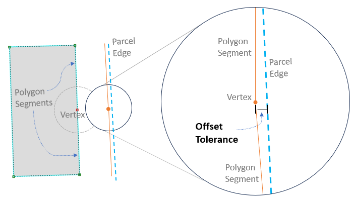

In addition to filtering the output based on qualitative relationships, you can also configure the filter using two distance tolerances that are designed to:
  1. give some flexibility in defining segment tangency for parcel edges, and

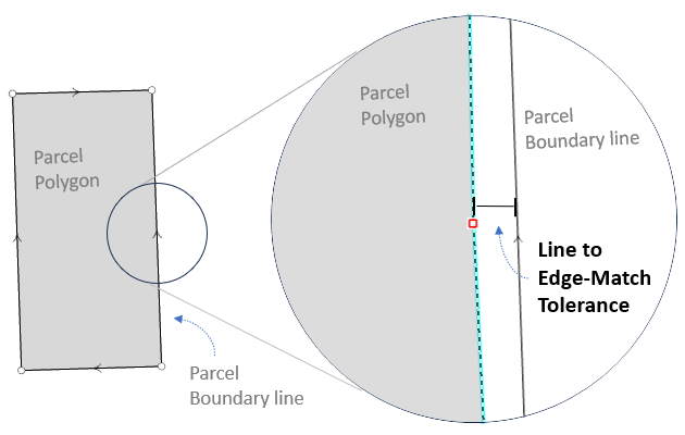

  2. allow for parcel lines that are not precisely located with respect to the polygon’s edge geometry.
The first of these tolerances is called the offsetTolerance and is used to define the allowable offset when detecting edges for parcel polygon segments. An offset is measured where the segments connect and if it is less than the specified value they will be detected as tangent segments and as part of the same parcel edge.
The second tolerance, called the lineToEdgeMatchTolerance, allows some wiggle-room when for example, detecting a closed loop traverse for lines that are topologically connected to form the loop, but the enclosed polygon is not topologically perfect. This occurs when there is some separation between the parcel edges and the line features. A line feature that is separated from the parcel edge by less than the specified edge match tolerance will be detected and included in the results for the parcel.

Parcel line-to-edge relationships conceptual example
This section uses the same example as used earlier in this topic, with a detailed break-down of each of the line features' parcel edge relationships. The parcel and its lines are shown again here:
Edge 1
Line Feature Parcel line-to-edge relationships IsReversed ? IsClosing? HasNextLineConnectivity? HasPreviousLineConnectivity?
A BothVerticesMatchAnEdgeEnd ☑ ☑
B BothVerticesMatchAnEdgeEnd ☑ ☑ ☑
Line Feature StartPositionOnParcelEdge EndPositionOnParcelEdge
A 0.000000 1.000000
B 1.000000 0.000000
Edge 2
B EndVertexMatchesAnEdgeEnd ☑ ☑
C StartVertexMatchesAnEdgeEnd ☑ ☑
A 0.000000 1.000000
B 2.349436 0.000000
C 1.000000 -1.349436
Edge 3
B StartVertexMatchesAnEdgeEnd ☑ ☑
C EndVertexMatchesAnEdgeEnd ☑ ☑
A 0.000000 1.000000
B 0.000000 0.499446
C 0.500554 1.000000

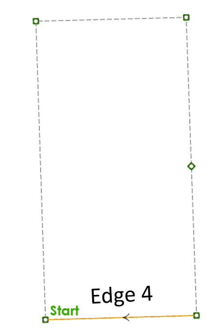

Edge 4
A BothVerticesMatchAnEdgeEnd ☑ ☑ ☑
A 0.000000 1.000000
Using sequenced parcel line information

Geometry segment tangency
Available with ArcGIS Pro .Net SDK 3.7 or higher, a new ParcelUtilities singleton class provides access to API for the same functionality featured in the geoprocessing tool called Simplify By Tangent Segments, found in the Editing Tools toolbox. This functionality is strongly associated with the previous topic related to detecting parcel edges, since the tangency between segments is foundational to the concepts presented there.
The following short code snippet shows its general use:
int preVertexCount = featGeom.PointCount;
var mp = featGeom as Multipart;
featGeom = ParcelUtilities.Instance.SimplifyShapeByTangentSegments(mp, userAllowedOffsetConverted);
int removedVertexCount = preVertexCount - featGeom.PointCount;
And for complete context, the following full function used to remove vertices between tangent segments:

        quFilter.ObjectIDs = ids;
        double unitSF = 1.0;
        var xyTol = 0.001 / 6371000.0 * Math.PI / 180.0; //default to 1mm in GCS decimal degree
        if (featLyr.GetSpatialReference().IsProjected)
          xyTol = featLyr.GetSpatialReference().XYTolerance;
        if (userAllowedOffsetInMeters < 0.001)
          userAllowedOffsetInMeters = 0.001;
        if (userAllowedOffsetInMeters > 2.0)
          userAllowedOffsetInMeters = 2.0;
        using RowCursor featCursor = featLyr.Search(quFilter);
        while (featCursor.MoveNext())
          using Feature feature = (Feature)featCursor.Current;
          var featGeomUnprojected = feature.GetShape();
          var featGeom = featGeomUnprojected;
          if (projectGeom)//project the shape to map
            featGeom = GeometryEngine.Instance.Project(featGeomUnprojected, mapSpatRef);
          if (mapSpatRef.IsProjected)
            unitSF = mapSpatRef.Unit.ConversionFactor; //mpu
            userAllowedOffsetConverted = userAllowedOffsetInMeters / unitSF;
          totalRemovedVertexCount += removedVertexCount;
          cps.Progressor.Value += (uint)removedVertexCount;
          editOper.Modify(featLyr, feature.GetObjectID(), featGeom);
          featureCount++;
         if (cps.Progressor.CancellationToken.IsCancellationRequested)
            break;
          break;
        cps.Progressor.Status = "Feature vertices removed: " + cps.Progressor.Value
        + Environment.NewLine + "Updating " + featureCount.ToString() + " features ...";
        anchorPoints.Clear();
        editOper.Abort();
        return "Canceled.";
      if (!editOper.IsEmpty && cps.Progressor.Value > 0)
        editOper.Execute();
      layerIds.Clear();
      sReportResult = "Number of vertices removed: " + totalRemovedVertexCount.ToString();
    catch (Exception ex)
      return ex.Message;
    return "";
  }, cps.Progressor);
  if (!string.IsNullOrEmpty(errorMessage))
    MessageBox.Show(errorMessage, "Simplify By Tangent Segments");
  else if (!string.IsNullOrEmpty(sReportResult))
    MessageBox.Show(sReportResult, "Simplify By Tangent Segments");
