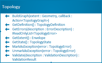

Topology
The Topology class provides an abstraction of the controller dataset, and the methods in this class provide an entry point to the other areas of the topology API.
As with other datasets in the geodatabase, a Topology object can be obtained by calling Geodatabase.OpenDataset(). The Geodatabase.OpenDataset() routine takes the name of a dataset to open.
public void OpenDataset(Geodatabase geodatabase)
    Topology topology = geodatabase.OpenDataset<Topology>("datasetName");
The Topology object can be obtained from a feature class as below:
public Topology GetTopologyFromFeatureClass(FeatureClass featureClass)
  IReadOnlyList<Dataset> controllerDatasets = featureClass.GetControllerDatasets();
  Topology topology = null;
  foreach (Dataset controllerDataset in controllerDatasets)
    if (controllerDataset is Topology)
      topology = controllerDataset as Topology;
    else
      controllerDataset.Dispose();
  return topology;
The topology also contains dirty areas and errors tables, see Validation, Errors, and Exceptions. The errors can be accessed using GetErrors() method.
Most of the methods in this class are described in the sections that follow. Additional methods are detailed below:
  • GetState() returns the state of topology. The states of topology are AnalyzedWithErrors, AnalyzedWithoutErrors, Empty, and Unanalyzed.
  • GetExtent() returns the maximum extent of the union of all the feature classes that participate in the topology. Note: Unlike a geodatabase topology whose extent dynamically reflects that of its constituent participating feature classes, a feature service topology’s extent remains static for the duration of the lifetime of the object. Therefore, a feature service topology’s GetExtent should not be used as input for ValidationDescription.Extent because the extent may have changed since it was opened.
  • GetErrors() returns a list of TopologyError objects as specified in ErrorDescription.

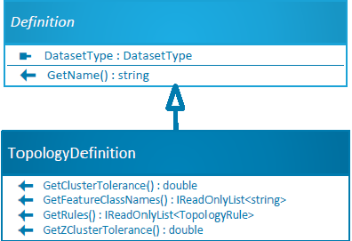

Topology Definition
The TopologyDefinition class provides metadata information about the topology dataset. It contains a schema record of all the properties specified during the topology creation, such as cluster tolerance, topology rules, and feature classes that participate in the topology.
Similar to other definition classes in the geodatabase API, the TopologyDefinition class can be accessed via the topology dataset itself or from the geodatabase.
  • Get the TopologyDefinition from the topology dataset – Usually this is used when the dataset is already open, and the reference is accessible
    using (Topology topology = geodatabase.OpenDataset<Topology>("datasetName"))
    using (TopologyDefinition definitionViaTopology = topology.GetDefinition())
  • Get the TopologyDefinition from a geodatabase – Usually this is used when it is not anticipated that the topology will be opened
    using (Geodatabase geodatabase = new Geodatabase(new FileGeodatabaseConnectionPath(new Uri("topology // dataset // location"))))
    using (TopologyDefinition definitionViaGeodatabase = geodatabase.GetDefinition<TopologyDefinition>("topologyName"))
The methods of the TopologyDefinition class are described below:
  • GetClusterTolerance() returns the cluster tolerance of the topology. The cluster tolerance is the distance within which edges or vertices are determined to be coincident.
  • GetFeatureClassNames() returns the name of all the feature classes that participate in the topology.
  • GetRules() returns the set of TopologyRule objects defined for the topology.
  • GetZClusterTolernace() returns the Z cluster tolerance of the topology. The z–tolerance is used to distinguish the z–height or elevation of vertices within the tolerance of one another.

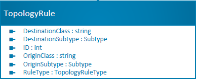

Rules
A topology rule defines the spatial relationship between features. The spatial relationship could be the relationship between features within a feature class, between features in different feature classes, or between features with different subtypes.
The topology rules are accessed from the topology definition by calling TopologyDefinition.GetRules().
using (TopologyDefinition topologyDefinition = topology.GetDefinition())
  IReadOnlyList<TopologyRule> rules = topologyDefinition.GetRules();
  foreach (TopologyRule rule in rules)
    Console.WriteLine($@"{rule.ID} {rule.RuleType} {rule.OriginClass} {rule.OriginSubtype.GetName()}");
The members of TopologyRule class are explained as:
  • DestinationClass specifies the name of the destination feature class to which this topology rule is assigned.
  • DestinationSubtype defines the Subtype in the destination feature class.
  • ID specifies the ID of the topology rule.
  • OriginClass specifies the name of the origin feature class to which this topology rule is assigned.
  • OriginSubtype defines the SubType in the origin feature class.
  • RuleType stipulates the type of this topology rule.

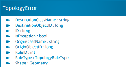

Errors
The ErrorDescription describes how topology errors should be retrieved from an area of interest defined in the Extent. The ErrorType specifies the type of TopologyError to be retrieved, and the RuleType defines the type of TopologyRule that is violated by the features.
Get all the errors and exceptions due to features violating the PointProperlyInsideArea topology rule by calling Topology.GetErrors()
TopologyRule pointProperlyInsideAreaRule = topology.GetDefinition().GetRules().First(rule => rule.RuleType == TopologyRuleType.PointProperlyInsideArea);
ErrorDescription errorDescription = new ErrorDescription(topology.GetExtent())
  TopologyRule = pointProperlyInsideAreaRule
IReadOnlyList<TopologyError> errorsDueToViolatingPointProperlyInsideAreaRule = topology.GetErrors(errorDescription);
Mark all errors from features violating the PointProperlyInsideArea topology rule as exceptions using MarkAsExceptionInEditOperation() method (Use the base Topology.MarkAsException() routine only in CoreHost applications)
foreach (TopologyError error in errorsDueToViolatingPointProperlyInsideAreaRule)
  topology.MarkAsException(error);
  // Alternatively, mark exception from the ArcGIS Pro add-in
  // topology.MarkAsExceptionInEditOperation(error);
By default, ErrorDescription is initialized to ErrorType.ErrorAndException. Here we want ErrorType.ErrorOnly by skipping the exceptions
  ErrorType = ErrorType.ErrorOnly,
IReadOnlyList<TopologyError> errorsAfterMarkedAsExceptions = topology.GetErrors(errorDescription);
Reset all the exceptions as errors by un-marking them as exceptions using UnmarkAsExceptionInEditOperation() method (again, in CoreHost use the core Topology.UnmarkAsException routine).
  topology.UnmarkAsException(error);
  // Alternatively, unmark exception from the ArcGIS Pro add-in
  // topology.UnmarkAsExceptionInEditOperation(error);

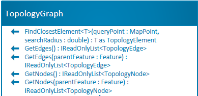

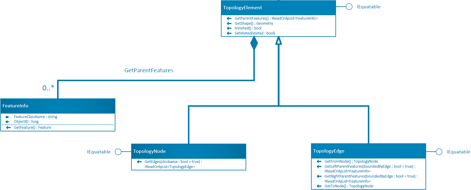

Graph and Elements
Each geodatabase topology has one associated topology graph. The topology graph is an in-memory planar representation of the geometries in the feature classes participating in the topology. When a TopologyGraph is built via Topology.BuildGraph(), spatial relationships between features are discovered, analyzed, and established to form an in-memory graph of topological elements.
The lifetime of the TopologyGraph as input for callBack is scoped to that of the client callback itself. Once the execution flow has returned from the callback, the TopologyGraph object will be disposed, and attempting to use the TopologyGraph object outside of the callback scope will raise an ArcGIS.Core.ObjectDisconnectedException.
A TopologyElement can be either a TopologyNode or a TopologyEdge, corresponding to points and lines in the feature space. The topology graph can be traversed by iterating through the connectivity between the topology edges and topology nodes.
Build a topology graph using the extent of the topology dataset by calling Topology.BuildGraph()
// Get a feature from the feature class that participated in topology using an ObjectID
Feature feature = GetFeature("feature class name", ObjectID);
// Build a topology graph using the extent of the topology dataset
topology.BuildGraph(topology.GetExtent(), (topologyGraph) =>
  // Get all topology edges via the feature
  IReadOnlyList<TopologyEdge> allTopologyEdgesViaFeature = topologyGraph.GetEdges(feature);
  // Get all topology nodes via the feature
  IReadOnlyList<TopologyNode> allTopologyNodesViaFeature = topologyGraph.GetNodes(feature);
  TopologyNode topologyNodeViaFeature = allTopologyNodesViaFeature[0];
  // Get all edges connected to node in clockwise order via a feature
  IReadOnlyList<TopologyEdge> allEdgesConnectedToNodeViaFeature = topologyNodeViaFeature.GetEdges();
  // Get all edges connected to node in counterclockwise order via a feature
  IReadOnlyList<TopologyEdge> allEdgesConnectedToNodeViaFeatureCounterClockwise = topologyNodeViaFeature.GetEdges(false);
Iterates through the topology edges to access topology nodes and parent features
foreach (TopologyEdge edgeConnectedToNodeViaFeature in allEdgesConnectedToNodeViaFeature)
  // From and to nodes from a topology edge
  TopologyNode fromNode = edgeConnectedToNodeViaFeature.GetFromNode();
  TopologyNode toNode = edgeConnectedToNodeViaFeature.GetToNode();
  // Left and right parent features bounded by the edge
  IReadOnlyList<FeatureInfo> leftParentFeaturesBoundedByEdge = edgeConnectedToNodeViaFeature.GetLeftParentFeatures();
  IReadOnlyList<FeatureInfo> rightParentFeaturesBoundedByEdge = edgeConnectedToNodeViaFeature.GetRightParentFeatures();
  // Left and right parent features not bounded by the edge
  IReadOnlyList<FeatureInfo> leftParentFeaturesNotBoundedByEdge = edgeConnectedToNodeViaFeature.GetLeftParentFeatures(false);
  IReadOnlyList<FeatureInfo> rightParentFeaturesNotBoundedByEdge = edgeConnectedToNodeViaFeature.GetRightParentFeatures(false);
The FindClosestElement<T> method discovers a topological element in the topology graph closest to the location specified by MapPoint and within the search radius.
// Topology node nearest to the query point within specified search radius of 1 unit
TopologyNode topologyNodeWithInSearchRadius = topologyGraph.FindClosestElement<TopologyNode>(feature.GetShape() as MapPoint, 1.0);
// Topology edge nearest to the query point within specified search radius of 2 units
