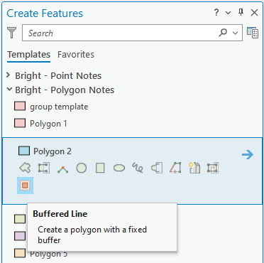

Build your add-in. Debug the add-in. Open the C:\Data\FeatureTest\FeatureTest.aprx project. Verify that your construction tool appears on the polygon layer. Activate the tool and create a new polygon feature by sketching a line.
