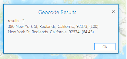

Build the sample and fix any compile errors. Debug the add-in and start ArcGIS Pro. Click the Simple Geocode button and view the results.
simpleGeocodeResults

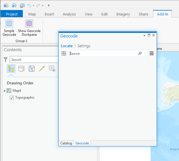

Build and run the add-in. Verify the UI.
LocatorControl

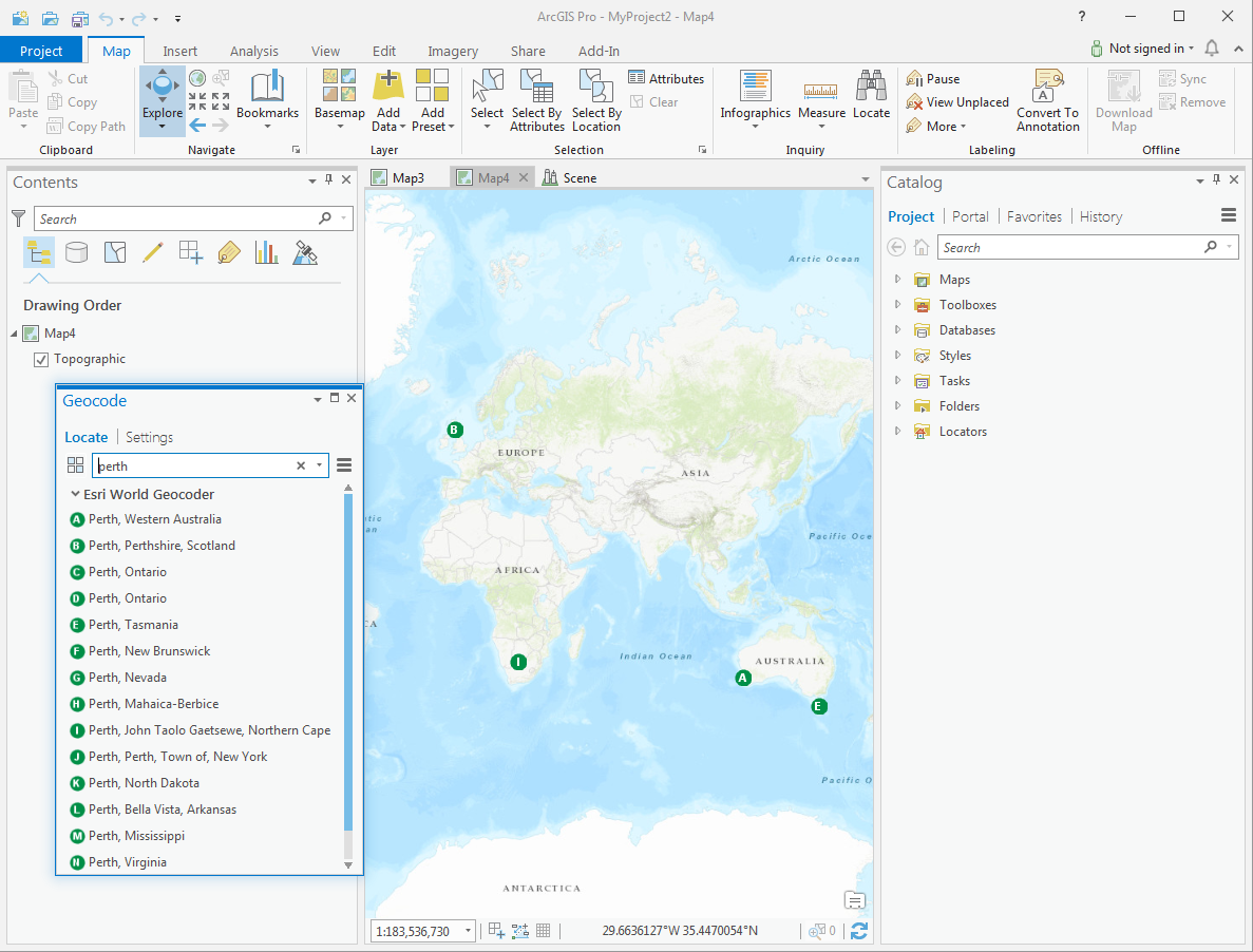

Enter a location and view the results.
LocatorControlResults

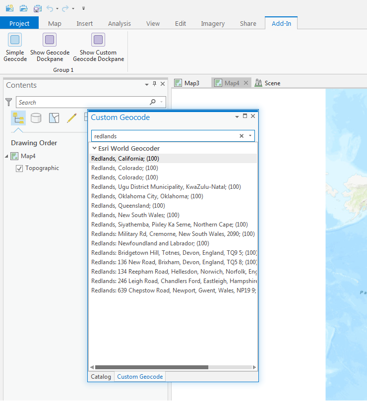

Step 7
Customize the UI in the CustomGeocodeDockpane.xaml file to add the SearchTextBox and the ListBox. The ListBox is bound to a CollectionViewSource bound to the search results. The CollectionViewSource allows us to group results according to the locator providers.

Build the add-in. Fix any compile errors. Run the add-in and test what we have so far. You should be able to enter text into the search box and have the results displayed in the ListBox.
Geocode_CustomUI
