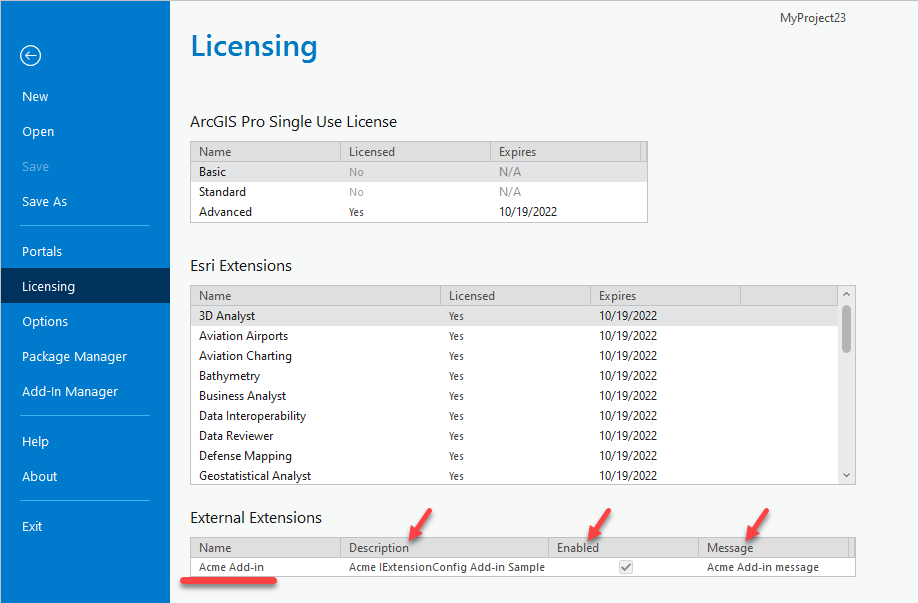

Note that the hasExtendedInfo attribute is false: hasExtendedInfo="false". Open Pro backstage, Licensing tab and you should see an entry for your "licensed" addin similar to this. The Enabled checkbox will be disabled and fixed to ExtensionState.Enabled.
IExtensionConfig

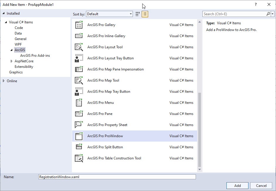

Now you'll add a ProWindow to your add-in to allow users to enter a product/authorization ID to enable the add-in. Name the window RegistrationWindow.xaml.
Licensing_5_Window

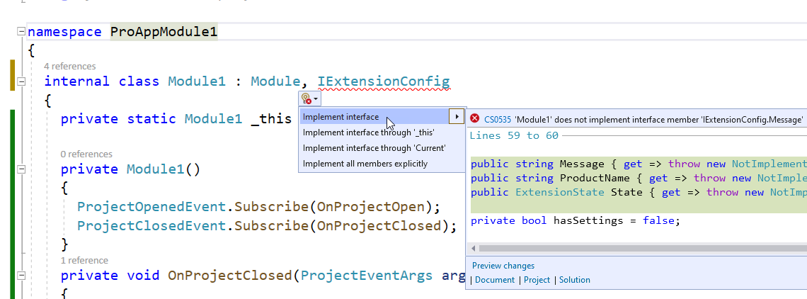

Use Visual Studio to generate the interface implementation stubs.
IExtensionConfig
Replace the Visual Studio generated stubs for the IExtensionConfig interface with the following code:

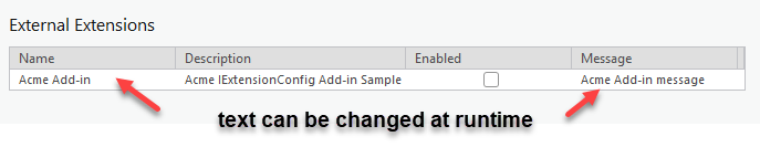

Notice too that empty strings are being returned for the ProductName and Message properties. This means their value will default to whatever was defined in the corresponding productName and message attributes on the <extensionConfig ... element in the Config.daml. Return a non-empty string to override the DAML values. The ProductName and Message properties are refreshed by backstage every time the enabled state of the add-in (via IExtensionState.State) is queried (for example, in response to the Enabled check box being clicked). This means an add-in can dynamically update its message or product name text in its External Extension list entry.
Licensing_6_Message

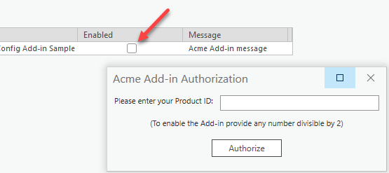

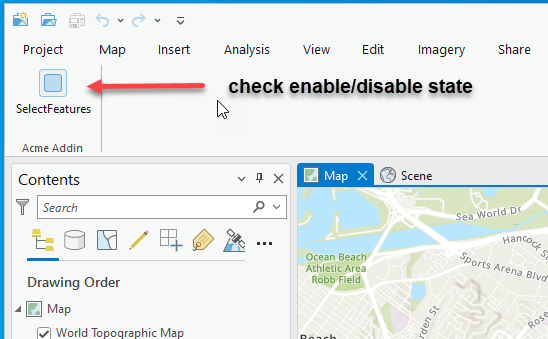

Debug your add-in. Run the debugger and start ArcGIS Pro. Open a project that contains a 2D map or add one to your project. Add at least one feature data set.
Click the backstage licensing tab. You should see an entry for your add-in on the licensing tab in the External Extensions list. The Enabled check box should be unchecked and show as Disabled (unless you changed your default _authorizationID value to be a number divisible by 2)
Check the Enabled check box. The RegistrationWindow dialog box will appear. Enter any ID and click Activate. If you enter a number evenly divisible by 2, your add-in will be enabled. If you enter anything else, the add-in will remain disabled.
Licensing_7_Popup
Once you enter a valid product/authorization ID, it will be cached for the duration of the session. If you disable the add-in (toggle off the Enabled check box) and re-enable it, the pop-up does not need to be shown.
Notice that when your add-in is enabled via backstage, the Select Features button (on the Add In tab) is enabled (via the activated "acme_module_licensed" condition) if you have a 2D map as the active map in your project.
Licensing_8_Button2
Click the Select Features button to select all the features in the active view.
