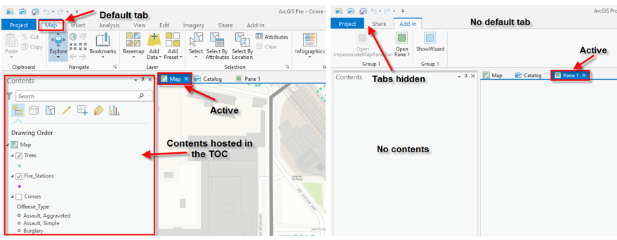

In Pro, a pane or "View" can be paired with a default tool, a default tab, and a content control which is hosted in the contents pane (a.k.a. the "Table of Contents" or "TOC"). The context of the application (contents, visible tabs, default tool, etc.) always reflects the context associated with the active pane. Therefore, when the active pane is switched in Pro, if it is a different "type" (map, scene, layout, or whichever) the Pro UI context likewise changes. For example, moving from a map pane to the catalog pane or to a layout pane will change the context from map to catalog or layout meaning the contents control changes, the default tool changes, and the visible tabs (and active tab) will change as well.
In some cases, incoming panes may not provide context or only partial context and, in those cases, those aspects of application context not provided will not be set. For example, if an incoming pane does not provide a contents control for the TOC then the contents will not be set (and the TOC appears to "blank out"). Also, tabs associated with just one particular view type may be hidden and the active tool deactivated.
In the screenshot below, on the left, the Pro UI context has been set relative to a map pane being active. On the right, the custom pane "Pane1" has been activated. Because Pane1 has no associated content control the TOC has gone blank. The map, insert, analysis, view, edit, and imagery tabs have all been hidden because, contextually, they depend on a map (being active).

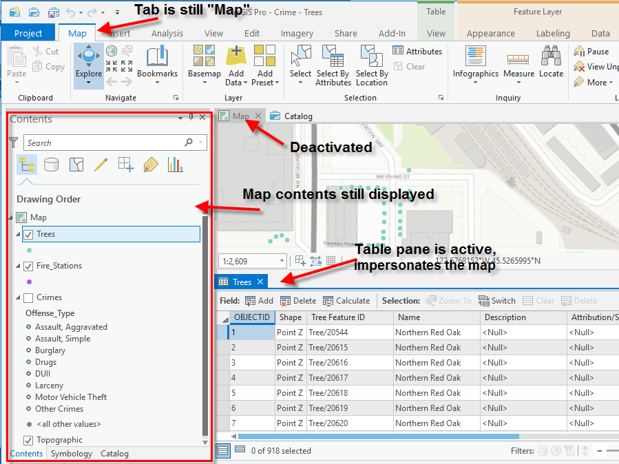

In certain cases, pane providers want to retain the context of the active map or scene whenever their pane is activated. This is accomplished through a pattern called "Impersonation". In impersonation, the pane provider impersonates a specific map or scene view to retain its context.
For example, when the Pro attribute table pane is activated off a layer context menu, notice that the context of the associated active map view does not change:
Impersonation
The currently active tab, tool, and TOC content have not changed because the attribute table pane is impersonating the active map.

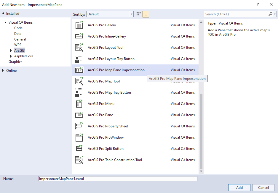

Create a new ArcGIS Pro Module Add-in, and name the project "ImpersonateMapPane". If you are not familiar with the ArcGIS Pro SDK, you can follow the steps in the ProGuide Build your first add-in to get started.
Add a new Map Pane Impersonation item to the add-in. Select the ArcGIS Pro Map Pane Impersonation from the ArcGIS templates.
ProGuide: MapAuthoring - Map Pane Impersonation
Just keep the defaults and click Add. Examine the changes made to the config.daml file after adding the new pane.

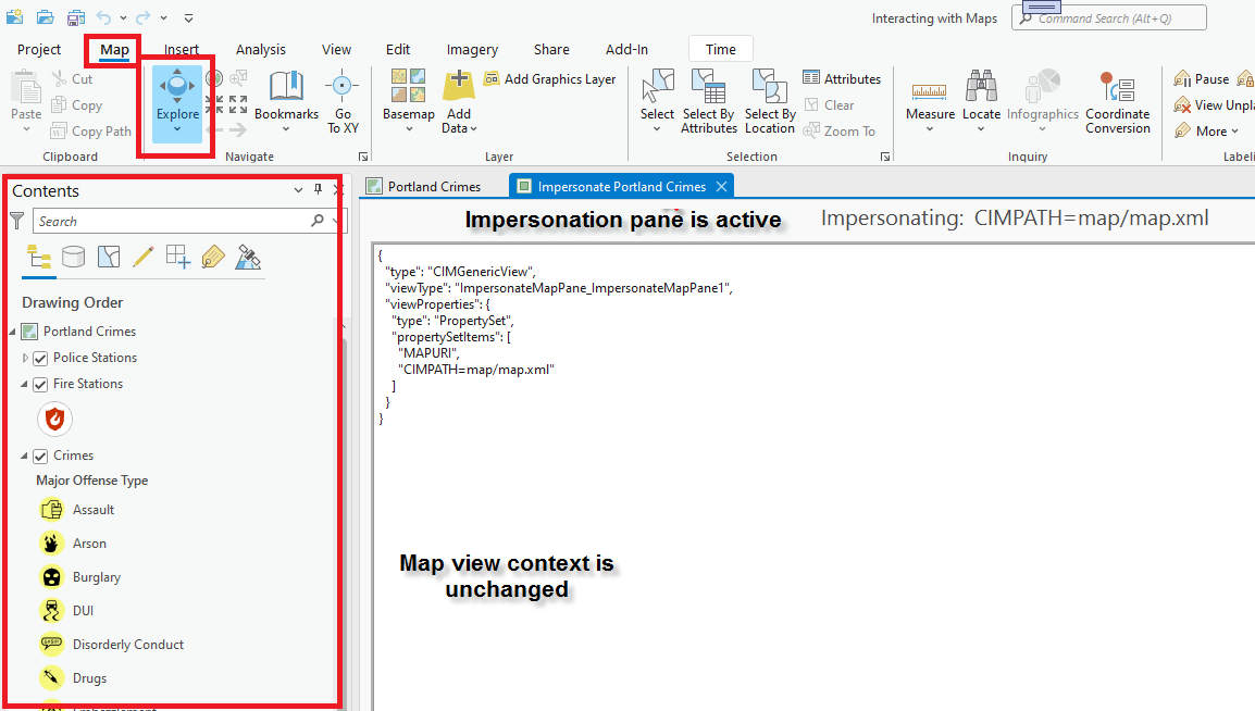

Click on the Add-in tab. Click on the "Open ImpersonateMapPane 1 button"
The button creates an instance of the ImpersonateMapPane1ViewModel and activates it.
ImpersonateMapPane1ViewModel is active
Notice that your custom ImpersonateMapPane1ViewModel pane has been activated. Because it is impersonating the previously active map, the application UI context is unchanged (from that of the map).

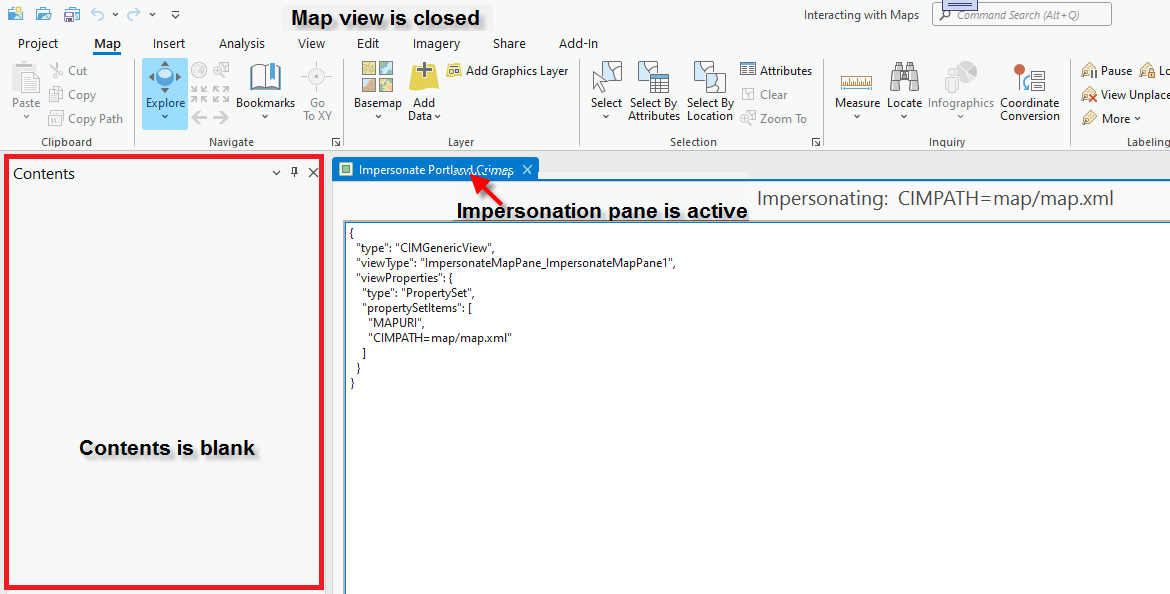

Close the map or scene your pane is impersonating. Notice that your impersonation pane closes automatically as well. This is the most common use case. That is, if the "impersonat-ed" pane on which your context depends is closed, then you (the "impersonat-ing" pane) also close. The assumption being you are impersonating a given pane probably because you need to retain its contents.
Stop debugging and return to Visual Studio. If, for some reason, you do not want your custom pane to close when the impersonated map pane is closed, you can override the OnNoActiveMapView() method. Try adding this code into your ImpersonateMapPane1ViewModel class.
  protected override void OnNoActiveMapView()
The class method you are overriding handles the closing of the impersonating pane. With this empty declaration we simply bypass that closing logic.
Start debugging the Visual Studio project again and open the same ArcGIS project. Run your impersonation pane button again. Then, close the map view you are impersonating. Now, your pane remains open however, the associated map view contents still closed (within the TOC). The key point to remember is that the contents being displayed in the Contents pane is owned by the map view and not your pane. When the impersonated pane is closed, so is its associated contents.
Impersonation pane with mapview closed
