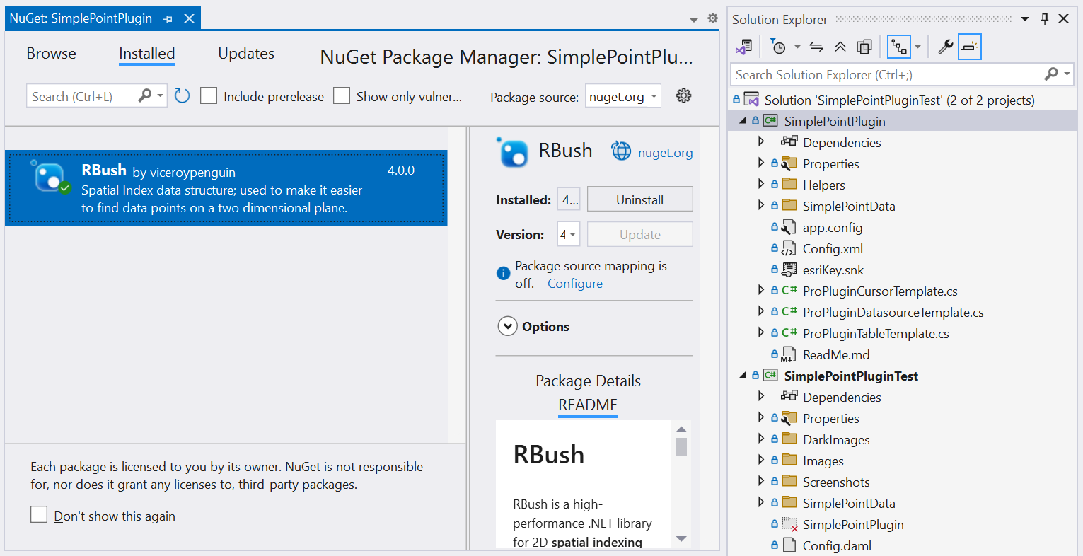

Open visual studio. Open the SimplePointPlugin.sln downloaded from the Pro SDK community samples. It contains two projects: One is a regular addin that consumes the plugin datasource: SimplePointPluginTest. The second is the plugin datasource itself: SimplePointPlugin. We will be looking at the Plugin Datasource first. When we have completed the plugin datasource implementation, we look at SimplePointPluginTest to see how to access and interact with the plugin datasource.
SimplePointPlugin uses the Microsoft.VisualBasic.FileIO.TextFieldParser to parse the csv and the "RBush" spatial index NuGet. Feel free to substitute different libraries for parsing csv files and/or spatial indexing. If the RBush NuGet does not automatically download then you will need to download and install it manually via the NuGet Package Manager in Visual Studio. Install the latest stable version of "RBush" (2.0.46 at this time of writing).

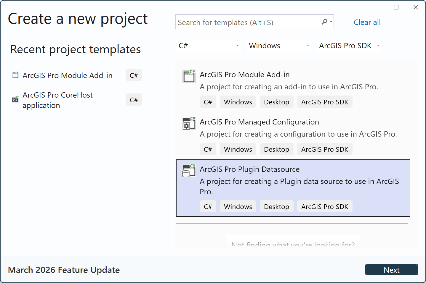

Note: To create a new Plugin Datasource project, run the 'ArcGIS Pro Plugin Datasource" project template installed with the 2.3+ Pro SDK.

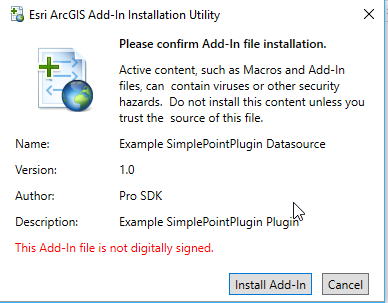

Your completed plugin datasource can be deployed to client machines using the same approach as an addin (in Pro, plugin data sources are addins). Double click the .esriPlugin archive to have RegisterAddin.exe install it to your default user folder. Similarly, plugin datasources can be copied to well-known folders (again, same as "regular" Pro addins). More detail on the structure of a plugin datasource can be found in the Framework ProConcepts guide in the Plugin datasource section.
Note: Installed plugin datasources are not listed in the Addin Manager tab on the backstage of Pro.
