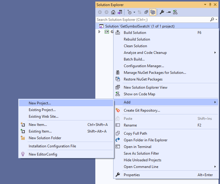

Step 1. Add new project
In Visual Studio right click on GetSymbolSwatch solution, click on "Add" and then "New Project".
Add new project

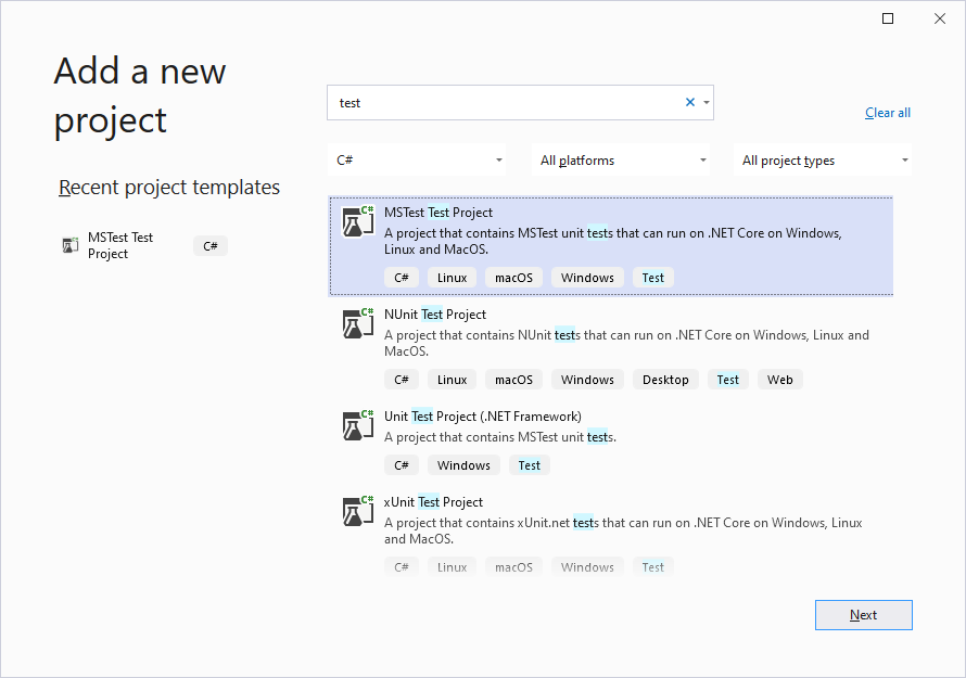

Step 2. Create a unit test project
In "Create a New Project" dialog search for "test". From the list of projects that show up select "MSTest Project". Click "Next".

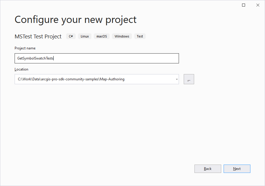

In "Configure your new project" dialog edit project name to "GetSymbolSwatchTests". Click "Next".
Configure unit test project

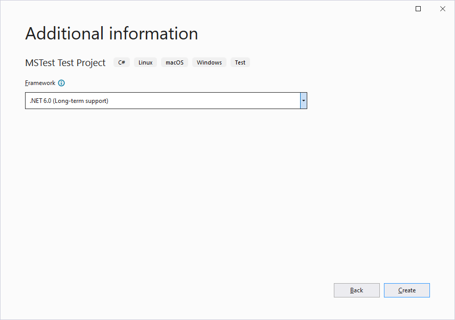

In "Additional information" dialog select ".Net 6.0 (Long-term support)". Click "Create".

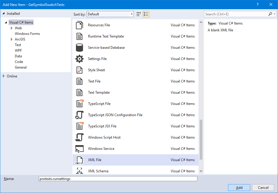

Scroll through the list and select "XML File". Name the file "protests.runsettings" and click "Add".
Create runsettings file
Edit "protests.runsettings" file and replace the existing contents of the file with the settings shown below

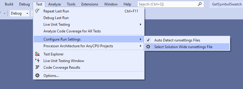

Step 4. Configure runsettings file
In Visual Studio click on "Test" menu, click on "Configure Run Settings", and then "Select Solution Wide runsettings File".
Configure Runsettings

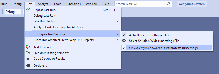

In the "Open Settings File" browse dialog that opens navigate to and select the runsettings file from the previous step. Click Open.
Post Configure Runsettings

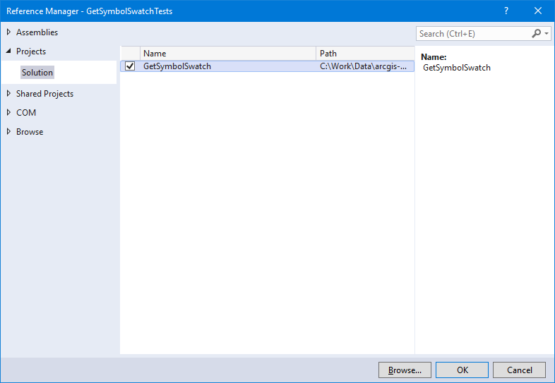

In "Solution Explorer" expand "GetSymbolSwatchTests" project and right click on the "Dependencies" node. Click "Add Project Reference".
In the "Reference Manager" dialog expand "Projects" node and select "Solution". Select the option to add "GetSymbolSwatch" project.
Reference Add-In Project

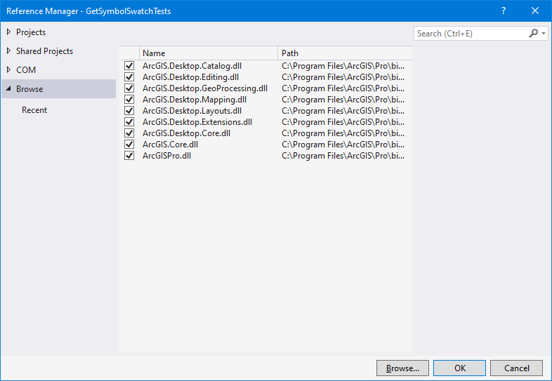

In the "Reference Manager" dialog select "Browse" node. Click on the "Browse.." button to navigate and add all the ArcGIS Pro assemblies referenced in the Add-In project.
Make sure "ArcGISPro.dll" from the "bin" folder is also selected, this isn't referenced in the Add-In project.
Browse References
Click OK.

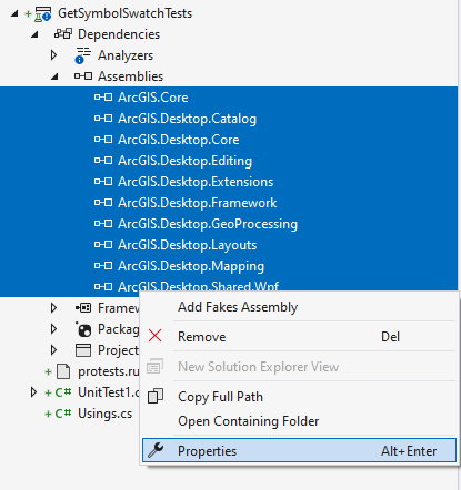

In "Solution Explorer" expand "Dependencies" and then expand "Assemblies" nodes in the "GetSymbolSwatchTests" project. Select all Pro assemblies, right click and select Properties.
Framework References
Modify "Copy Local" property and set it to "No".

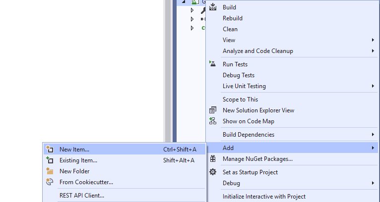

Step 6. Add Helper classes
Add TestEnvironment class
Right click on "GetSymbolSwatchTests" project, click on "Add", and then "Class". Name the new class "TestEnvironment.cs".
Replace the contents of the file with the following code snippet.

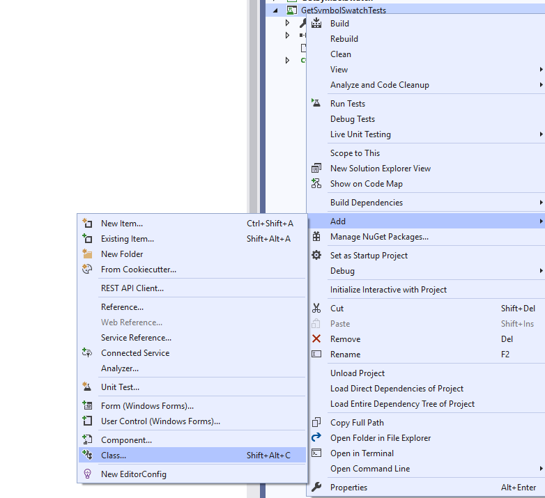

Right click on "GetSymbolSwatchTests" project, click on "Add", and then "Class". Name the new class "ArcGISTestClassAttribute.cs".

Right click on "GetSymbolSwatchTests" project, click on "Add", and then "Class". Name the new class "TestResolver.cs".

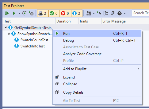

Step 5. Run the tests
If Test Explorer window isn't already open you can open this window from Visual Studio's "Test" menu, and then "Test Explorer".
Right click on a test and select the option to "Run".
Run Tests
