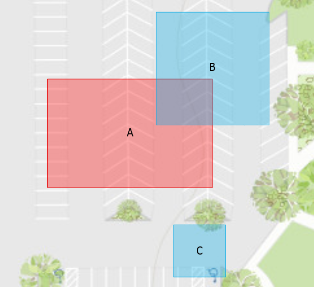

This ProGuide shows how the Relate method of the GeometryEngine class can express existing relational operations. In this example, you're expressing the Overlap method by creating a pattern matrix string as described in the Geometry ProConcepts. Imagine polygon geometries in the following configuration:
ProGuide: Geometry - Spatial Relationship Overlap
In this example of testing the relationship between geometries, you're expressing the relationship where A-B evaluates to true and A-C evaluates to false.

In the previous image, consider the relationship of interiors, boundaries, and exteriors for the combination of polygon A to polygon B and for polygon A to polygon C. The result should be similar to the following matrix. The union of interiors must be true and the union of the exterior and the interior must evaluate to true.
// test the spatial relationship by considering the following DE-9IM matrix
//       | I(B) | B(B) | E(B)
//  I(A) |  T   |  *   |  T
//  B(A) |  *   |  *   |  *
//  E(A) |  T   |  *   |  *
// returns true, as polygon A and B do overlap
bool doTheyOverlap = GeometryEngine.Instance.Relate(polygonA, polygonB, "T*T***T**");
// returns false, as polygon A and C do not overlap
doTheyOverlap = GeometryEngine.Instance.Relate(polygonA, polygonC, "T*T***T**");
