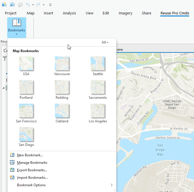

  • Since Pro 2.6, you can search for DAML ids along with caption in the Customize the ribbon options page in ArcGIS Pro. With the proper DAML Id, for the example below is using "esri_mapping_bookmarksNavigateGallery" which brings up the Bookmarks Navigation dialog, simply add command buttons to your add-in by using the refID attribute in the button tag and reference the DAML Id.
In order to create a new tab on the Pro ribbon that contains the "Bookmarks Navigation" command follow these steps:
  1. Create a new ArcGIS Pro Add-in.
  2. Open config.DAML a replace the tabs and groups tags with the tags from the snippet below:
<modules>
  <insertModule ... >
    <tabs>
      <tab id="ReusingProCommands_Tab1" caption="Reuse Pro Cmds" keytip="T1">
        <group refID="ReusingProCommands_Group1"/>
      </tab>
    </tabs>
    <groups>
      <group id="ReusingProCommands_Group1" caption="Reuse Pro Commands" keytip="G1">
        <button refID="esri_mapping_bookmarksNavigateGallery" />
      </group>
    </groups>
    <controls>
      <!-- add your controls here -->
    </controls>
  </insertModule>
</modules>

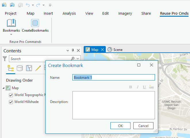

  1. Build and run the Add-in and the result should look like this: Reusing ArcGIS Pro Commands in your Add-in Ribbon UI by Reference DAML changes

  1. Build and run the Add-in and the result should look like this and show the Create Bookmark dialog first: Reusing ArcGIS Pro Commands in your Add-in Ribbon UI by using existing code-behind
  2. After the "Borrowed code-behind" completes (after closing the Create Bookmark dialog) the add-on function will start running popping up the message box with the Here is my own optional add-on functionality string displayed.

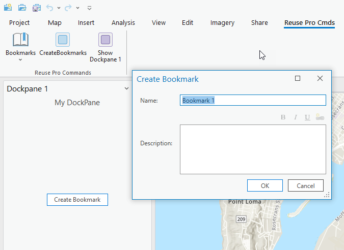

  3. Show your dockpane and click the "Create Bookmark" button. The result should look like this: Reusing ArcGIS Pro Commands in MVVM

  1. Build and run the Add-in and the result should look like this and showing the Create Bookmark dialog as before, but the map should zoom back to the full extent after the Create Bookmark dialog closes.
