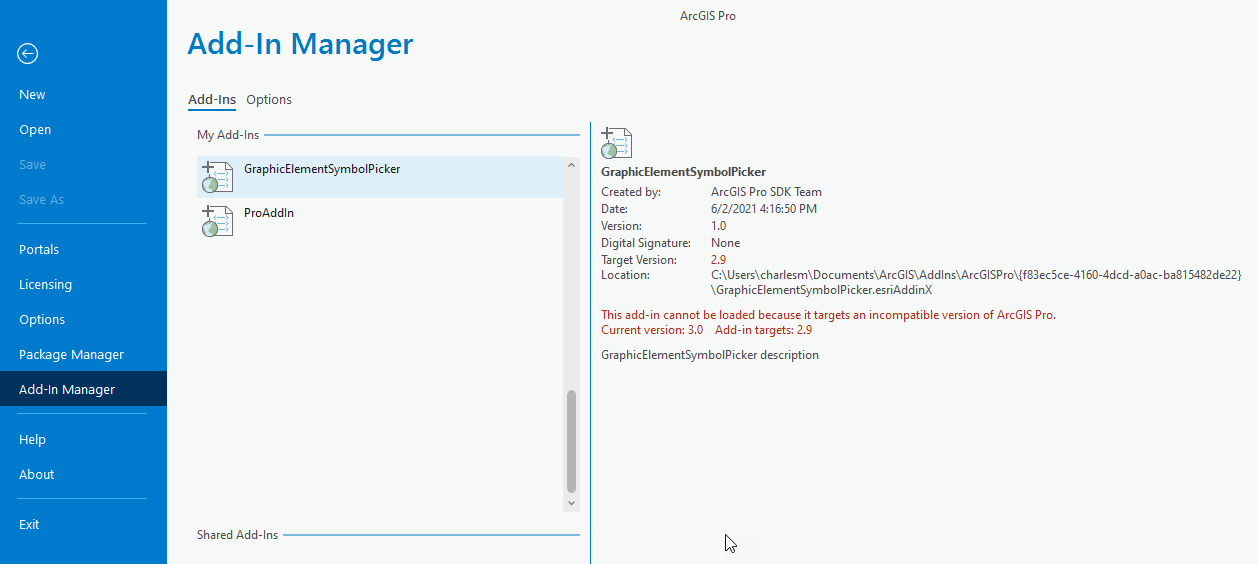

Why does ArcGIS Pro not load my add-in?
Check your desktopVersion attribute in the Config.daml. Make sure your add-in desktopVersion is compatible with the version of Pro you are trying to run it on. Refer to ProConcepts Advanced Topics, add-in versioning for information on add-in versioning. Refer to the ProGuide: Diagnosing ArcGIS Pro Add-ins for other issues.

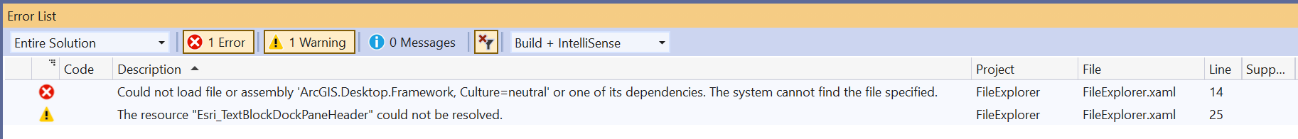

How do I fix my broken references in my ArcGIS Pro add-in solution?
ArcGIS Pro assemblies are not stored in a GAC. They are referenced via file paths in the add-in's .csproj or .vbproj file. This means that if you share ArcGIS Pro add-ins as Visual Studio projects, your assembly reference paths stored in your .csproj or .vbproj may be different than your colleagues'. For example, some users may install ArcGIS Pro to their C: drive while others install to their D: drive.
To fix the broken ArcGIS Pro references in an add-in, use the Fix ArcGIS Pro Reference utility included in the proapp-sdk-utilities.vsix. The steps below explain how to use the tool.
  1. Install the ArcGIS Pro SDK Utilities VSIX package (proapp-sdk-utilities.vsix).
  2. Open the add-in project that has broken references.
  3. Right-click the add-in project in the Visual Studio Solution Explorer and click Pro Fix References.
  4. Click Yes on the dialog box that asks you to proceed. Your broken references will now be fixed.

After migrating my addins from 2.x to 3.2, my addins will not load in ArcGIS Pro 3.2. Why?
If you are using the ArcGIS Pro Migration tool, to migrate a 2.x addin to 3.2, the dekstopVersion attribute in your config.daml may be being set incorrectly. At 3.2, the migration tool may be writing the build number into the dekstopVersion attribute twice. For example, in the snippet below notice that the build number in the desktopVersion attribute has been duplicated - 3.2.0.49743.49743 whereas it should be 3.2.0.49743:
<AddInInfo id="{xxxx-xxx}" version="1.0" desktopVersion="3.2.0.49743.49743" ...
To fix this issue, simply remove the duplicate value of the build number in the desktopVersion attribute and re-build your addin. ArcGIS Pro 3.2 will now load your add-in. The snippet below shows the correct format for the desktopVersion attribute (the duplicate build number has been removed):
<AddInInfo id="{xxxx-xxx}" version="1.0" desktopVersion="3.2.0.49743"
This issue only occurs with the migration tool at 3.2. This issue has not been observed at 3.0 or 3.1.
Why did my 2.x add-ins and configurations stop working at ArcGIS Pro 3.x?
ArcGIS Pro 3.0 was a breaking change release. To get your add-ins and configurations working again at 3.0 or later you must follow the steps outlined in the ProConcepts 3.0 Migration-Guide.
You can check if your add-in is out of date by going running Pro and checking the add-in manager. Incompatible add-ins that have not been migrated will be shown as disabled.

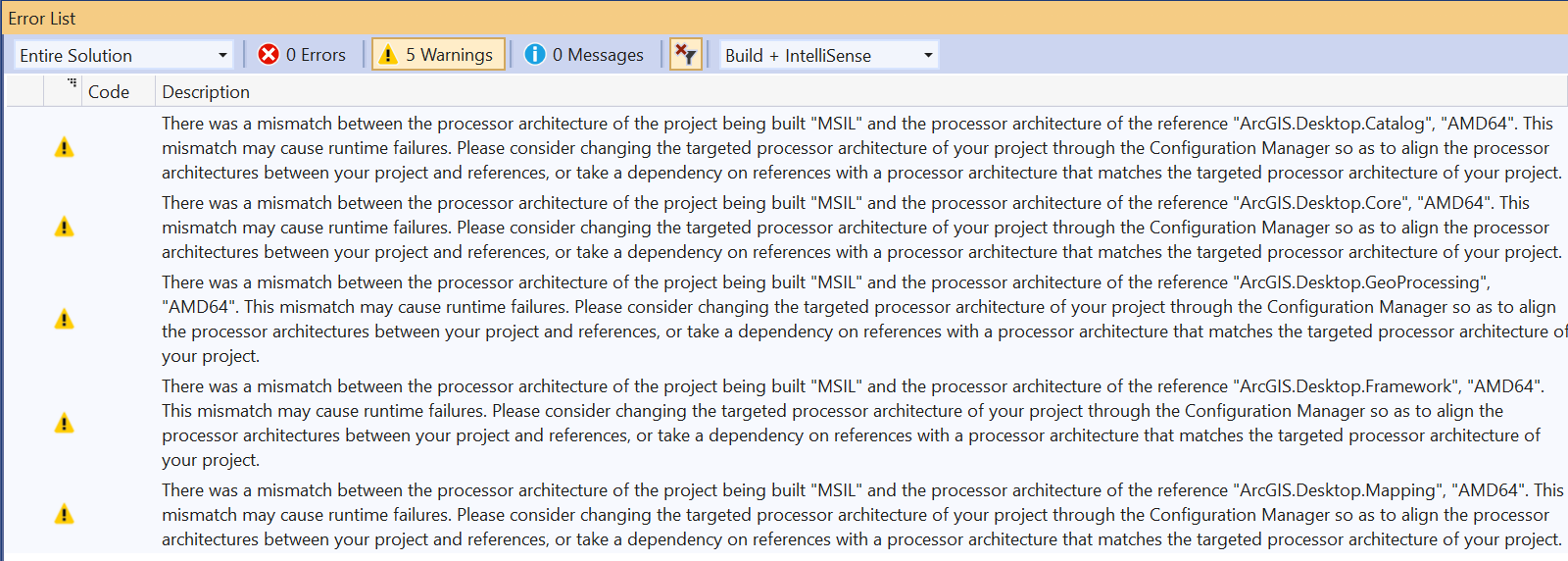

Why do I get this compiler warning about mismatched processor architecture when I build my existing add-ins with ArcGIS Pro 2.8 or ArcGIS Pro 2.9?
"There was a mismatch between the processor architecture of the project being built "MSIL" and the processor architecture of the reference "ArcGIS.Desktop.XXX", "AMD64". This mismatch may cause runtime failures. Please consider changing the targeted processor architecture of your project through the Configuration Manager so as to align the processor architectures between your project and references, or take a dependency on references with a processor architecture that matches the targeted processor architecture of your project."
Refer to the ArcGIS Pro SDK Release notes section and the following KB https://support.esri.com/en/Technical-Article/000025544 for more information.
When opening a user control .xaml using the Visual Studio Designer, why do I get the error "Could not load file or assembly 'ArcGIS.Desktop.Framework"?
  • At ArcGIS Pro 2.8 and ArcGIS Pro 2.9, when recompiling add-ins made with previous versions, it is recommended that you change the Platform Target in Visual Studio from "Any CPU" to "x64". Starting at ArcGIS Pro 2.8, a number of the ArcGIS Pro extensions are now being built x64 to accommodate the latest CEF upgrade. This means that if you continue to compile previous add-ins with "Any CPU" you will receive compilation warnings similar to:
    These warnings can be ignored but we recommend changing your Platform Target in your add-ins and configurations to remove them. Note: this is not an issue for new Add-ins made with the ArcGIS Pro SDK for version 2.8 or higher. Starting at version 2.8, the default Platform Target for add-ins has been changed to “x64”. This is also documented in the following KB: https://support.esri.com/en/Technical-Article/000025544.
    Refer to the links below on how to change the build configuration to use x64 platform.
