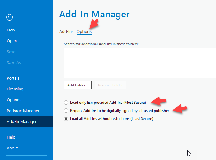

Cause 3
The addin you are attempting to load might not be digitally signed. ArcGIS Pro on your system could be configured to load only digitally signed add-ins. These settings are defined in ArcGIS Pro using the Add-In Manager. Add-In Manager can be accessed from Pro's backstage. Using the Add-In Manager you can configure ArcGIS Pro to load only digitally signed addins.
Solution
To check the settings defined in the Add-In Manager, launch ArcGIS Pro. From the start-up page access the backstage by clicking on "About ArcGIS Pro". Click on the "Add-In Manager" tab. Click on Options. You can see the different settings that can be used to control the loading of addins. Check to see if you have either one of the first two radio button options checked on.
Note: You can also perform some advanced configurations of ArcGIS Pro to control loading of Add-ins using registry keys.

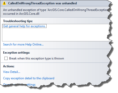

ArcGIS.Core.CalledOnWrongThreadException exception occurs
Issue
When you're debugging or using an add-in, you receive an ArcGIS.Core.CalledOnWrongThreadException error.
Cause
If an API method on a particular object in your add-in is called on the wrong thread, the call generates an ArcGIS.Core.CalledOnWrongThreadException exception. Refer to Tasks and the task asynchronous pattern topic in the ProConcepts: Framework.
Solution
The ArcGIS Pro framework provides a custom Task scheduler that should be used when dispatching Tasks that make calls to synchronous methods within ArcGIS Pro SDK. Add-in developers should call QueuedTask.Run.
Task t = QueuedTask.Run(()=>
// Call synchronous SDK methods here
The method in your add-in that is throwing this error is a synchronous method. Synchronous methods should be called on the worker thread only. Methods of this type are annotated within the API reference, and a code tip will appear when hovering over the method. The code tip will say "This method must be called on the MCT. Use QueuedTask.Run."

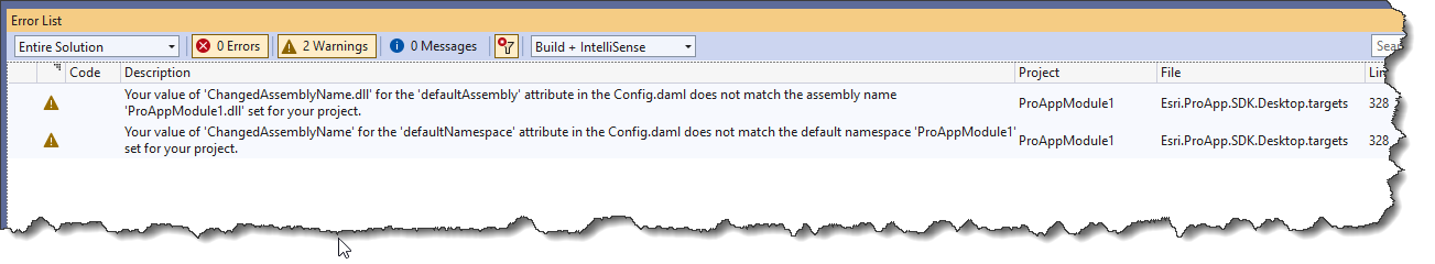

Assembly name mismatch causes Visual Studio to display a compile warning
Issue
When you compile an add-in project, you get a warning in Visual Studio that says "<AddInAssembly.dll> was not found. The value of the defaultAssembly attribute in the config.daml should match the name of the of the assembly for the add-in project."
Cause
The config.daml file in an ArcGIS Pro add-in specifies the name of the assembly using the defaultAssembly attribute. If the assembly does not exist in the add-in package (.esriAddInX file), a warning appears in Visual Studio when the add-in is compiled.
Solution

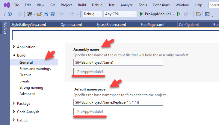

Find the defaultAssembly attribute value listed in your config.daml file. Access your add-in project's Properties page through its context menu. Confirm that the entry in the Assembly Name text box matches the defaultAssembly attribute value from the config.daml file.
<?xml version="1.0" encoding="utf-8"?>
<ArcGIS defaultAssembly="ChangedAssemblyName.dll" defaultNamespace="ChangedAssemblyName" xmlns="..." xmlns:xsi="..." xsi:schemaLocation="...">
<AddInInfo id="...
Notice that the defaultAssembly and defaultNamespace attribute values in the Config.daml do not match the corresponding assembly name and default namespace name shown below in the Visual Studio project properties in this example. So either the Config.daml or the Visual Studio values would need to be changed so that they match.

Find the defaultNamespace attribute value listed in your config.daml file.
<ArcGIS defaultAssembly="ProAppModule1.dll" defaultNamespace="ChangedAssemblyName" xmlns="..." xmlns:xsi="..." xsi:schemaLocation="...">
<AddInInfo id="...
Access your addin project's Properties page through its context menu. Make sure that the defaultNamespace attribute in the Config.daml matches the Default Namespace in the Visual Studio project properties. Notice that, in this case, the Config.daml defaultNamespace is set to ChangedAssemblyName whereas the Default Namespace for the project is set to ProAppModule1. Therefore, to fix this issue, either the value in the Config.daml or the value in the Visual Studio properties would need to be changed so that they match.
