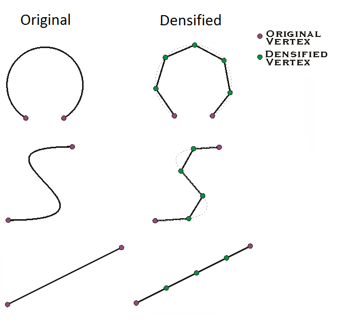

    Densifies the specified geometry.

    Returns the densified geometry. If the input geometry is empty, then it is returned unchanged.

    The densify operation adds vertices to the input geometry.
