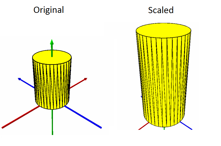

    Scales the geometry about the specified origin in a 3-dimensional manner.

    The geometry must be Z-Aware or else an exception will be thrown.
