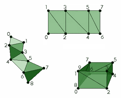

    A triangle strip is a continuous linked strip of 3-dimensional triangles such that every vertex after the first two completes a new triangle. A new triangle is always formed by connecting the new vertex with its two immediate predecessors. For example, a triangle strip with six points has triangles defined by the point indices (0, 1, 2), (2, 1, 3), (2, 3, 4), (4, 3, 5).
    Triangle Strip

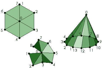

    A triangle fan is a continuous fan of 3-dimensional triangles such that the first point defines the origin. All triangles in the fan share the origin as a common pivot point. Every vertex after the first two completes a triangle, and a new triangle is formed by connecting the new vertex to its immediate predecessor and the origin. For example, a triangle fan with six points has triangles defined by point indices (0, 1, 2), (0, 2, 3), (0, 3, 4), (0, 4, 5).
    Triangle Fan

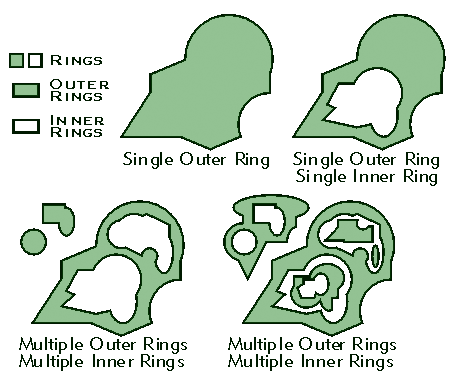

    A ring is a geometric element from which polygons are constructed, defined by an area bounded by one closed sequence of connected segments. If the type of a patch is PatchType.FirstRing, then it was the first ring created when constructing the polygon. If the type of the patch is PatchType.Ring, then it is part of the same polygon as the previous patch.
    Rings
