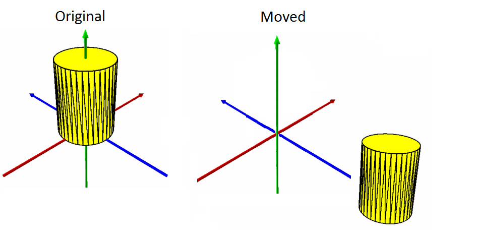

    Moves the geometry in a 3-dimensional manner.

    Moves the geometry along the X-axis, the Y-axis and the Z-axis. The geometry must be Z-Aware or an exception will be thrown. Only changes the position of the Geometry without altering any of the other characteristics. Move is a spatial offset.
