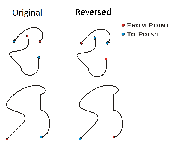

    ReverseOrientation changes the direction of the curve without changing the spatial position of the curve. The From Point and To Point of each Segment are interchanged.
    Caution should be taken in using ReverseOrientation on Polygons. Since ReverseOrientation changes the direction of each Ring within the Polygon, all Exterior Rings become Interior Rings and vice versa.
    GeometryEngine Reverse Orientation
