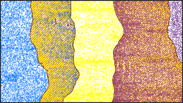

Illustration
Classify LAS Overlap tool illustration

  • Achieving a regular distribution of points often improves the performance of downstream tools. Data derived from points with irregular distribution may yield an undesirable margin of error. When aerial lidar surveys have LAS points from overlapping flight lines, the LAS data will usually have a higher density of points in the area of overlap. The scan angle of points from the different flight lines may also vary widely. Typically, points with larger scan angles will have a larger margin of error than points whose scan angles are closer to nadir. Classifying overlap points allows the LAS data to be filtered in a way that produces a consistent point density. The overlap designation allows the points to be filtered and excluded from visualization and downstream analysis operations.
  • The point source ID attribute of a LAS point identifies the flight line from which the point was collected. This attribute is used to establish the presence of overlap points. The LAS data is evaluated in a given sampling distance. When points with different point source IDs are found within the area being evaluated, the scan angle is used to establish which point source ID represents the nonoverlapping points. The point source ID of the point with the scan angle that is closest to 0, or nadir, will be retained as nonoverlap points. The points associated with the remaining point source IDs will be marked as overlap.
