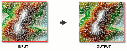

Illustration
DecimateTinNodes illustration
