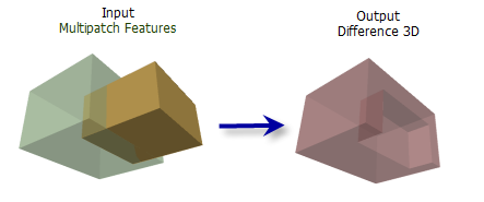

Eliminates portions of multipatch features in a target feature class that overlap with enclosed volumes of multipatch features in the subtraction feature class.
Illustration
Difference 3D tool illustration
