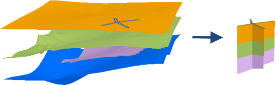

Illustration
Fence Diagram tool illustration
