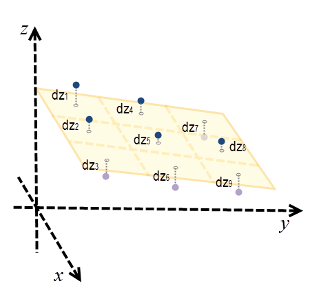

Least Squares Fitting example
Here, the plane is represented as z = Ax + By + C. For each cell center, dzi is the difference between the actual z-value and the fitted z-value.
The plane is best fitted when \({\Large \sum\limits _{i=1}^9}{{dz_i}^2}\) is minimized.

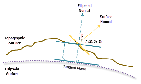

After the plane is fitted, a surface normal is calculated at the cell location. At the same location, an ellipsoid normal perpendicular to the tangent plane of the ellipsoid surface is also calculated.
Geodesic slope computation
The slope, in degrees, is calculated from the angle between the ellipsoid normal and the topographic surface normal, represented as \(β\) here. From the illustration above, the angle α is the geodesic slope, which is the same as angle \(β\), pursuant to the law of congruent geometry.
To calculate slope in percent rise, the following formula is used:
\(Slope_{PercentRise} = \arctan (β) * 100\)
