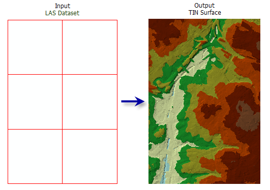

Exports a triangulated irregular network (TIN) from a LAS dataset.
Illustration
LAS Dataset to TIN
