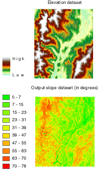

The Slope function is most frequently run on an elevation grid, as the following diagrams show. Steeper slopes are shaded red on the output slope map.
Elevation dataset and output slope dataset
