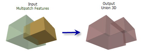

Merges closed, overlapping multipatch features from an input feature class.
Illustration
Union 3D tool illustration
Usage
  • Closed multipatch geometry is required for this analysis. The Is Closed 3D tool can be used to determine if a multipatch feature class contains closed features, and the Enclose Multipatch tool can be used to eliminate gaps in multipatch features.
  • This tool combines intersecting multipatch features encompassing overlapping volumes by keeping the outermost portions of the input features and removing the geometry that falls within the combined feature's interior. A separate table can be created to identify the source features that were merged together to create each combined output.
