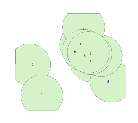

For example, two feature layers are shown below; the first contains 10 features, and the second contains a single feature.
Input 1
Input 1 contains 10 overlapping polygon features, labeled by Object ID.
Input 2
Input 2 contains 1 polygon feature, labeled by Object ID.

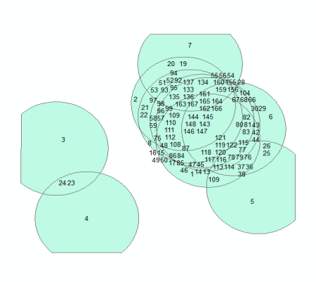

The image below shows the result of the Intersect tool with the two inputs. Intersections for all features are calculated, regardless of which input. This can result in many more features than found in the inputs. In this case, there are more features in the output (167) than there are in both inputs (11).
Intersect tool output
Intersect tool output is 167 output features, labeled by OID.
