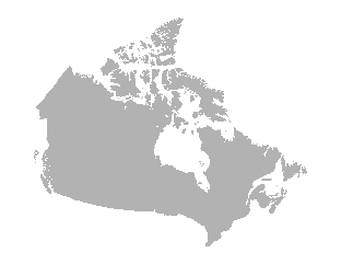

Extent of input datasets
Start with the footprint of all the input features.

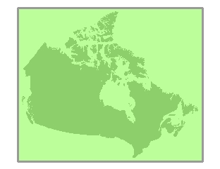

Geoprocessing tile level 1
The process begins with a tile that spans the entire extent of all datasets. For reference, this is called tile level 1.

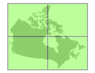

Geoprocessing tile level 2
If the data is too large to process in memory, the level 1 tile is subdivided into four equal tiles. These four subtiles are called level 2 tiles.

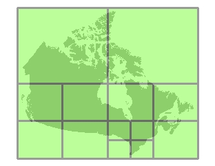

Geoprocessing tiles adaptive
Based on the size of the data in each tile, some tiles are further subdivided, while others are not.

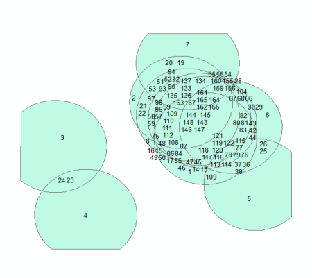

The image below shows the result of the Intersect tool with the two inputs. Intersections for all features are calculated, regardless of which input. This can result in many more features than found in the inputs. In this case, there are more features in the output (167) than there are in both inputs (11).
Intersect output
The Intersect tool output shows 167 output features labeled by OID.
