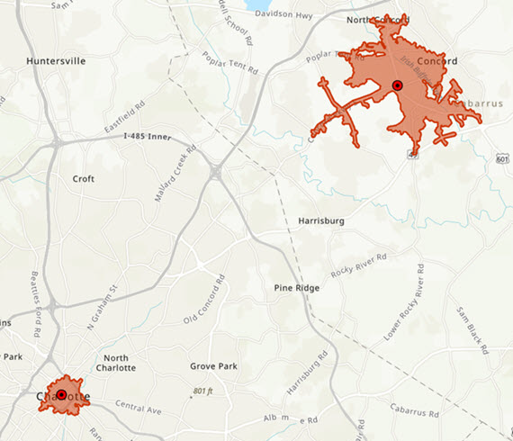

The following image shows the drive-time polygons that are generated around the two input community centers:
Drive-time polygons around two community centers
You can see that the two polygons are not the same size. The reason for this is that Uptown Charlotte (lower left polygon) has a greater population density, which means higher total households in smaller areas, as compared to the Charlotte suburbs. In terms of the algorithm, this means that the root-solving algorithm found different values of (t) for the two input community centers, where F(t) equals zero.

Radius and Radius Units—The Radius field has the time value where F(t) was close to zero. The drive-time trade area around the community center was created using this value. The Radius Units field shows the units of measurement for the trade area. Radius units are dependent on the Distance Type and Distance Units parameters used in the tool.
You can see how the Radius values are different for the two input community centers, while the areas still capture approximately 7,000 households. The community center in Uptown Charlotte will need household population to drive only 3.17 minutes to meet the threshold, while the community center in Concord (Charlotte suburb) requires household population to drive 6.3 minutes to meet the threshold.
