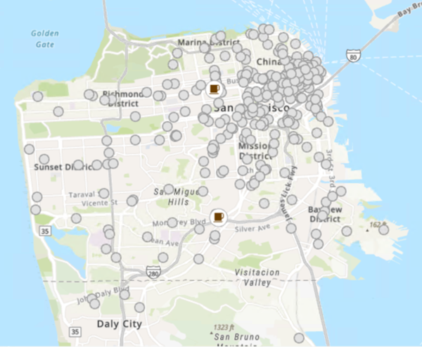

Consider an analysis in which a franchise owner is setting up two new coffee shops in downtown San Francisco, California. There are existing coffee shops in this market area. Using the Find Nearby Locations tool, the franchise owner can assess how far other coffee shops are from the new shops and estimate the sales volume the existing shops generate. The franchise owner is interested in the closest 25 locations within 3 miles of the new shops.
San Francisco coffee shops

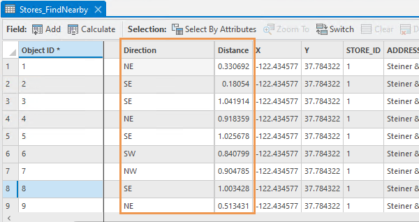

Write the results to the attribute table
In the output attribute table, examine two key output fields: Direction and Distance. The direction of the point is classified as NE, NW, SE, or SW. The distance value measures how far the location is from the input feature. The values of attributes in the distance field depend on the Distance Units parameter.
Results attribute table
