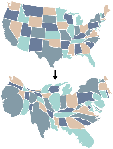

Illustration
Generate Contiguous Cartogram tool illustration
Shared boundaries are maintained while the size and shape of input polygons are distorted so that the area of each feature represents the value of an attribute field, which in this case represents the total population of each feature.
