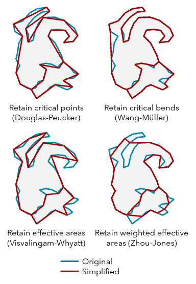

Illustration
Simplify Polygon tool illustration
Sample results from the simplification algorithms are shown here for comparison.

    • The Retain critical points (Douglas-Peucker) algorithm ("POINT_REMOVE" in Python) identifies and removes relatively redundant vertices to simplify data for display at smaller scales. It is the fastest of the simplification algorithm options in this tool. This option is often used for data compression or for coarse simplification. The angularity of the resulting polygon outlines increase significantly as the tolerance increases.
    • The Retain critical bends (Wang-Müller) algorithm ("BEND_SIMPLIFY" in Python") identifies and eliminates relatively insignificant bends to simplify data for display at smaller scales. It is typically more accurate regarding the input geometry than the Retain critical points (Douglas-Peucker) option but can take more time to process.
    • The Retain weighted effective areas (Zhou-Jones) algorithm ("WEIGHTED_AREA" in Python) identifies triangles of effective area for each vertex. The triangles are then weighted by a set of metrics to compare the flatness, skewness, and convexity of each area. The weighted areas guide the removal of their corresponding vertices to simplify the polygon outline while retaining as much character as possible.
    • The Retain effective areas (Visvalingam-Whyatt) algorithm ("EFFECTIVE_AREA" in Python) identifies triangles of effective area for each vertex to guide the removal of vertices to simplify the polygon outline while retaining as much character as possible.
