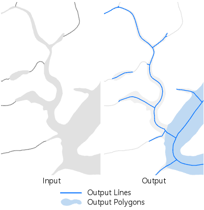

Collapses or partially collapses hydro polygons to a centerline based on a collapse width.
Illustration
Collapse Hydro Polygon tool illustration
