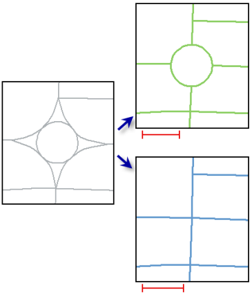

Collapses small, open configurations of road segments that interrupt the general trend of a road network, such as traffic circles, and replaces them with a simplified depiction.
Configurations are collapsed regardless of road class if the diameter across the open area is less than or equal to the Collapse Distance parameter value. All roads from the input collection that are not collapsed will be copied to the output feature class.

Illustration
