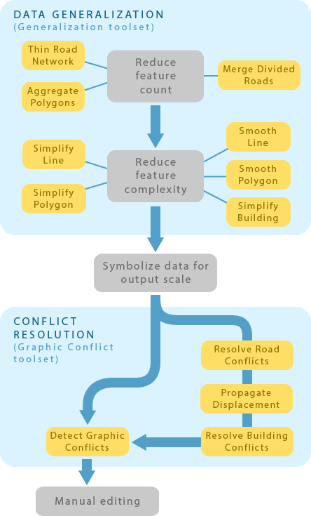

The process of making a map at a smaller scale than that for which the data was intended begins with an understanding of the target scale; the display specifications, including symbology; and the underlying purpose or intent of the map. Next, operations are performed to reduce the overall number of features without impacting the connectivity or character of the dataset. The complexity of individual features is then reduced by removing vertices or other feature details. This may also include simplifying complexity within the feature attributes by combining similar subcategories of features for display with the same symbol. Once map authoring begins and the data is displayed with its final symbology at the final scale, graphical conflicts can be detected and resolved.
The following flowchart shows a simplified version of a generalization workflow and identifies some key tools from the Cartography toolbox that can assist in generalizing data for display at a smaller scale.
Diagram of the generalization workflow
A simplified view is shown of the processes and corresponding geoprocessing tools used to generalize data for cartographic display.
It is important to understand that most geoprocessing tools typically generate new data as an output that can then be used as input for subsequent tools. In contrast to this, cartographers typically follow a workflow that is characterized by incremental improvement of feature layers that are already established in a map document. Symbology, layer properties, and masking relationships are already defined, so it follows that it is preferable to modify input layers as conflict resolution and generalization operations are performed so as not to lose this information. For this reason, some of the tools in the Cartography toolbox modify input data in symbolized layers rather than creating data.

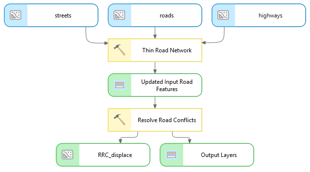

Generalization tools make use of multivalue inputs—that is, a list of one or more feature classes. Many geoprocessing tools accept multiple values (such as the Union tool), but generalization tools are different in that they also output multivalues. This requires that you be aware of a few ModelBuilder techniques to produce the model you want. These techniques are discussed below.
Chaining tools with multiple inputs and outputs
The Thin Road Network, Resolve Road Conflicts, and Resolve Building Conflicts tools output multivalues. This means that only tools that accept multivalue inputs can use the output of these tools directly. For example, if three layers are used as inputs to the Thin Road Network tool, and you want to use these same three layers as inputs into the Resolve Road Conflict tool after they have been thinned, you can chain the output of the Thin Road Network tool directly to the Resolve Road Conflicts tool.
Model containing multiple inputs for generalization
Multiple inputs are chained through the Thin Road Network tool to the Resolve Road Conflicts tool.

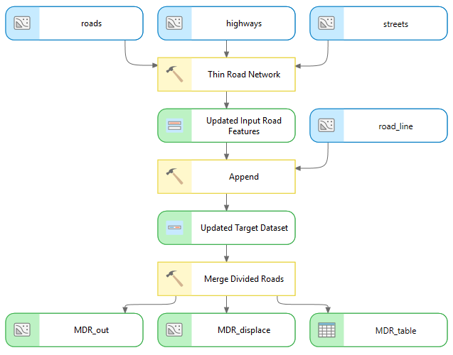

Chaining multiple outputs to a single input
To chain tools that have a multivalue output to a tool that accepts a single input, use the Append tool to merge multiple feature classes. An example of this workflow is appending multiple road input layers that were processed by the Thin Road Network tool to use as an input to the Merge Divided Roads tool, which accepts only a single input.
Model using the Append tool
This model uses the Append tool to combine multiple outputs into a single input.

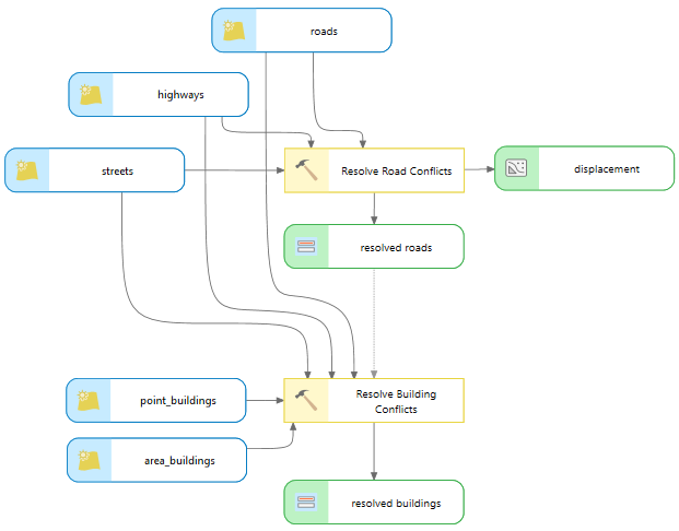

In some cases, you want to pass multiple outputs from a tool individually to another tool. This would be the case if you didn't want all the outputs from the first tool to participate in the second tool, or if you wanted to set specific parameters for each input in the second tool. For example, the Resolve Building Conflicts tool allows full control over the way each input layer is defined as a barrier. In these cases, use the same set of layers as inputs to both tools, but set the output of the first tool as a precondition to the second tool to enforce the correct order of processing, as illustrated below. This approach is only applicable when the first tool, like the Resolve Road Conflicts tool, modifies input layers instead of creating new output layers.
Learn more about using preconditions in ModelBuilder
In the example below, the three transportation layers are used as inputs to both tools. This is possible because these layers are modified by the Resolve Road Conflicts tool; new output feature classes are not created. The output of the Resolve Road Conflicts tool is used as a precondition to the processing of the Resolve Building Conflicts tool to ensure that the Resolve Road Conflicts tool completes processing before the Resolve Building Conflicts tool begins.
Model that uses a precondition
The output of the Resolve Road Conflicts tool is set as a precondition to the Resolve Building Conflicts tool to enforce processing order.

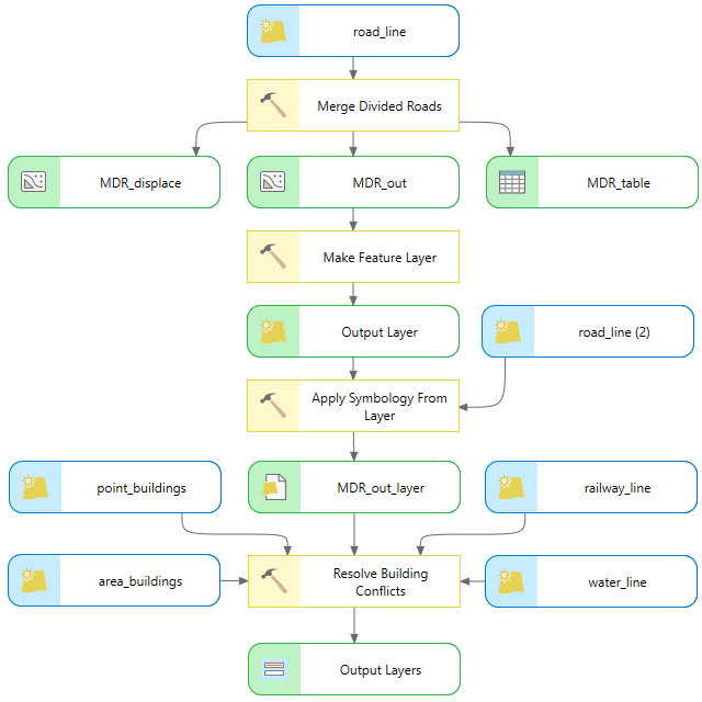

Symbolized inputs
To chain tools that only accept symbolized layers, you will need to use the Make Feature Layer tool and the Apply Symbology From Layer tool to prepare an output layer for chaining purposes in ModelBuilder as well as in scripting environments.
Model with a symbolized layer as an input
The model uses the Make Feature Layer tool and the Apply Symbology From Layer tool to pass symbol information between tools.
