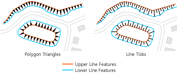

Illustration
Generate Hachures For Defined Slopes tool examples
Two examples of slope hachures are shown. The first shows uniform polygon triangles. The second show alternating tick lines.
