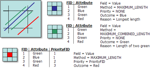

Examples using different options for the cell assignment type
The image below shows examples for the cell assignment type.
Examples of different options.
