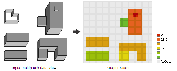

Illustration
Multipatch to Raster tool illustration

  • The output raster stores the z-values of the input multipatch features at each cell center location. To determine the z-value for each cell, a vertical line is extended from the cell center location to intersect the input multipatch features. The maximum or minimum z-value from the points of intersection is assigned to the output raster. An output cell will receive a value if the cell center falls within the footprint of one or more input multipatch features; otherwise, it will be assigned NoData.
  • Vertical triangles—essentially vertical walls without a roof—are excluded from the rasterization and will not be represented in the output raster.
