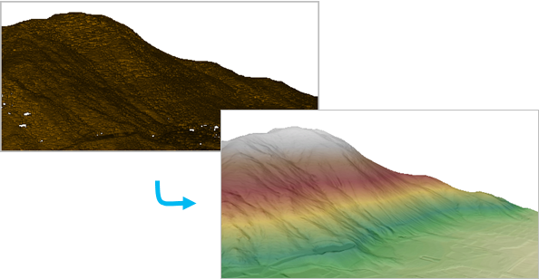

Creates a raster surface from height values in a point cloud scene layer package (*.slpk file) or Indexed 3D Scene (I3S) service.
Illustration
Usage
This tool derives a raster surface by estimating cell values through binning in which the point cloud is divided into rectangular areas that match the output cell size. The raster values are assigned based on the options specified for the Cell Assignment Type and Void Fill Method parameters. The Cell Assignment Type parameter controls how the values for cells that contain points are defined, and the Void Fill Method parameter controls how the values for cells that do not contain points are determined.
