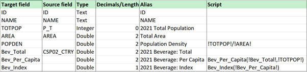

    The following is an example of a definition table:
    Example of a definition table
    If the Output Schema Definition Table parameter value includes the following field names, as in the example above, the corresponding parameter values will be populated automatically:
    • Target field
    • Source field
    • Type
    • Decimals/Length
    • Alias
    • Script
    Note:
    Script or Source field must be populated.
  • The tool calculates new fields using existing fields by providing a script field in the definition table.
    An example value in the Script field of the definition table is !TOTPOP!/!AREA!, which calculates the Population Density field. Field names must be enclosed in exclamation points.
  • If the input table contains a join, you can create a script in the output schema definition table to use in calculating new fields. It will include the calculated field in the output table, but the joined table's fields will be excluded.
    Joined table
  • The tool can create additional fields that are dependent on other field calculations. For example, the Bev_Index field is calculated using the Bev_Per_Capita field, which is also calculated when the tool is run.
  • Use the Script File parameter for multiline Python calculations. To use a script file, create a file with Python functions, and reference the functions in the definition table.
    The following is an example of script code for a target field named Bev_Per_Capita:
    • A field named Script in the Output Schema Definition Table parameter value with a value of Bev_Per_Capita(!Bev_Total!, !TOTPOP!)
    • A Script File parameter value with the following function:
      def Bev_Per_Capita(Bev_Total, TOTPOP):
          return Bev_Total / TOTPOP

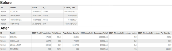

    The following is an example showing the attribute table before and after running the tool:
    Batch Update Fields tool example
