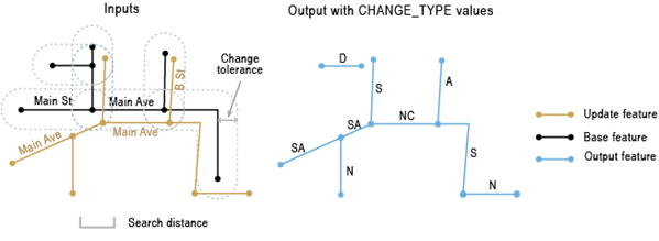

Illustration
Detect Feature Changes tool example

    • CHANGE_TYPE—The type of change detected, with values as follows:
      • S—A matched update feature with a spatial change.
      • A—Aa matched update feature with an attribute change.
      • SA—A matched update feature with both spatial and attribute changes.
      • S_LD—A spatial change as well as opposite line directions.
      • SA_LD—Spatial and attribute changes as well as opposite line directions.
      • NC—A matched update feature with no change.
      • N—An unmatched update feature that is new to the base data.
      • D—An unmatched base feature that may need to be deleted from the base data.
