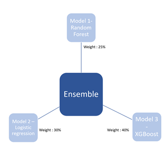

Create an ensemble
An ensemble is a collection of models whose predictions are combined by weighted averaging or voting.
Model ensemble
The most common strategies for creating an ensemble are bagging (Random Forest is an example of bagging) and boosting (XGBoost is an example of boosting), which combine the outputs from the models belonging to the same algorithms. Recent techniques, such as those mentioned in Ensemble Selection from Libraries of Models (Caruana et. al 2004) combine diverse models.

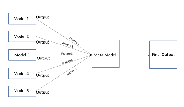

Model stacking involves combining the results of multiple models and deriving the result from it.
Model stacking
While ensemble approaches combine the results of various models by applying different weights to the outputs, stacking uses the outputs of each base model as features and adds them to a higher-level model: a meta model. The output from the higher-level meta model is used as the final output.
To improve performance, you can create model stacks and combine their outputs to form an ensemble stack.

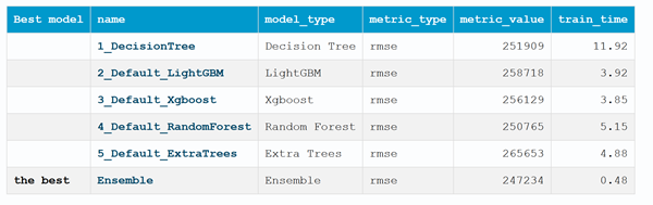

The main page of the report shows the leaderboard. The same information is also available in the tool output window.
Report leaderboard
The leaderboard shows the evaluated models and their metric value. For the regression problem, the model with the least RMSE is considered the best model (in this case, the ensemble model). It will be different (for example, logloss) for classification problems.

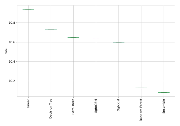

The AutoML performance box plot below compares the evaluation metric of different models with an evaluation metric (RMSE) on the y-axis and models on the x-axis, as shown below. The box plot shows that the best model is the ensemble model that has the lowest RMSE.
AutoML performance of all models

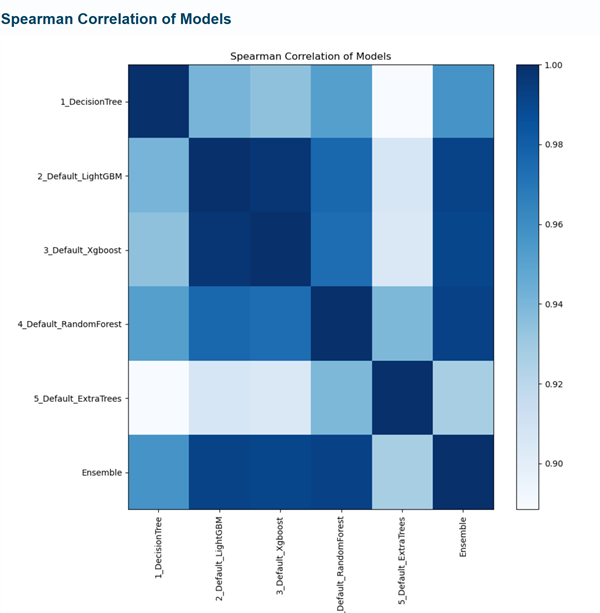

The Spearman correlation shown below is generated for all the models that were evaluated, and the models that are more closely related are shown in darker shades of blue. For example, the outputs from LightGBM and XGBoost are the most closely related (this is expected, as both are boosting algorithms). The output from LightGBM resembles the output from Random Forest compared to the output from Extra Trees.
Spearman correlation of models

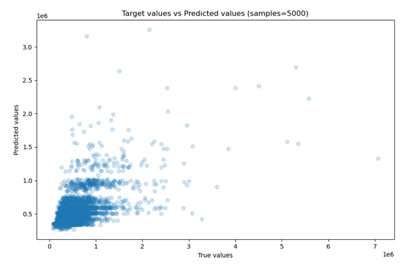

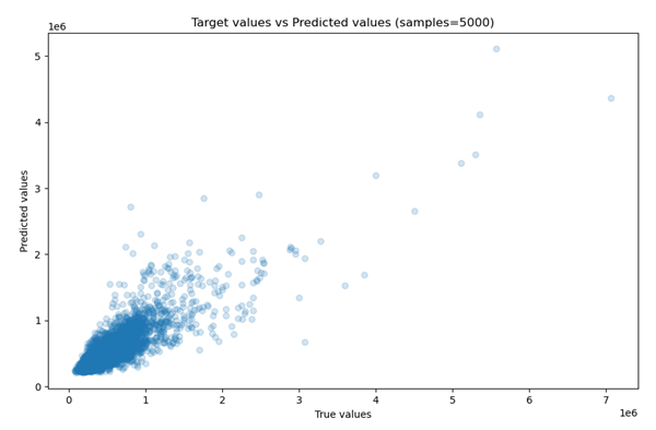

The scatter plot of actual and predicted outputs (for a sample of 5,000 data points) is also shown.
True versus predicted scatter plot: model1
True versus predicted scatter plot: model2
You can use this chart to determine the performance of the model. The figures above show the comparison of the scatter plots of two models obtained from the report. The second model is performing better than the first, where the predicted and true values diverge more.

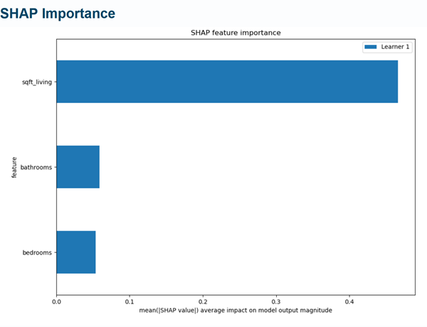

To make models more explainable, the importance of each variable in the final model is also included in the report (similar to feature importance in sklearn). Unlike sklearn, this plot can be generated for nontree models of sklearn as well. This capability of model explanation for models that are not tree based is offered by SHapley Additive exPlanations (SHAP).
SHAP is a game theoretic approach to explain the output of any machine learning model. It connects optimal credit allocation with local explanations using the classic Shapley values from game theory and their related extensions. Details about SHAP and its implementation are available in the SHAP GitHub folder. SHAP output is available only with the Basic option.
In the chart below, you can visualize the global impact of each variable in the housing dataset on the trained model. This demonstrates that the sqft_living feature influences the model the most and is the most important feature, followed by number of bathrooms and bedrooms while predicting the house prices.
SHAP feature importance chart

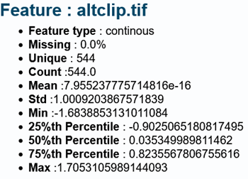

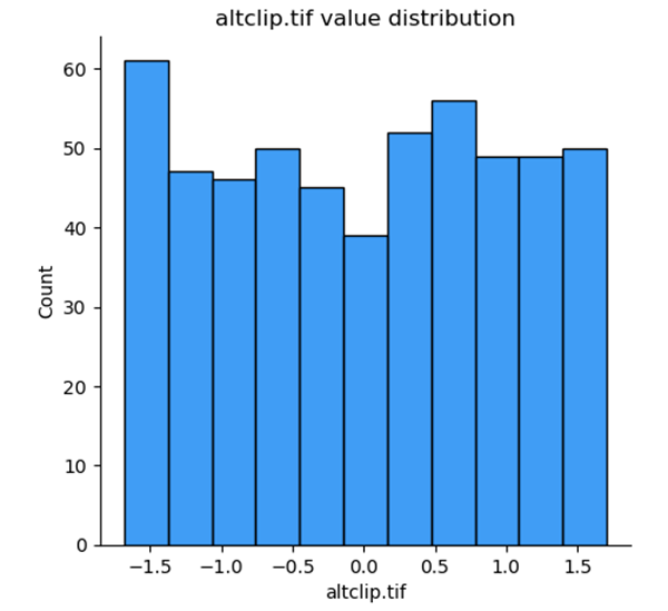

With the Basic option, you also have the option to see the automatic exploratory data analysis report (EDA report), which prints summary statistics for the target variable and the predictors used in model training. The following is a sample EDA report for a variable named altclip.tif:
Summary statistics for a sample variable
Distribution of the variable
